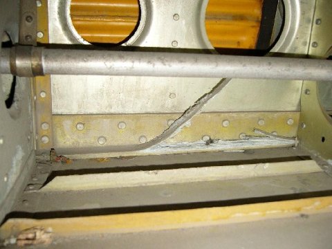

Here is a picture of what Jeff Boulware sent me of the damage he found in his aircraft.
Again this damage on this particular aircraft is located in the bay just out board of the landing light. The corrosion is on the lower spar cap. The yellow object behind the lighting holes in the spar web, is the left main fuel tank. The tube in the picture carries wring going to the wing tip and flux gate compass. Because of this and other damage (see below) he replaced the wing.

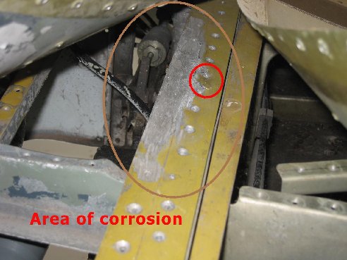

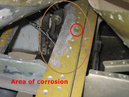

Below is the corrosion located on the lower spar cap in the center section of Sean Carroll's aircraft.

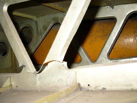

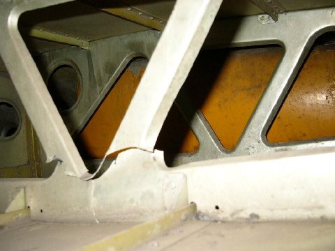

This next picture is again from Jay Boulware's aircraft. Though not related to the corrosion, it does show what other damage could be found during a really good inspection.

The pictures are telling. The last one shows corrosion that would not be detected unless the skin is peeled back. I know many are lulled into the belief that corrosion cannot be a problem on these planes as they are built mostly of anodized aluminum. It may be time to start thinking about very detailed inspections and application of Corrosion-X in the wings.
