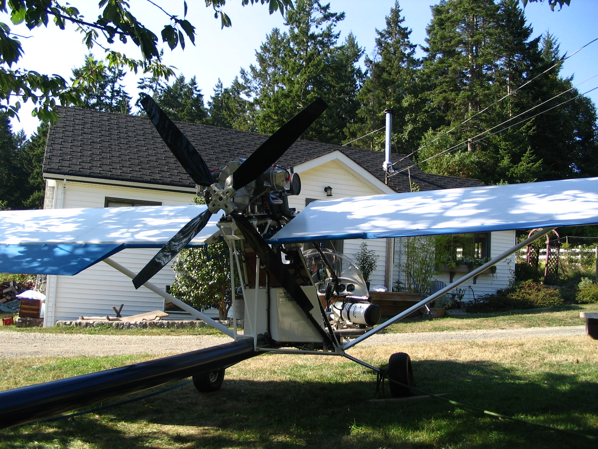

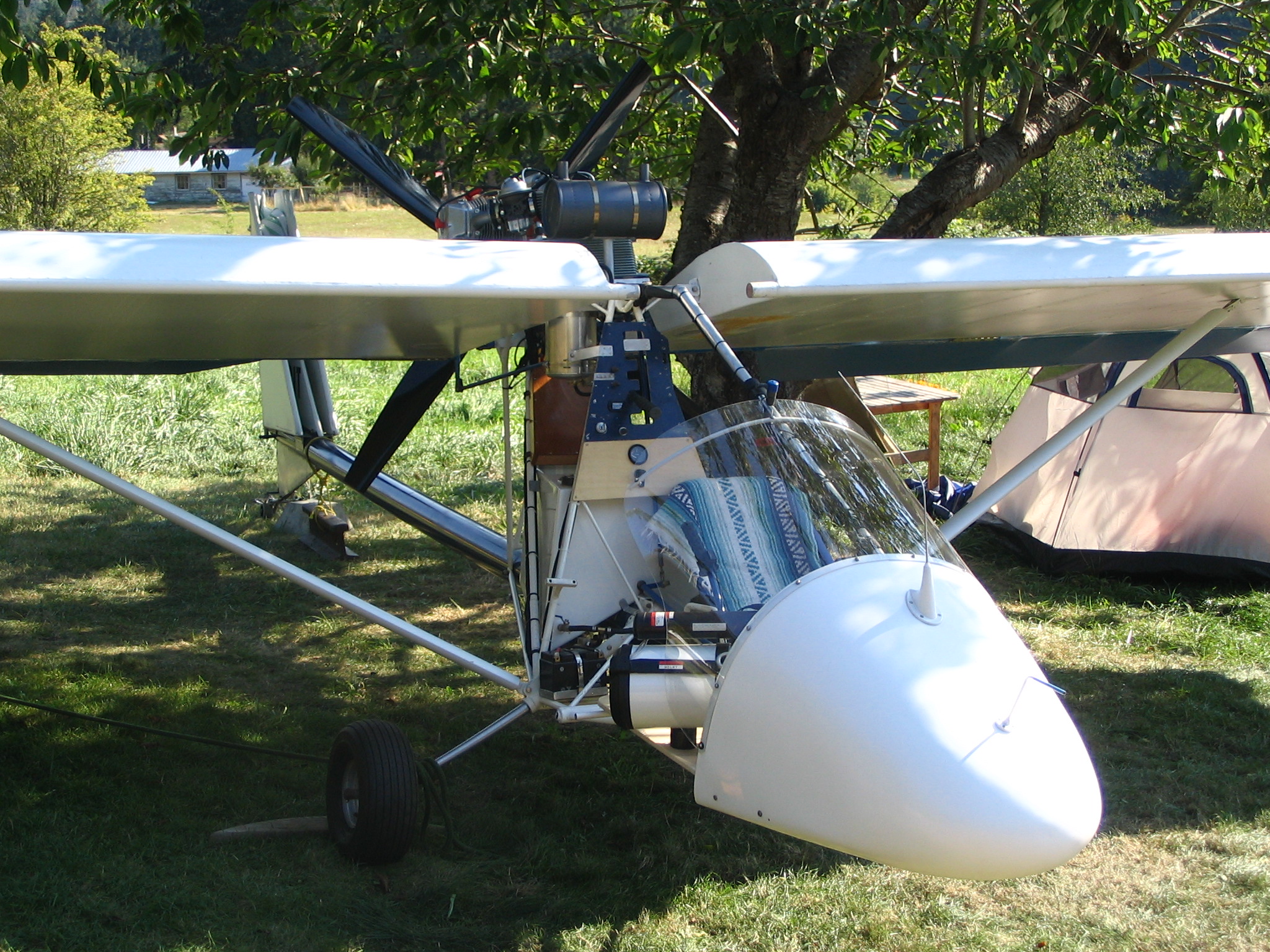

Rats ! I just wrote a long response(very slow typer) and added a couple pics. I went to preview it, and when I pressed the back arrow it was gone. grrrrrrr. I fly in coastal British Coumbia ( read BIG TREES everywhere), so I feel I need a four stroke. I like the 503, and if I flew somewhere more forgiving I would be happy with it. There are really no airframe mods to be done, you just make an aluminum adapter plate.
There are alot of decisions to be made along the way( you dont just bolt it on) (C of G, thrust line, gearbox, electical location, etc.) If you're a mechanically inclined (as opposed to "mechanically declined") idividual it is not that hard.
The finished package (fairing, instruments, brs, custom 12 gal tank, alum leading edge wrap wing, etc.) weighs 465 lbs. The gross is 750. Twinstars in the past have been flown waayyy over gross. A guy named Rick Trader flew a twinstar to Alaska and back loaded between 1000 and 1110 lbs !!! I will fly my plane for a year or so, before I even consider taking a passenger. At that point I will load it up heavy, and go high, with a couple chutes, and beat it up a bit. If it survives that I MIGHT take a light passenger on a still air evening. Wink cheers, Rob
