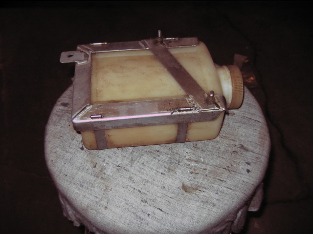

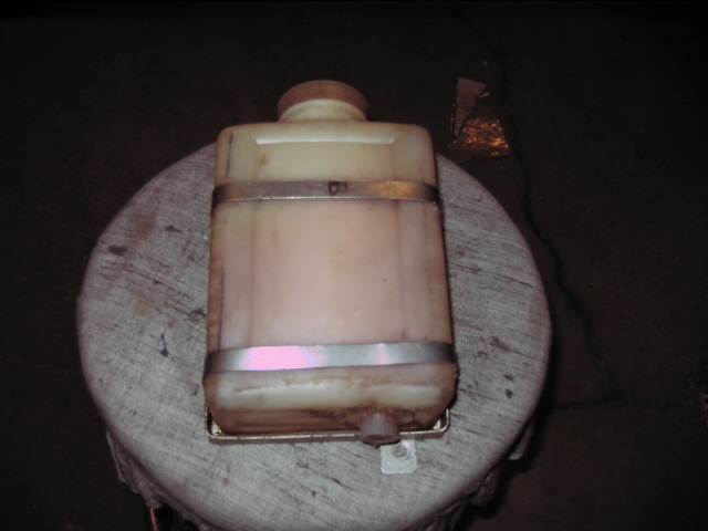

PostPosted: Sat Sep 27, 2008 6:08 pm    Post subject: 582 Oil Reservoir Reply with quote
I used to have a Kitfox 3 project with 582 that I never did fix up like I thought I would.  It had a plastic oil bottle that
 held probably 3 quarts.  I ended up with two of those bottles and let only one go with the plane when I sold it.
 I just ran out to the garage and measured it and it is 7 3/4" X 5 3/4" X 2 3/4"  I snapped a few pics also.  It looks kind
 of dirty in the photo.  I think it was the standard Kitfox 3 tank.  Let me know if you are interested in it.
Jim Chuk Kitfox 4 building Mn

Jim & Lucy C I'll take the bottle. Send it to Pat Reilly C 6910 Woodcrest Pkwy C Rockford C IL 61109. Tell me how much I owe you and your address. I'll send you a check. If I could have figured out your e-mail address I'd havecontacted you off line.

I have a 1992 KITFOX 2 C CI all so have the same tank in my KF as this
one.works great..Steve Shinabery N554KF KF2 C CHome to the 2009 Great

Guy C Thanks for the advice. I will use the lighter plastic bottle. I can't envision taking a trip that would use that much oil and I don't mind carrying a qt or so to add. That said C converting from 912 to 582 C if I run into a weight and balance problem of too light in the nose the additional oil capacity might be the answer C but I hope not.
