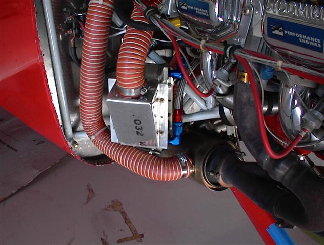

I added a second oil cooler on the right side which seems to have almost
solved my hot oil problems. It is a 6 row cooler but there is room for a
larger one.
