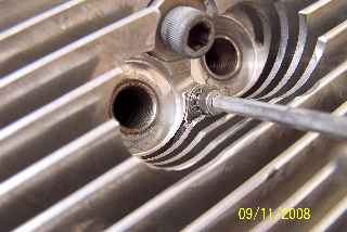

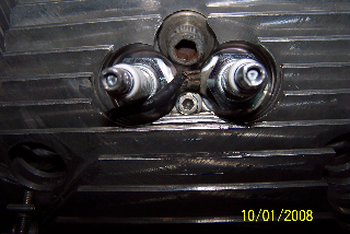

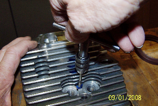

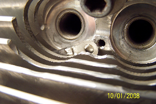

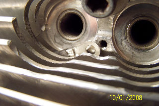

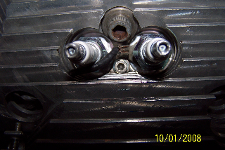

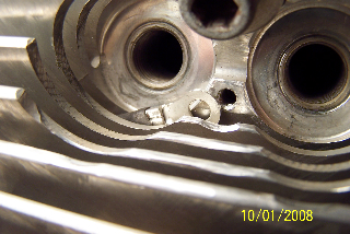

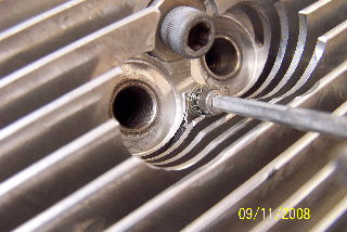

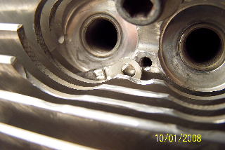

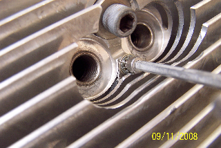

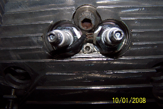

Here are some pictures for those interested in pursuing an alternate
location for the CHT probes.
tapping the hole
thermocouple prepared and ready to install
keeping the thermocouple clear of the spark plug socket
I ran some tests with two thermocouples in place...one in new
location, and the other under the spark plug....at one point 96° F
hotter at the "against-the-head" location, as opposed to having the
t'couple up in the airstream. You can't tell how high it sticks up
here, but it does.
