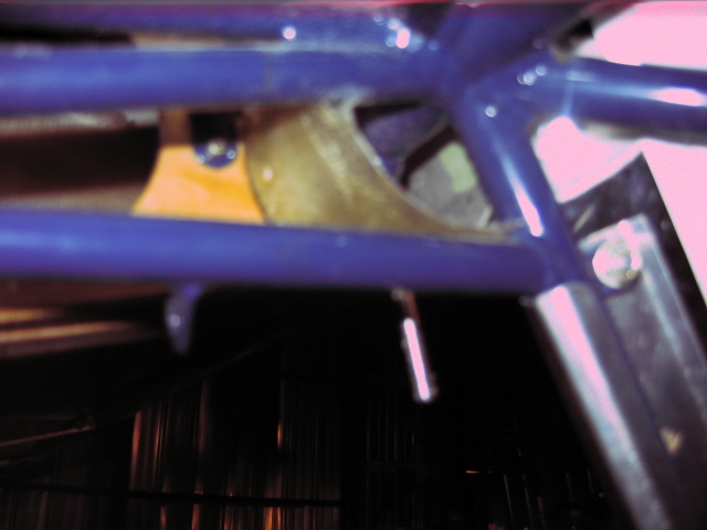

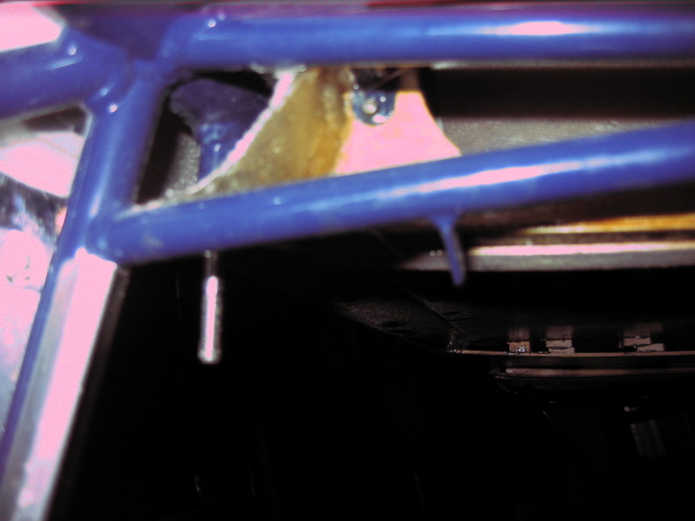

The wings are on the plane right now so it's hard to see the parts real well but here are some pics from the inside.
 I just have a hard time bringing myself to drill holes in the tubing and that is one reason why I made them out
 of fiberglass.  Jim Chuk  Kitfox 4 building   Avid Mk IV flying   Mn

.ExternalClass .EC_hmmessage P{padding:0px;}.ExternalClass body.EC_hmmessage{font-size:10pt;font-family:Tahoma;} On my Kitfox 4 project C I fiberglassed the parts rather than using the aluminum.  I took a piece of 3' PVC pipe and cut it in half lengthwise fit it and wedged it into place and used it for a mold at the four places.  The fiberglass doesn't stick well to the plastic and will peal off when it sets up.  I'll try to get a picture today and post it this evening.  Jim Chuk   Kitfox 4 building   Mn

[quote='michaega(at)verizon.net']My 1994 fabric manual shows bending a couple very small aluminum plates at each end of the butt rib and place fabric around them and the butt rib. Has any one come up with something different. A couple pictures would be great since I'm stuck in the imagination department.
George
George C here's a link to pictures of what I ended up with
http://www.sportflight.com/cgi-bin/uploader.pl?action=view&epoch=1010085697
I couldn't understand the manual instructions so just epoxied flat (not bent or curved) aluminum plates to the butt ribs so that the fabric could be attached to that so it seals up the cabin.
What I just wrote sounds almost as confusing as the manual.
These pictures are probably worth only a hundred words not a thousand like the saying goes. The only way to really figure out what to do here is if you can find a finished Kitfox to look at.
Tom Jones
