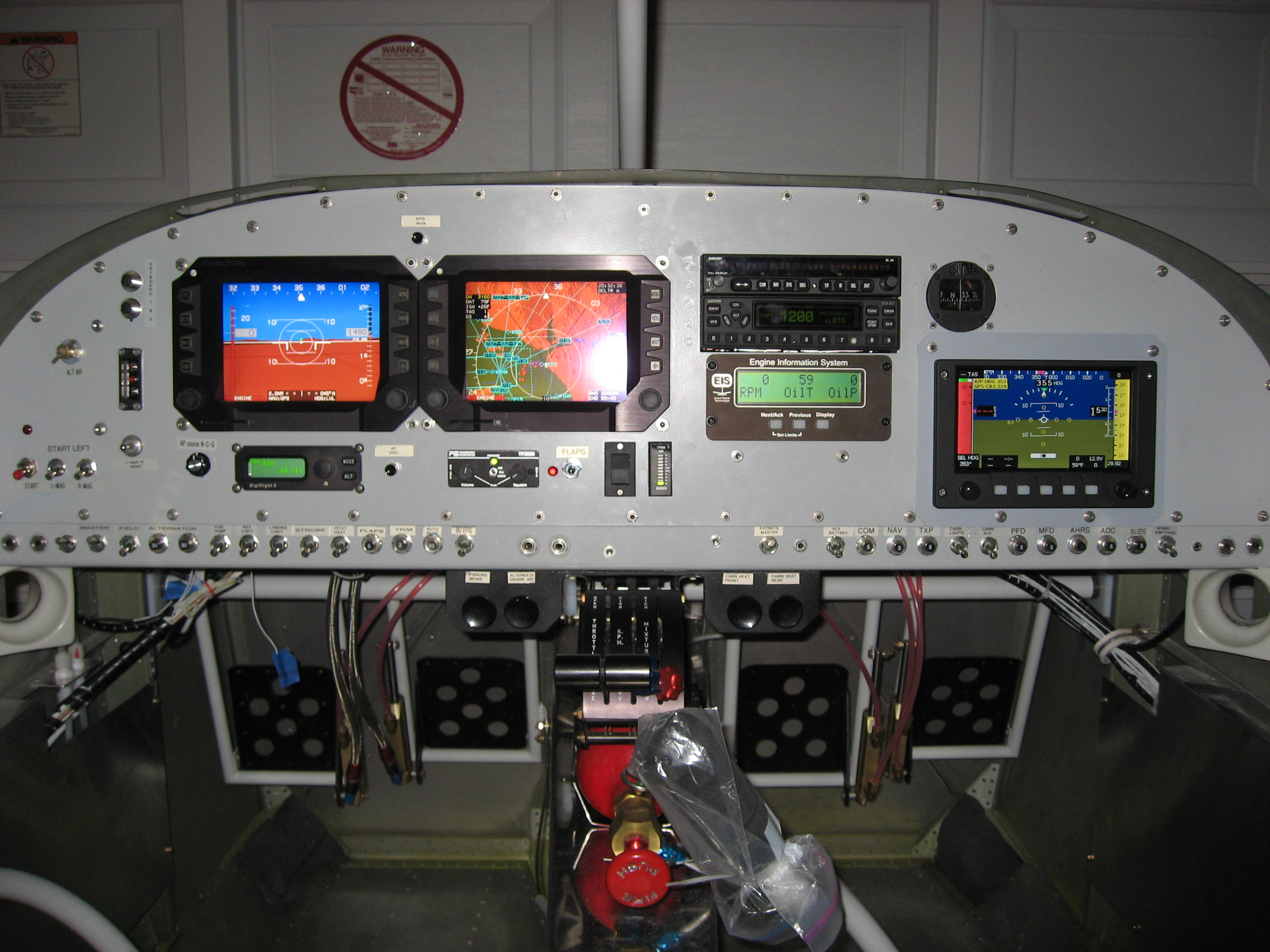

I can't locate where in the plans it tells one how to run cables for the cabin heat. I see under Section 27 to bolt the Vents but other than the AN3-3A setup there is nothing for the brackets nor cables or anything else.
Any feedback on this is appreciated!
Pascal

The firewall forward runs are in FF1-3. the inside runs are user choice. Mine are two knobs on the right side of the throttle quadrant. see picture

Note - do not do a permanent install till your panel is all ready to install as the heater cables have to be removed and run thru the hole in the bracket or panel.
