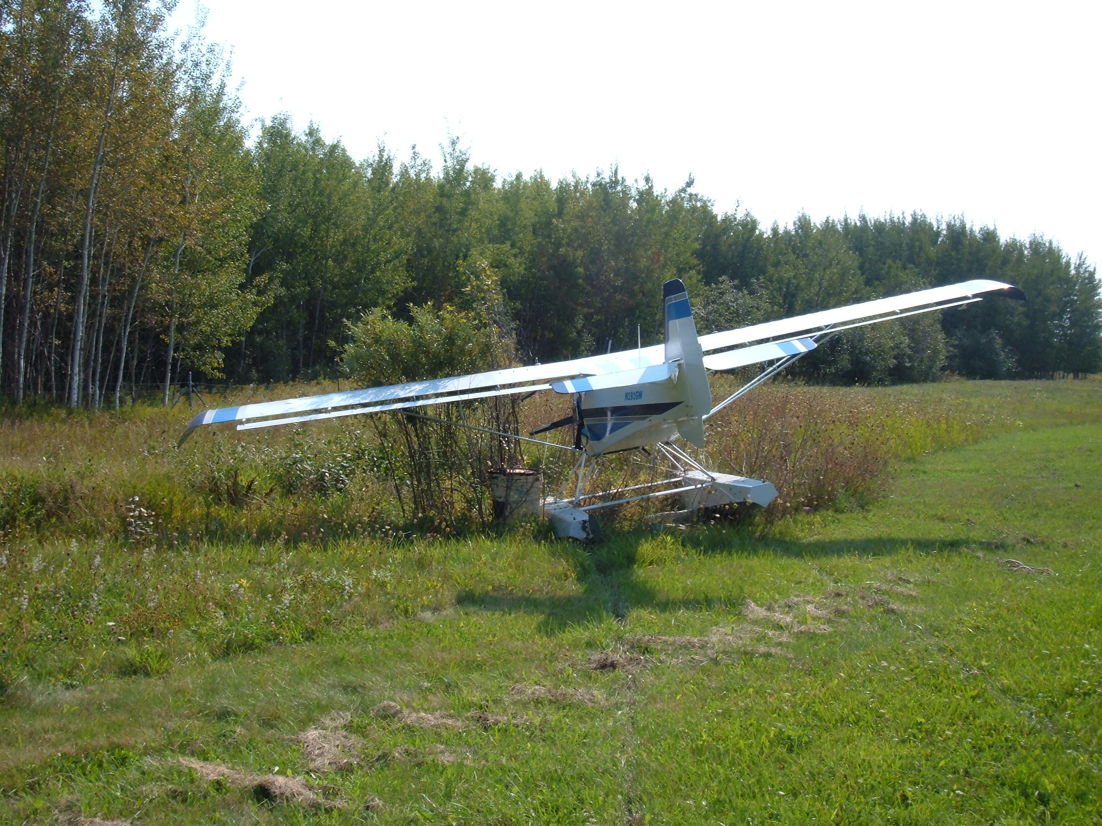

I'm not sure of this but I think the Kitfox levels by a straightedge under the second or third rib from the fuse. It may also be levelled by the bottom of the plane just aft of the firewall. I also think 3 deg of incidence from the top of the floats is considered optimal. Dave Fisher would know for sure.

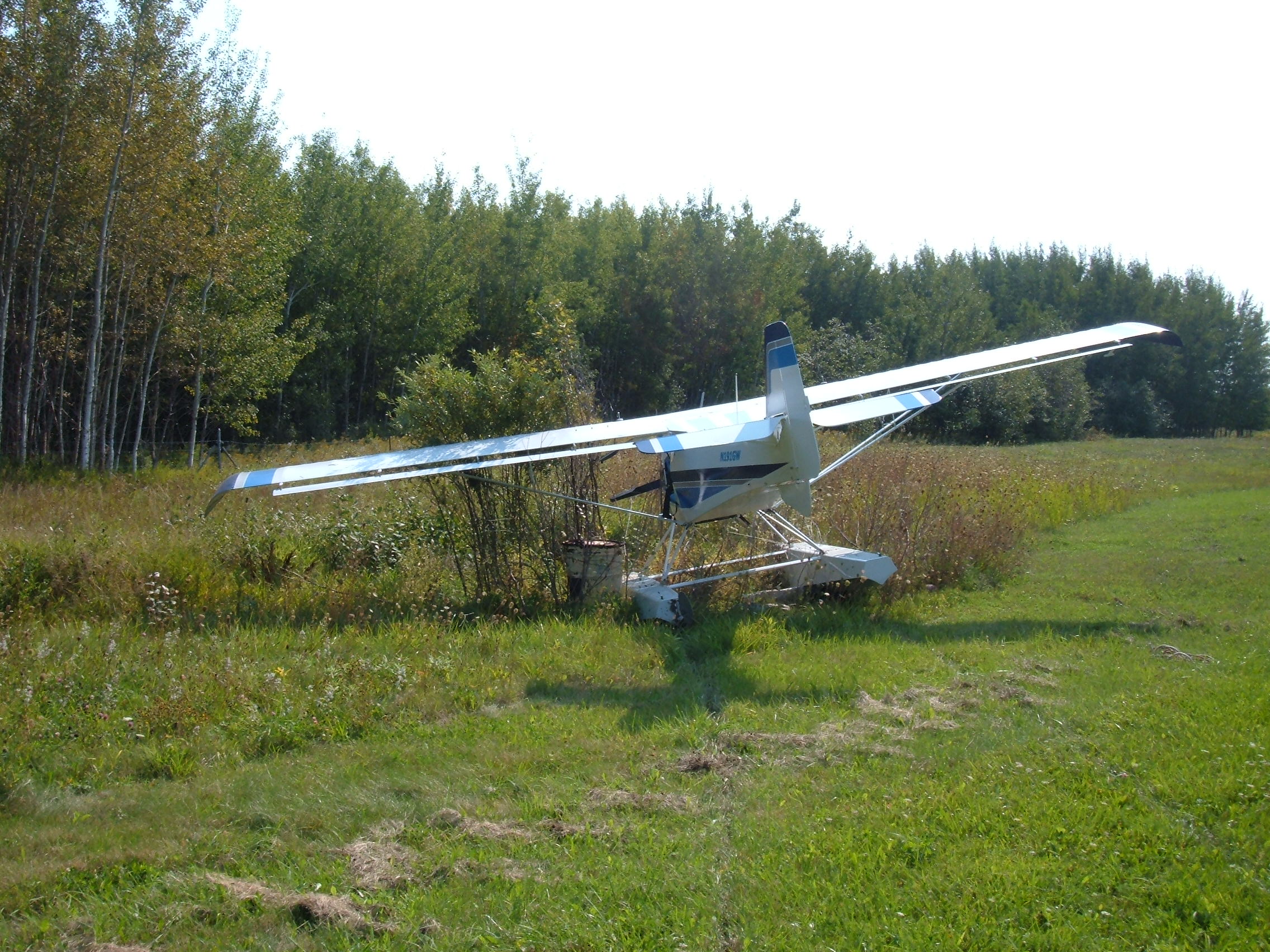

I added the length to the front struts, and took it out to the lake for a test. It is a lot better, but I think that it could also use a few pounds in the tail to raise the tips of the floats a little higher.
It was good enough that we did an hour or so of take-offs and landings with no problems.
THEN IT WAS TIME TO HEAD BACK TO THE AIRPORT.
As I touched down on the runway, the thing started to veer off to the left and I couldn't do anything about it. The plane slide on the grass and finally stopped in some bushes.
We used a tractor to get it back to the hanger, and found that the left main gear mechanism had popped out of the bearing mounted on the wheel well wall (I know, I didn't think that it could happen either) and the left float came into contact with the grass, causing drag.
There is very little damage, nothing that can't be straightened with a small hammer, but I'm pretty fed up with this amphib thing.
I seriously considering removing the amphib mechanism, glassing up the wheel well holes, and turning them into straight floats.

as with anything, when you start getting more complex you have more things that can go wrong. I would say dont give up so easy. I have been doinking with the floats for 2 yrs on my brothers plane trying to find the "perfect" setting, not just one that works ok.
Hang in there, and really give the rigging and all mechanical parts a good going over to make sure every part of the system is within tolerance.

Comment... Sure, no sweat!
You're almost there, why quit now. The main axels and actuators are
something that you have to keep up on... See if there is a way you can
reinforce the bearing cap so it can't slip out again.
Be careful how much weight you put in the tail... it shouldn't take much.
On the outside chance you do remove the landing gear, try to make it
reversible and you might find you won't need the aft ballast.
Noel
Noel Loveys
Kitfox III-A
Aerocet 1100 Floats
dholly
Joined: 19 Dec 2006
Posts: 40
Location: Upstate NY
PostPosted: Tue Sep 23, 2008 4:47 pm    Post subject: Re: aerocet amphibs Reply with quote
vetdrem wrote:
We used a tractor to get it back to the hanger, and found that the left main gear mechanism had popped out of the bearing mounted on the wheel well wall (I know, I didn't think that it could happen either)...
Louie - Do you feel this particular failure is a result of a rough turf strip landing or an unrelated mechanical failure? Referencing part #'s from the "1100 Series Floats Group Assembly Part Numbers #1102 Amphibious Floats" .pdf document, exactly which parts failed? I'd like to check mine for unusual signs.. Oh, and I would also be curious what S/N's your floats are? Keep the faith, Doug
-Kitfox III 582 Blue/C Grove Spring / Aerocet 1100 Amphibs
-Airdale Avid+ (project) TD / W.I.B. Gear
