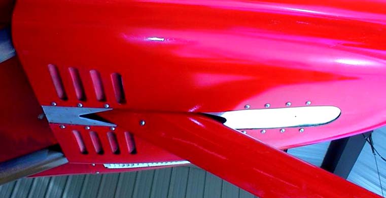

Albert Gardner
Posts: 455
Location: Yuma, AZ
PostPosted: Mon Sep 22, 2008 1:39 pm    Post subject: Nose Gear Intersecting Fairing Reply with quote
This is the area that an intersection fairing would have to cover and allow
for gear movement. For what it's worth, in order to get my lower cowl off
with a 3 blade prop I find it easiest to pull the tail down letting the nose
gear drop and providing additional clearance for the cowl.
Albert Gardner
Yuma, AZ
