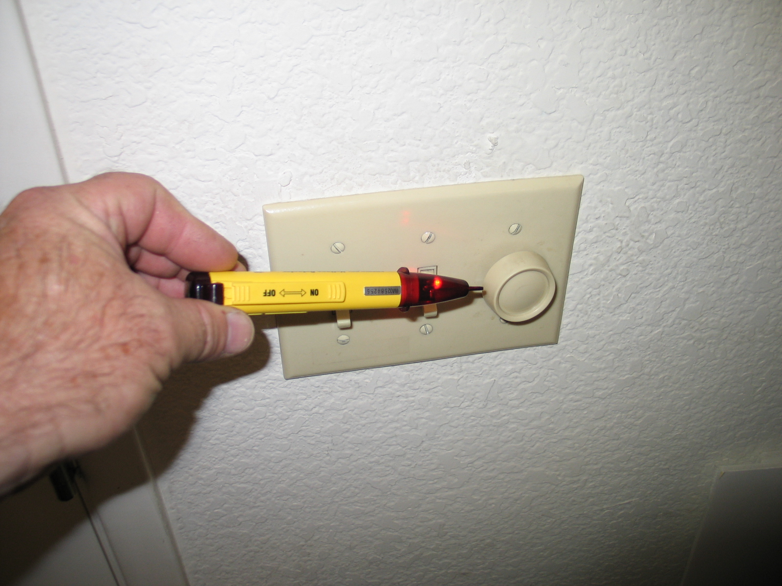

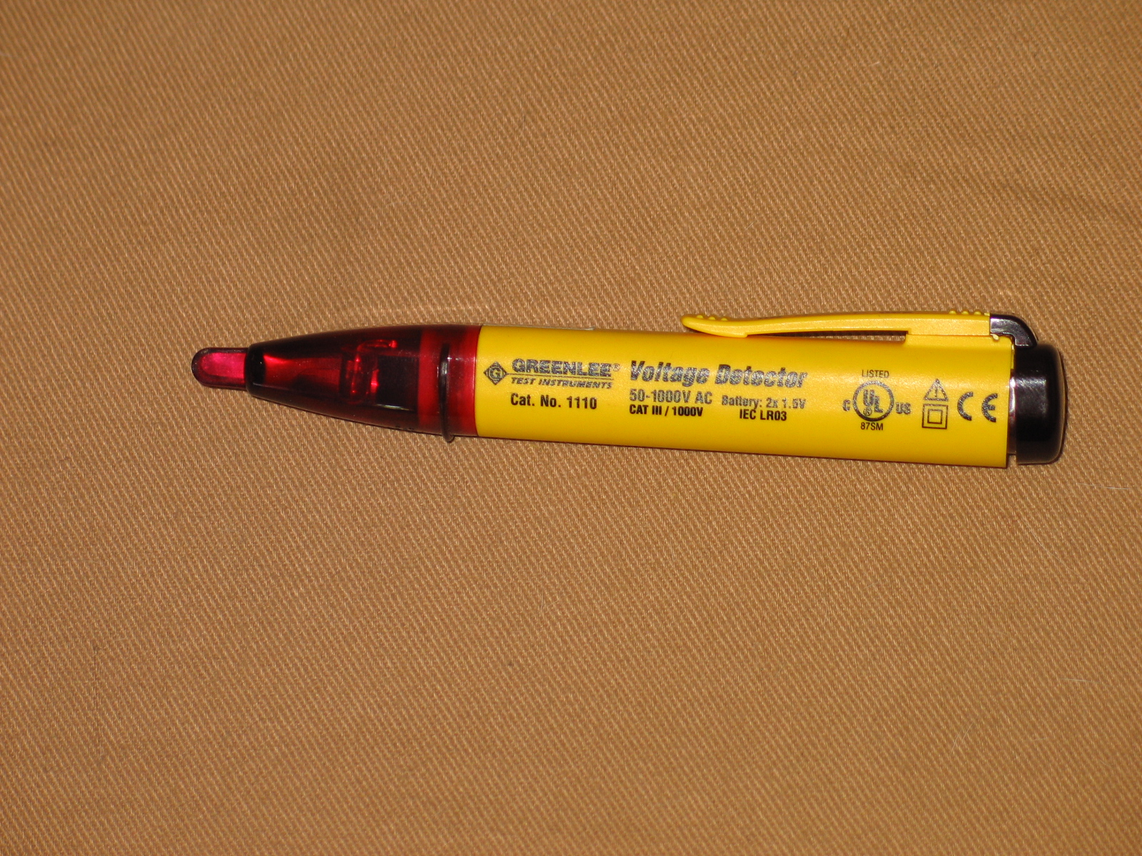

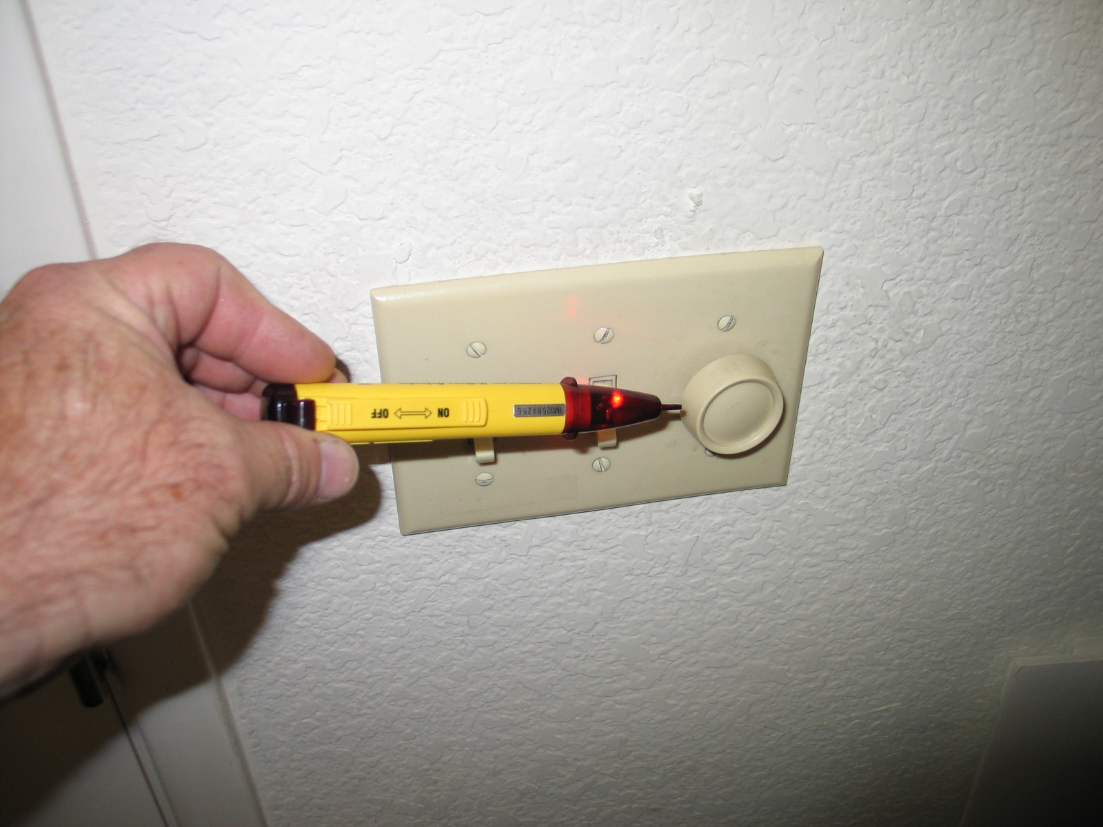

You can do an ohm meter check through the wires from the coils to just before to module. This will tell you if the coils are ok. I don't have a manual handy so I don't know what the values are. This doesn't sound like a coil problem. Is your engine old enough to have just one ignition module? It sounds like it could be a bad wire in the plug socket just before the module. IF you can wiggle the wires and they work then you most likely just have a bad connection and possibly in the socket. At an 800 rpm drop you are losing one complete ignition bank or 4 plugs. You can get an AC power tester for about $12 and since the plugs produce AC power the tester will show you which wires from the ignition coils to the plugs are firing and which are not. Picture attached. This tester can also find bad plugs and plug wires if you are only dropping 300 rpm. You just need to get the tester near the wire or touch the wire. If the module is bad wiggling the wires should not help. That's why I think it is just a bad connection since you can wiggle the wire and make it work until vibration loosens the connection again.
