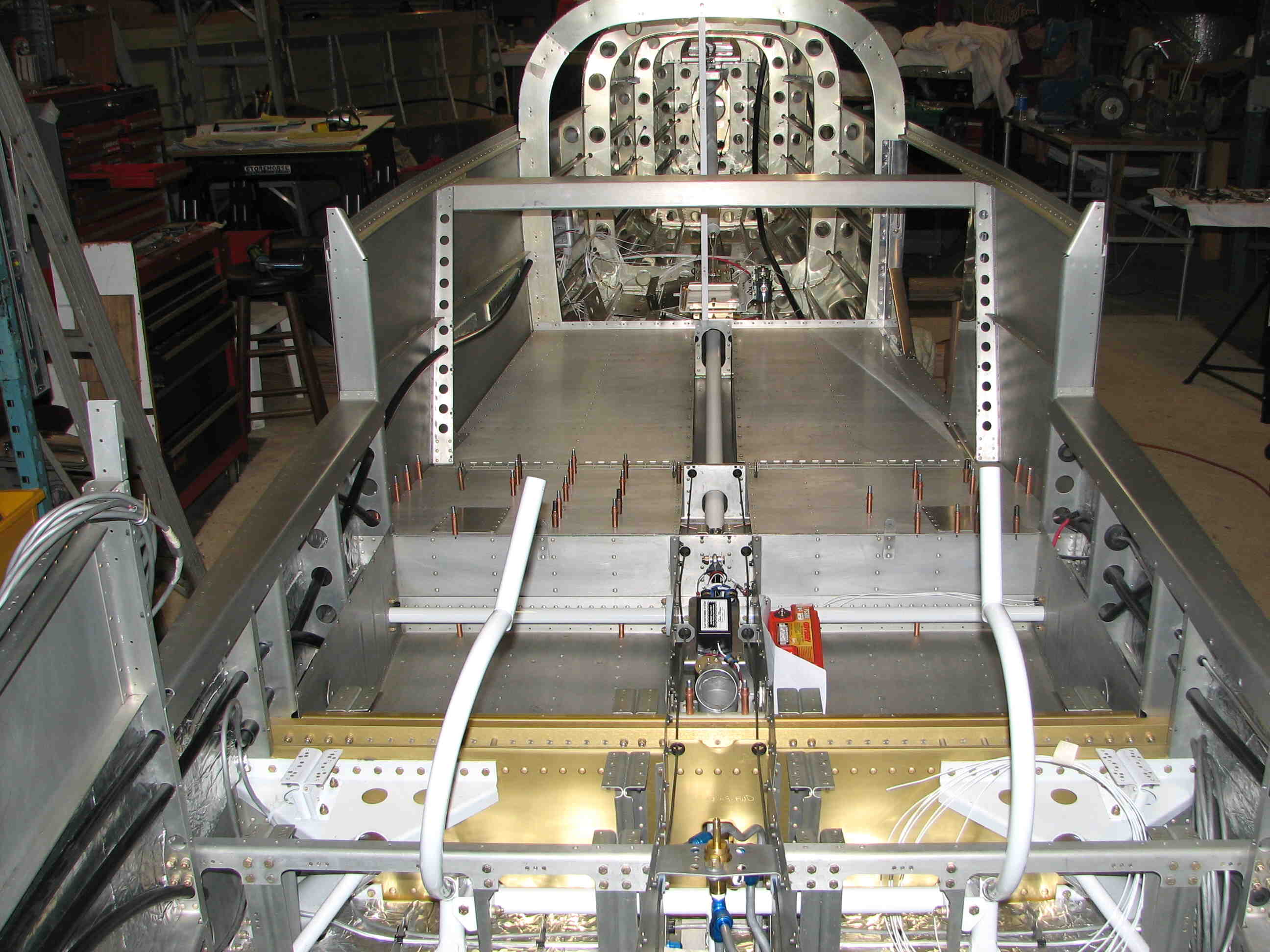

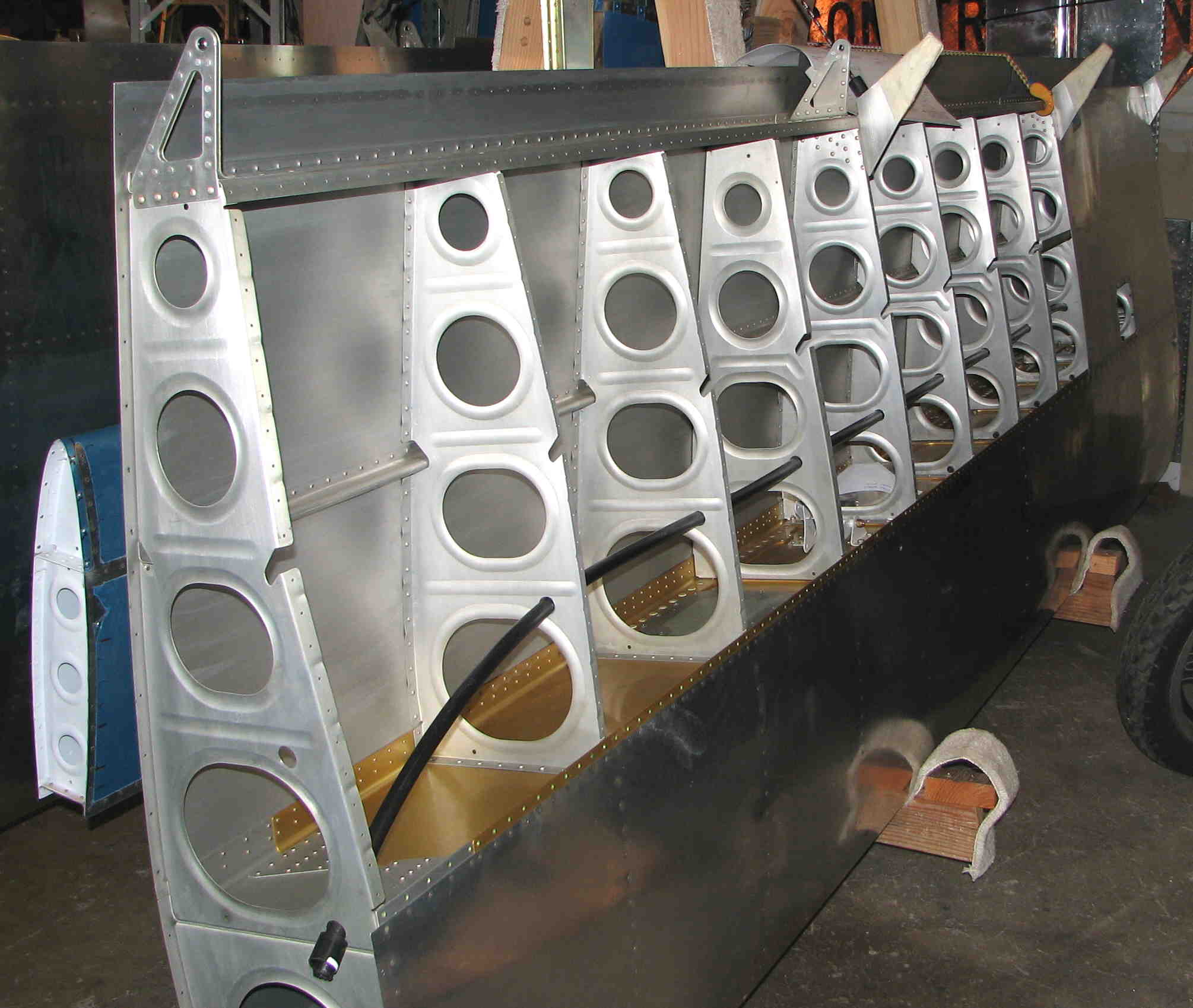

PostPosted: Fri Sep 19, 2008 9:39 pm    Post subject: Perhaps the first or many wiring related questions Reply with quote
That tubing is great..I used it along both sides of the fuselage also.... adding wires later, either in the wings or fuselage, a piece of cake. I used cut off connectors to secure them on one side of each bulkhead. Don

I pulled my AoA tubing through individual snap bushings (SB375-4 I think) where Van has his pitot tubing. Really not that hard to put in a new set of holes and bushings and the tubes stay rigid by themselves. The snap bushings give just enough resistance to keep everything in place.
For electrical conduit I drilled out Van's snap bushing run to take his corrugated nylon tubing. You need the right size uni-bit and a nifty 12" drill bit extension that fits the uni-bit shank from Home Depot. It's made by Ridgid and the "chuck" is 3/4". It will follow a 3/4" uni-bit through a hole without a problem.
Van's conduit is corrugated so you need to use a vacuum to pull a string through to get started. I replaced the string with a length of weed-eater line for future use.
In the fuselage I used more of Van's tubing but also - as suggested by others on this thread - thin wall irrigation tubing. The irrigation tubing has the advantage of smooth insides so you can push a wire through. It's heavier but not by much.
