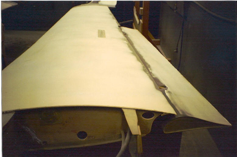

through the filler. Some airplanes, because of their building process will
have deep depressions, like in the place of spars or joints, which would be
difficult to fill sufficiently deep and yet smooth in one fill. The builders
natural tendency would be just to do the first big fill, sand to the shape
and then refill the areas of these low depressions as needed. It needs to be
done the other way around, you need to fill these deep depression first,
however that first fill must still stay below the intended finished surface
height, sanding through the top fill into the first filler coat would create

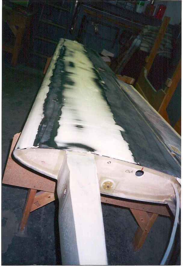

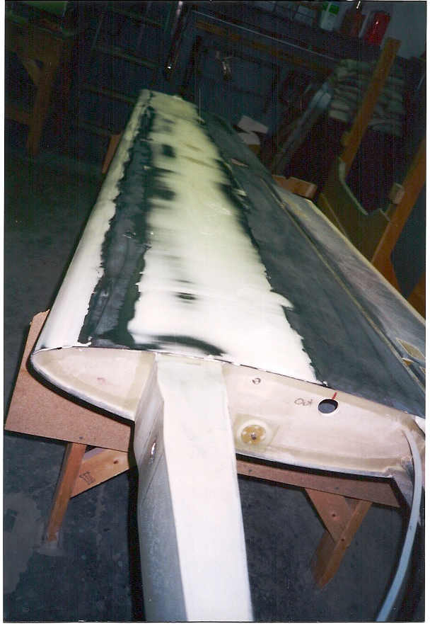

hard spots and uneven sanding properties. The picture below shows a good
example of this first head start fill where we had a significant depression
in the skin in the spar area and the joggle joint on the leading edge.
I strongly recommend spraying a light coat of black primer, before you start
filling, Even thou this step is not absolutely necessary it is very helpful
in guiding where to direct more sanding and when to change to finer
sandpaper grade. The filler becomes translucent as it gets thinner and the
black color starts showing through as dark spots indicating you are getting
close to the skin surface.

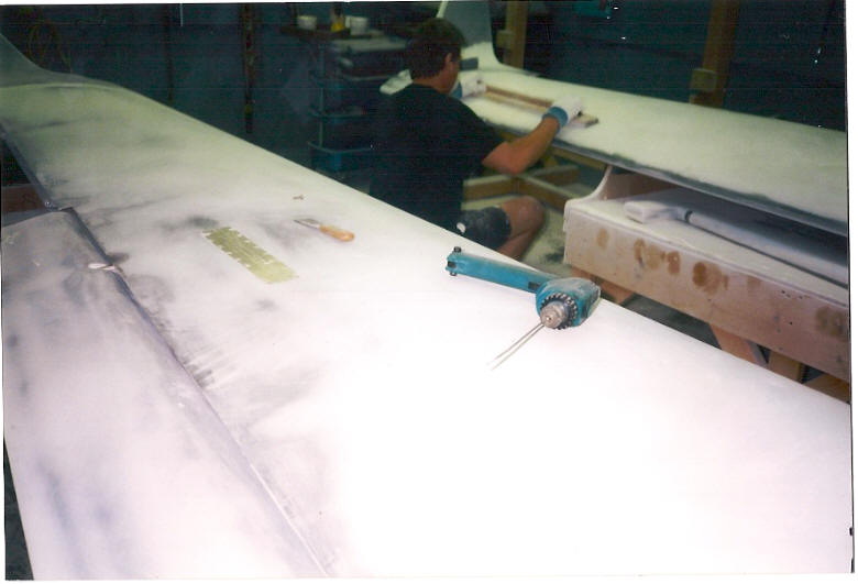

fine as you need to go on this. They say a picture is worth a thousand
words. Luckily I have some good ones to show you what it should look like at

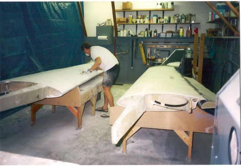

this point. On the picture below the right wing has just been filled and is
curing while I'm sanding the left one
This is a close up of the filed right wing
Here the left wing is sanded and the right wing is just getting started.
It’s hard to take a picture of an all white surface, it tends to get
overexposed and the details are lost but looking at the pattern of the dark
spots will give you pretty good idea what it should look like.

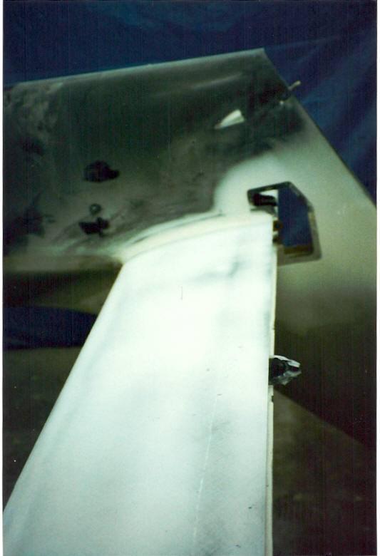

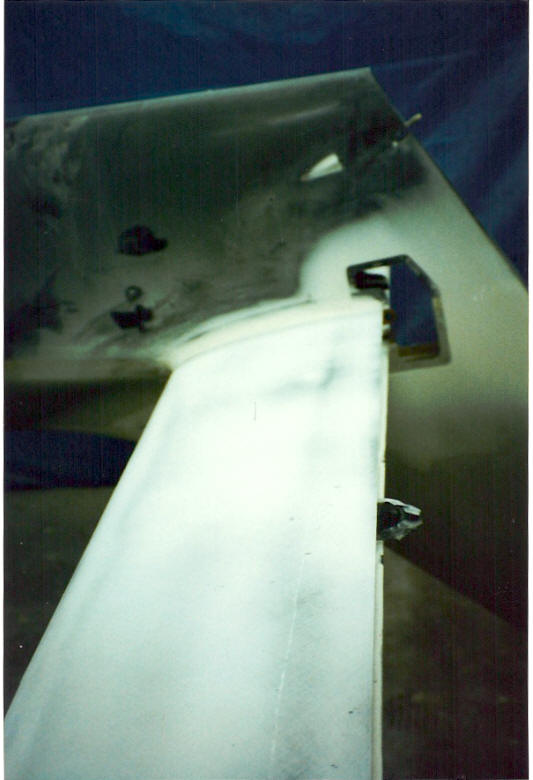

This is the horizontal stabilizer just at the point when the shaping is done
and when I switch to finer grade paper. You can see the cross hatch sanding
pattern there. The dark spots will get quite a bit darker by the time all
deep scratches are gone.

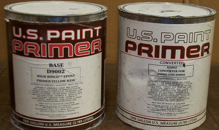

I have been using two kinds of primers so far.
One is "PPG K200" this is acrylic urethane (two part 4:1), very fast drying,
easy to spray, dark yellow in color. Available from auto paint supply
stores. It wet sands very easy, however it has rather soft properties even
when cured. Mishandling of parts can dent and scratch the surface rather
easily.
The other kind is epoxy based "US Paint D9002 base /D3002 converter" (Two
part 1:1). Also dark yellow, available from marine supply stores (
www.uspaint.com ) This primer takes longer to dry and it’s a bit harder to
sand but it is very hard and durable when fully cured. I myself prefer the
better durability, even if it takes more work.
I have not had a chance to try "Poly-fiber Smooth Prime" but I plan on it.

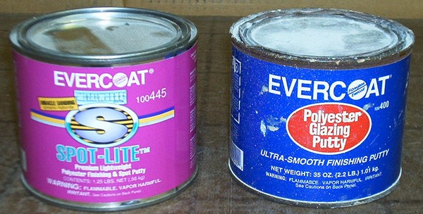

For this last filling use polyester based "glazing putty" (auto paint
supplies) This is very smooth creamy filler designed for minor
imperfections. Before you start filling go over the whole surface carefully
and mark all imperfections to be filled with a pencil so you don’t have too
look for them while your mixed putty is curing. Mix the glazing filler in
small batches, it has very short pot life so you have only a few minutes on
each batch. Squeegee it on with a small metal spatula and scrape off any
excess. Wet sand the spots after they cure and you are done.
