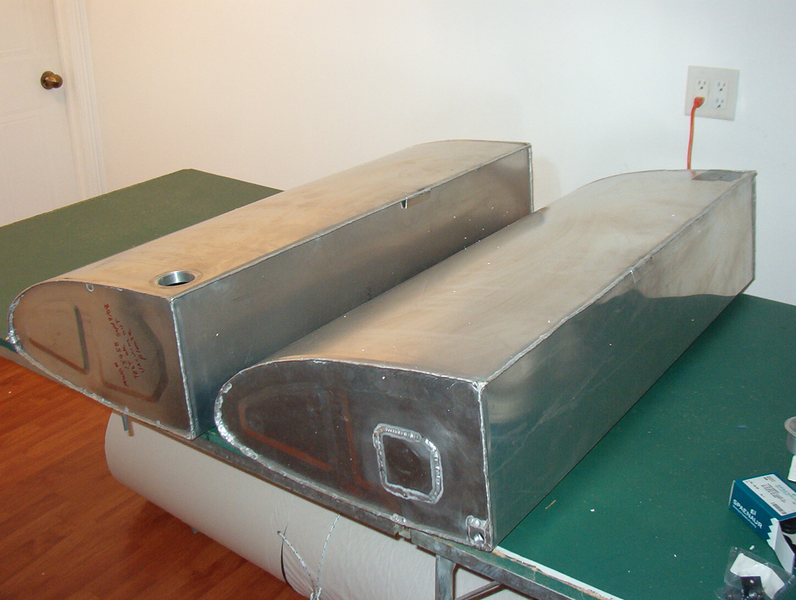

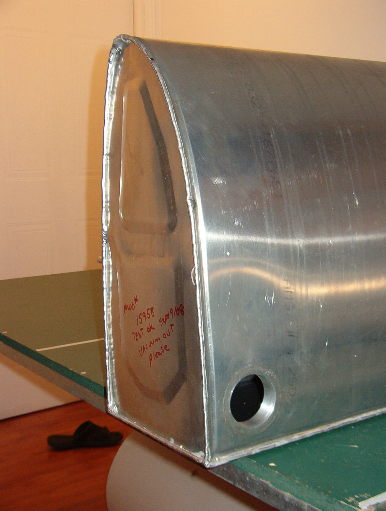

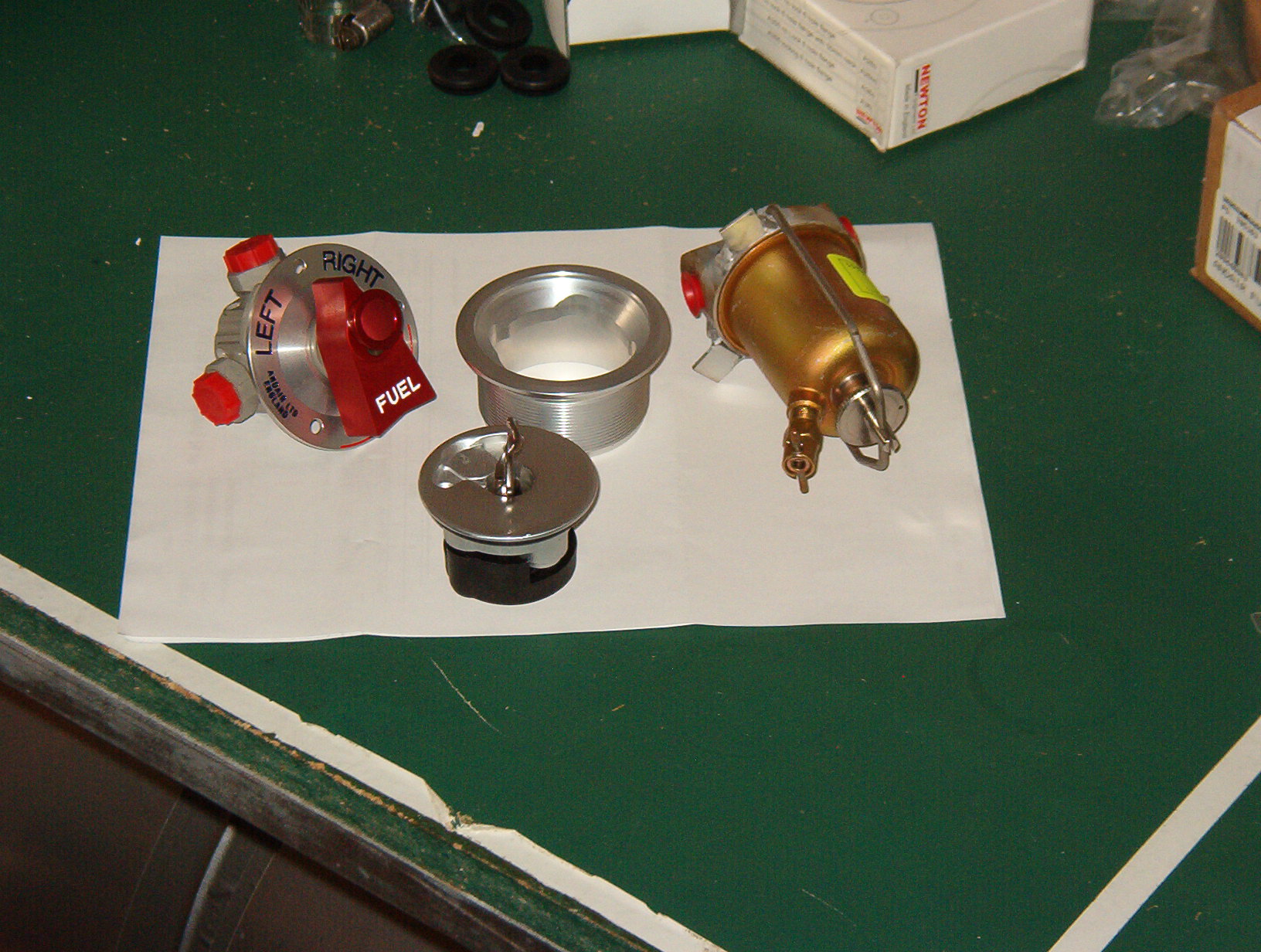

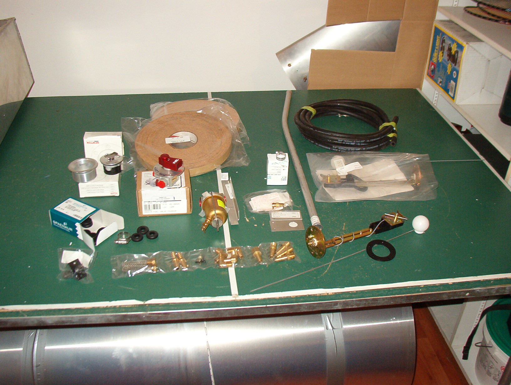

Christian Tremblay
Joined: 22 Aug 2008
Posts: 25
Location: Montreal

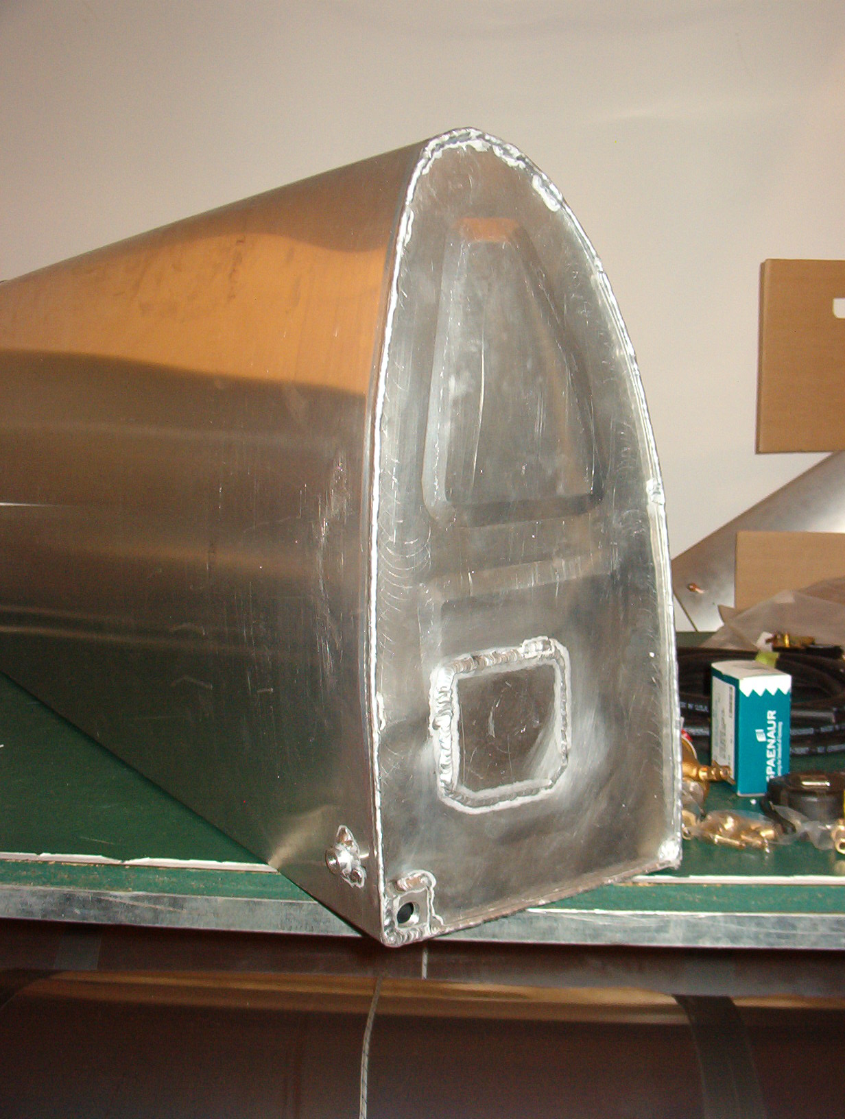

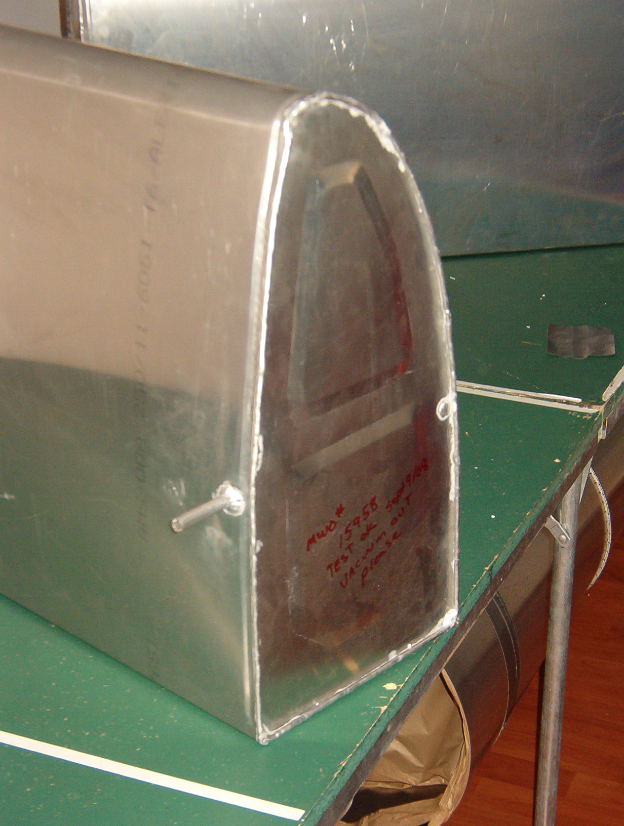

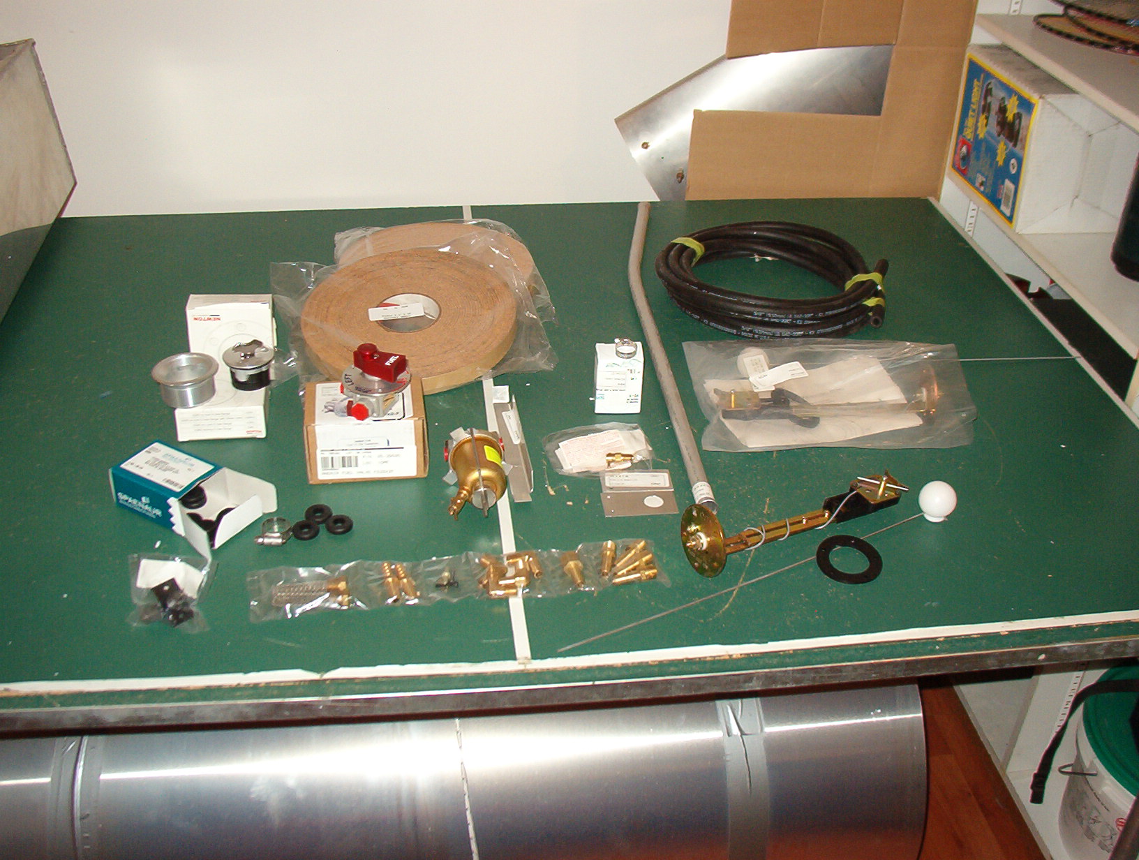

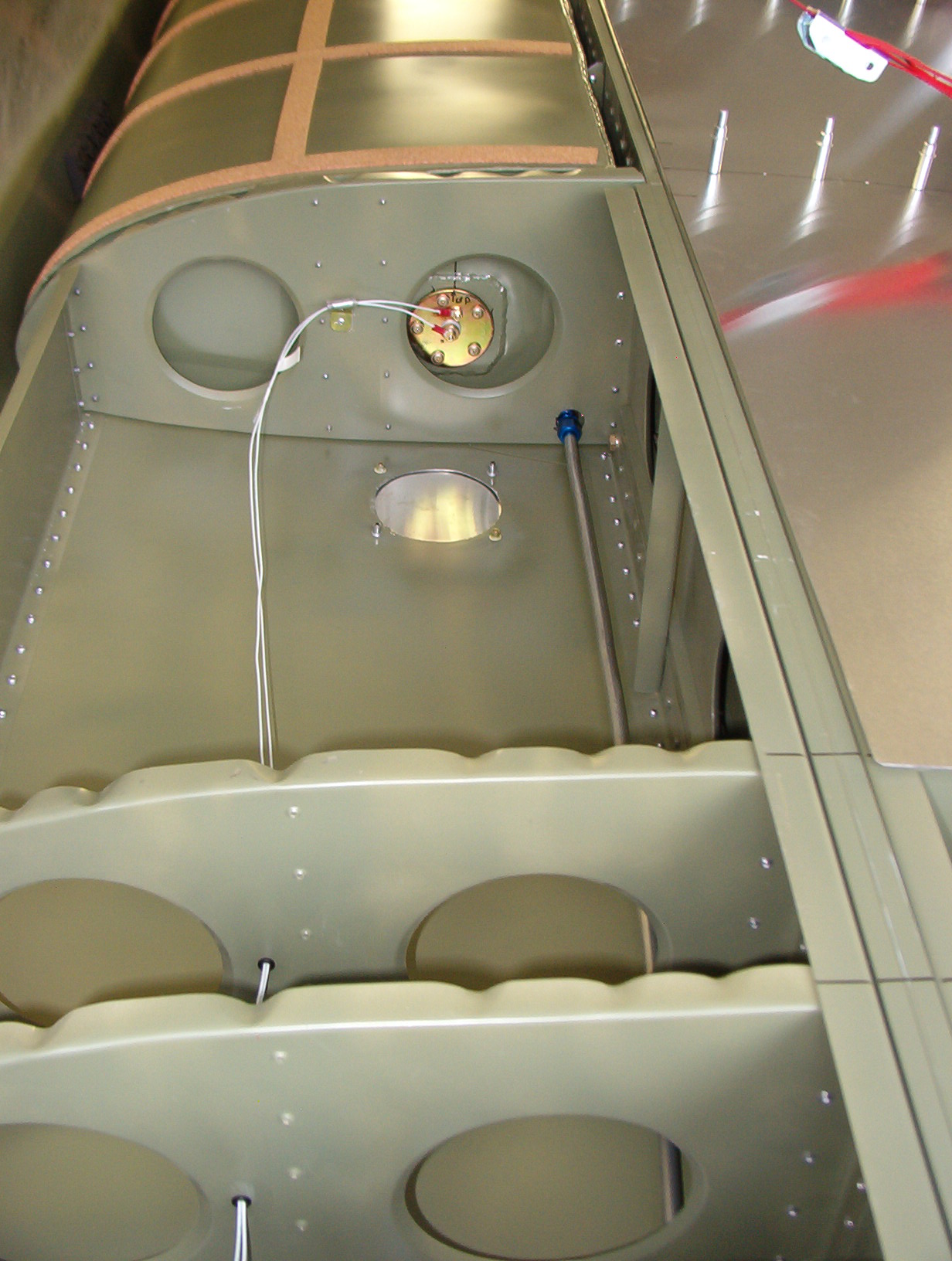

PostPosted: Fri Oct 17, 2008 4:20 pm    Post subject: Photo of Extended Tank Range Reply with quote
In attachement 6 photos of the tanks and all piece includes with the kit.
Christian

All piece supplied with the tank : from tank to Firewall - including all fitting needed

Botton of Right tank - Vent tube welded inside on top
 Filesize:  434.54 KB
 Viewed:  1619 Time(s)

Inbord side of Right Tank
 Filesize:  402.39 KB
 Viewed:  1580 Time(s)
Left & Right tank

pilot4pay
Joined: 01 Jan 2007
Posts: 171
Location: Louisville, KY
PostPosted: Sat Oct 18, 2008 1:32 pm    Post subject: Extended Tank Range Reply with quote
Hey Chris, one more question, please. Is the top/nose/bottom and back skin
one continuous sheet of aluminum? That would make three pieces total for
shell construction.
C.S.

Christian Tremblay
Joined: 22 Aug 2008
Posts: 25
Location: Montreal
PostPosted: Sun Oct 19, 2008 8:03 am    Post subject: Re: Extended Tank Range Reply with quote
Yes the bottom, up and back sides is a continuous form, one piece. You have also left and right side, this mean 3 pieces to weld. If you plan to do the tanks in 0.025, I suggest you an inside ribs with holes in bottom and top to let the gaz freely circulates. This inside rib will give more rigidness to the tank.
See you.
Christian

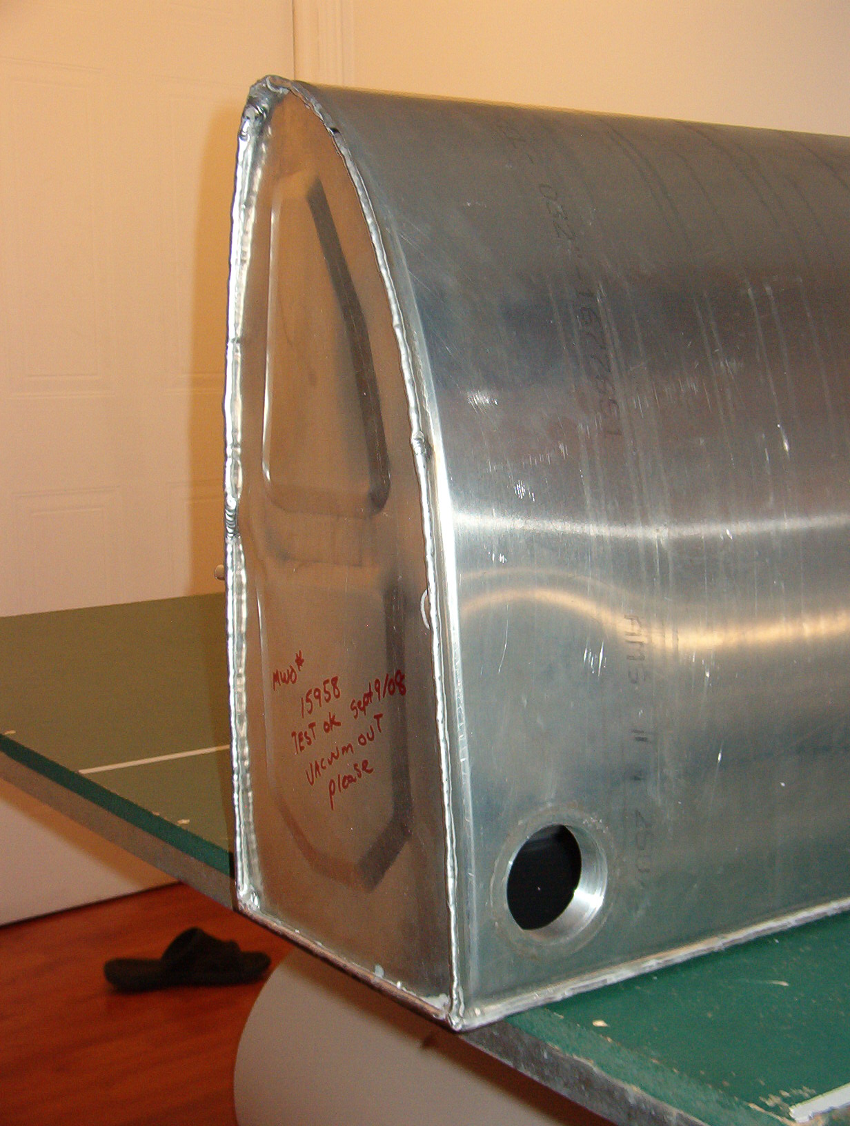

PostPosted: Mon Oct 27, 2008 10:12 am    Post subject: Re: Extended Tank Range Reply with quote

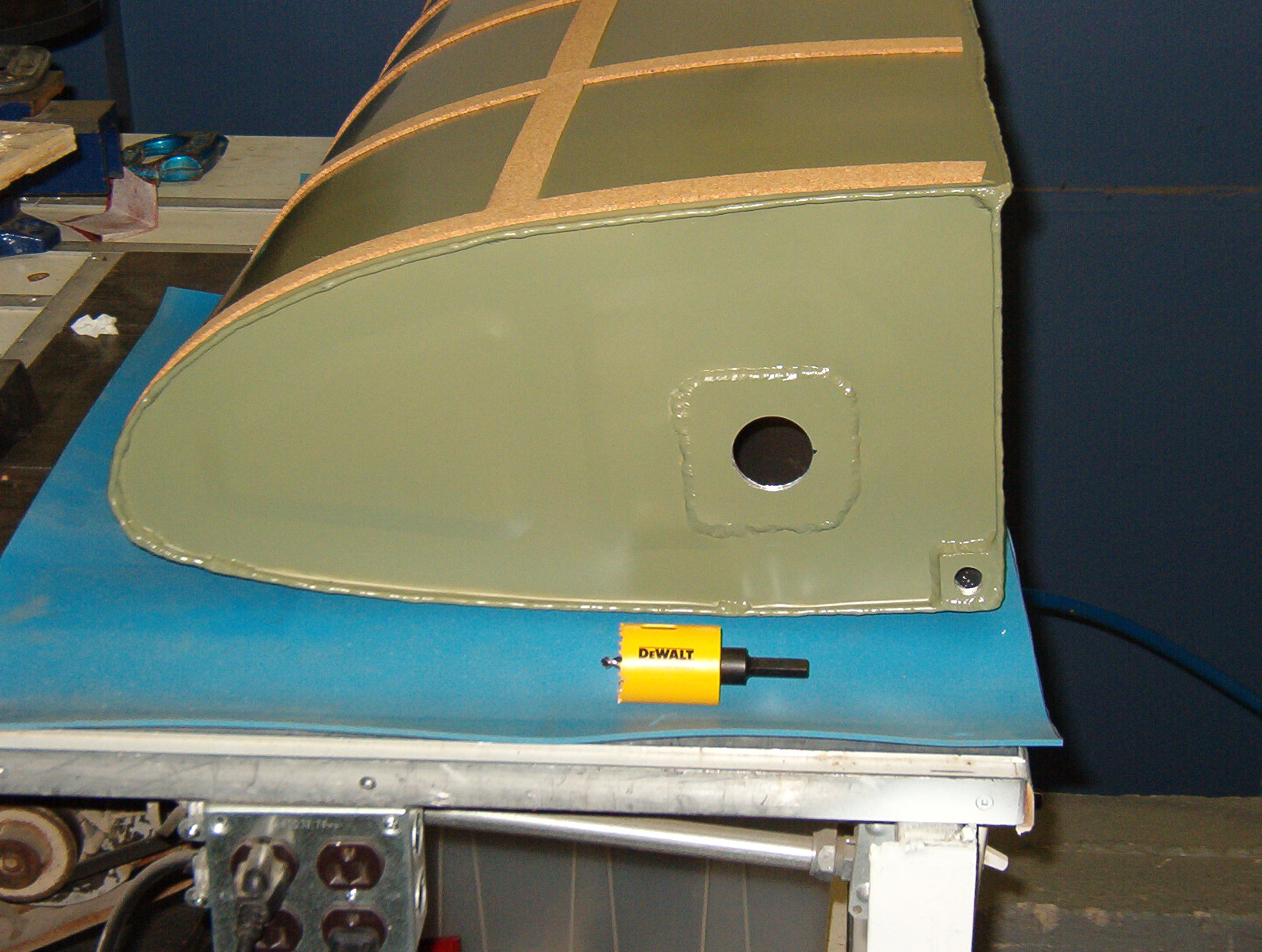

Chris, I have yet another question. From the photographs, I see that the fuel float assy. is not installed. I'm guessing that the small welded panel on the side is the base for installing the the float assy?

Christian Tremblay
Joined: 22 Aug 2008
Posts: 25
Location: Montreal

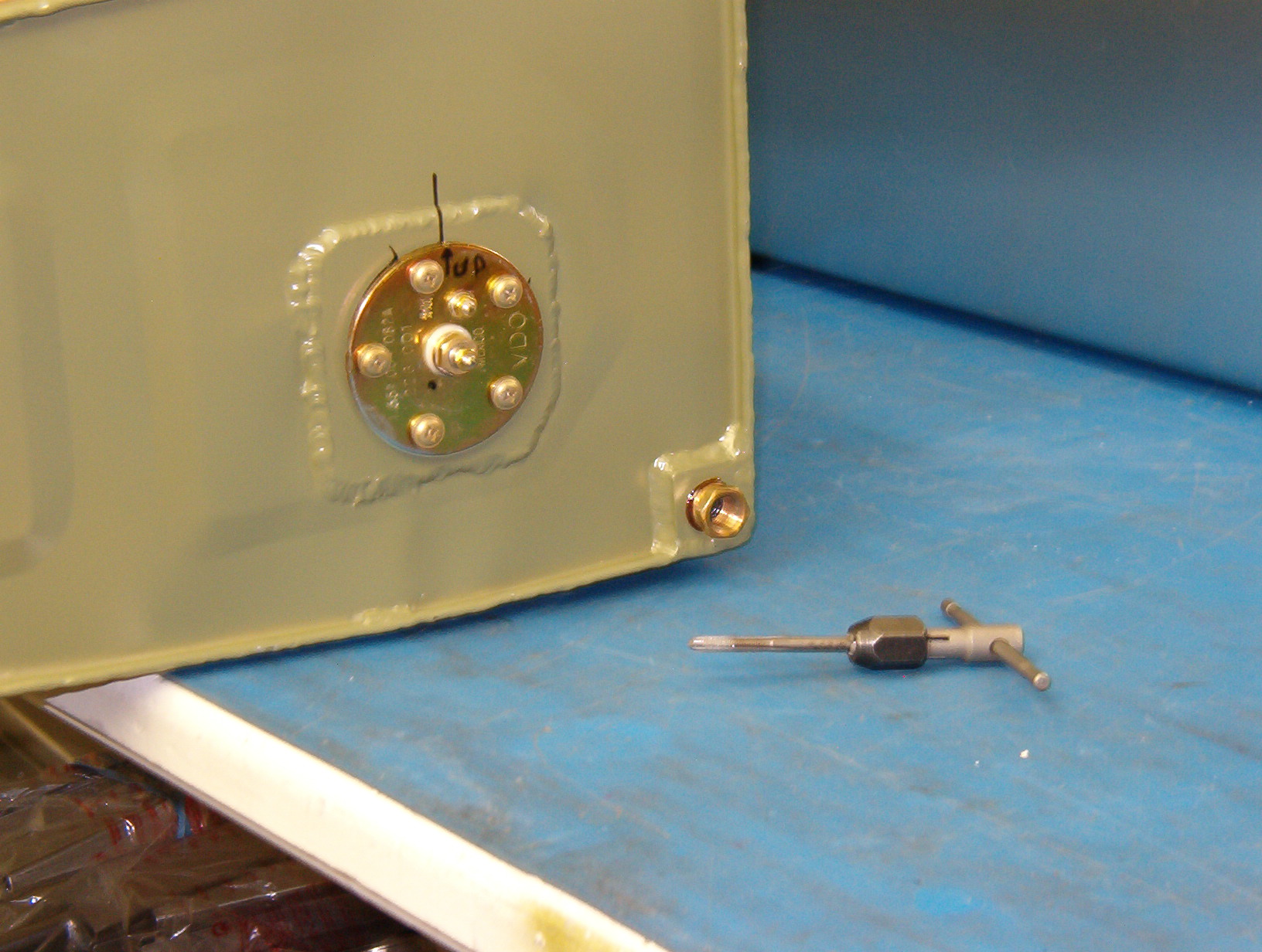

PostPosted: Mon Oct 27, 2008 6:54 pm    Post subject: Re: Extended Tank Range Reply with quote
Hi Craig,
Your right, this small plate is for attaching the fuel sensor with 3/16 metal screw x 5/8 of an inch (24 tread). The hole was done with a 1 5/8 Dewalt hole drill cut off remover. This plate is done with a square piece (3 x 3 inches) with a 0.125 piece of 6061-T6 welded to the tank skin. See photographies attached.
Christian

Additional info:
Rectification it is not exactly metal screw that should be used, but metal bolt with cross head for tightening with a screw driver tool. You should do hole with tread with a left hand tap tool.
