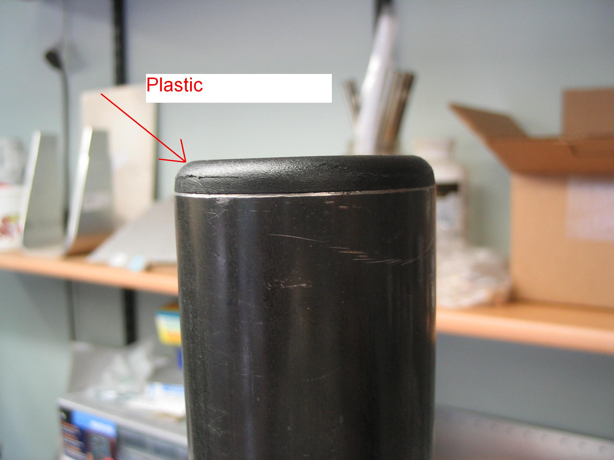

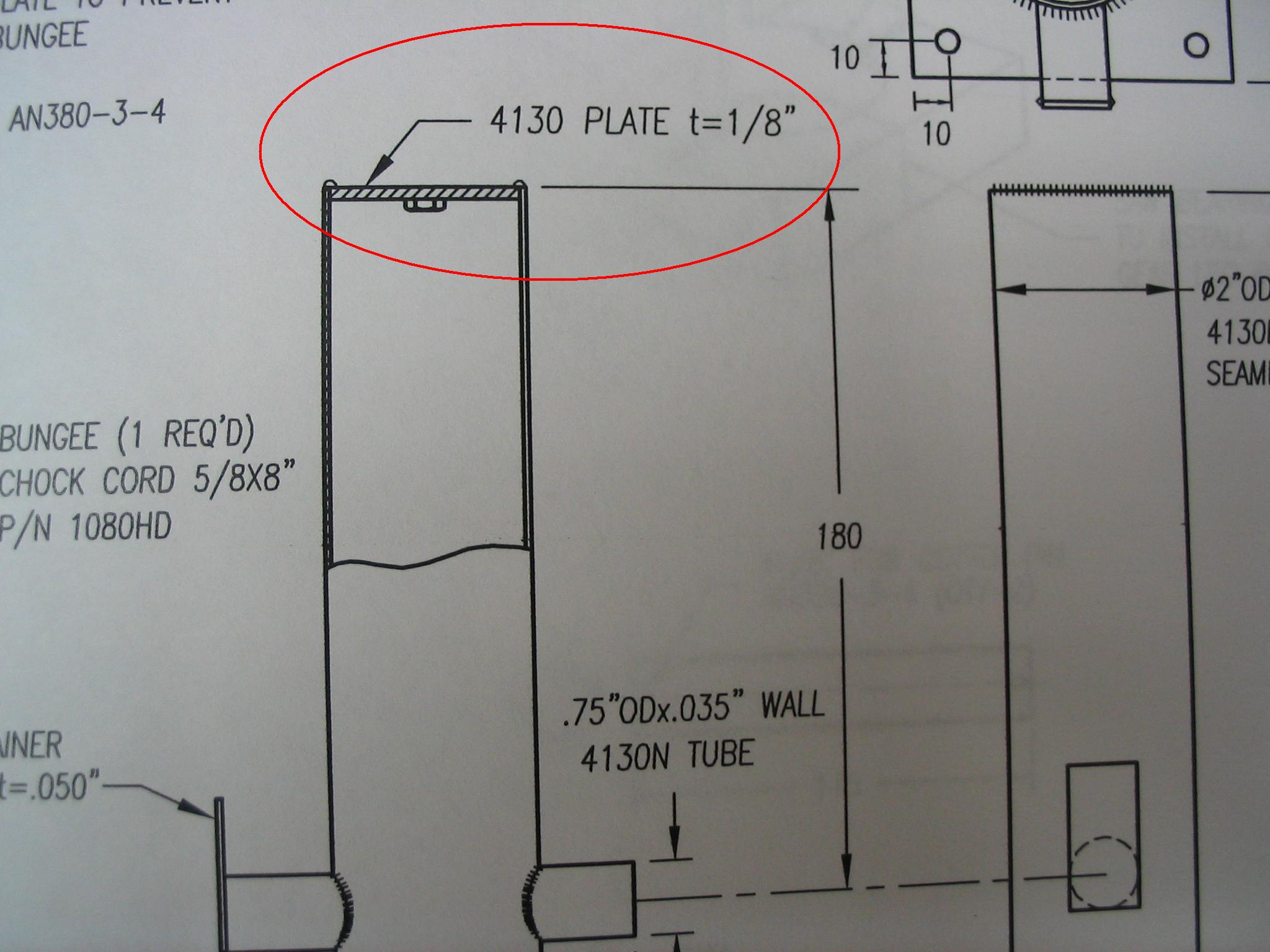

Drawing 6-G-1 shows that the Nose Gear Strut is capped with a welded 1/8" plate of 4130 steel (see picture).
The nose gear strut in my kit has a plastic top (see picture).
Anybody have the same thing? If so, how did you attach the 6G2-3 Stop Plate?
- Pat

You are among the lucky fortunate! You have a new kit that no longer uses
the top plate as a bearing surface. The top just floats up and down thru
the opening. The plastic cap keeps dirt and loose parts from falling in.
It is wonderful to not have the issue with the 'old' style where you prayed
that the top bearing and bottom bearing came to rest at the same time!
Jon

I contacted Zenith on this same thing and they said this is the new style that has the bottom bearing and welded stops on the strut to take the place of the top stop

Mines the same way. I called Caleb and he said the upper stop is no longer required.
