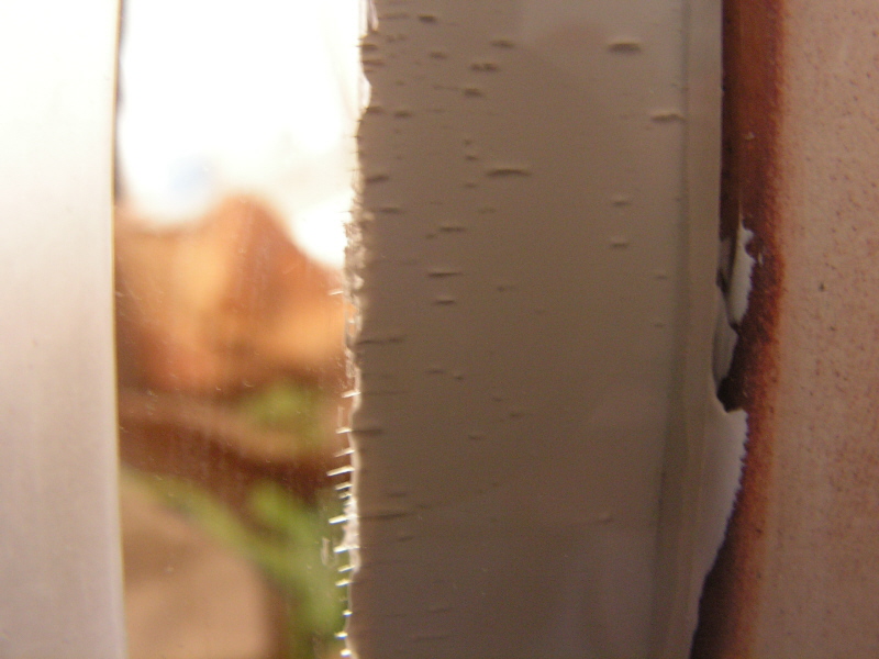

Just finished installing my windshield with Weld-on 10 C and there is crazing where some clamps were on the sides C photo & details below. So here are my questions:
1: How common is crazing at the glue joint?
1: If left as is will the crazing run across the window?
2: Is there anything (other than replacement) that will keep it from creeping? The crazing is small and can easily be hidden as long as it doesn't keep creeping.
The fine print: I have installed all the other windows with no problems using foam blocks and straps to clamp it in place. The windshield  was installed at 80 degrees. Main pressure was from a strap & foam blocks with additional clamps on sides (the area of the crazing.) Only rubbing alcohol was used for cleaning. Edges sanded completely smooth with no nick or scratches. The gluing surfaces were roughed up with 240 grit sand paper.
The crazing was noticed 1 1/2 hours after I started the gluing process. At which time I removed the side clamps. And called Scott at Van's C he has requested pictures.
Any help or suggestion would be appreciated C

I am not flying yet, but had the same thing happen to me with one of my side windows. It is really frustrating and it seems 10x as big a deal with the front windscreen. It has not spread on mine, but it is not really subject to vibration yet. I am leaving it, but on the main windscreen, I would have to think about it. Stop drilling is always an option and works well on plexi. I did it on an old Piper Archer that I had.
My three big beefs with the basically superb RV10 design are: 1)the structural windows that cannot be removed and replaced easily 2) the riveted down floors in the back with no inspection holes (I made some) and 3) electric pitch trim w/o manual backup

Same thing happened to me. I have seen no growth since I have been flying…..~50 hrs.

Why does the crazing occur? Is it the product? Or process?
I plan on using 3M 2216 for my windows.
Dave Leikam
RV-10 #40496
N89DA (Reserved)

My very uneducated guess......heat/compression. It only happened where I
had the windshield clamped and extra Weldon under the clamp.
Rene' Felker
RV-10 N423CF Flying
801-721-6080

PostPosted: Thu Sep 11, 2008 9:17 am    Post subject: Weld-on 10 & crazing Reply with quote
You know, the common thread I see when people bring up crazing
with window installation is the use of clamps. I did use some
clamps, but not very tight clamps on mine....I think I may have
only used those squeeze clamps that you open with your hands.
Either way, I didn't use tons of pressure, just used them to
hold position. I had no crazing.
I'm starting to wonder if the people having crazing aren't
maybe using a bit more pressure on their clamps, or perhaps
not spreading the force out enough on the windows.
I'd say, pad the clamps, and don't clamp any tighter than
necessary to hold the window in position. Don't try to
squeeze out excess glue, just position it. I don't
know WHY clamping with pressure would add to the problem,
but I do notice that in almost all cases, the person
said it either crazed where the clamps were, or at least
that they had used clamps. I'm betting this is the cause
somehow.

PostPosted: Thu Sep 11, 2008 9:34 am    Post subject: Weld-on 10 & crazing Reply with quote
Don't know for sure, but just assuming that the clamping pressure increases
the temperature of the Weldon during the curing process. It would not take
much initial clamp pressure to do that once the Weldon starts to expand
during the curing process. I would add that in my case I wiped off the
excess Weldon except for the area under the clamp.

I think I wiped off mine too....tried to fillet the inside, and
get rid of gobs on the outside. That stuff dries so tough
that you wouldn't want to have to do all the work after
it cures. You're probably right....heat, pressure, and
probably the chemical makeup, probably all acting together
when clamped.

Hi Tim C
I used the same hand type clamps as shown on your web site during install of your window.  All clamps were padded with layers of masking tape. There is no sign of deflection of the acrylic during or after clamping C but maybe hand springe clamps are not the best choice. The thought that direct pressure on the Weld-on cause it to set off is an interesting idea.
I am in contact with IPS technical service (they manufacture Weld-on) and they have the pictures also. It was suggested to try using a diluted detergent (two drops on non ammonium based dish soap in gallon of water) to clean the mating surfaces instead of the rubbing alcohol. Also there may be a need to anneal the acrylic before installing to normalize the internal stresses of the plastic. They also said Weld-On 10 was a good choice for gluing acrylic to fiberglass.
As for repair they are working on it & I will pass along anything I learn.
Van's did get back with me and here is Scott's reply:
Vern C Thanks for the photos. This looks very similar to what we saw on both of our RV-10's.
Spoke with the rest of the tech crew here and all input that we've had is that the crazing does
not 'move' significantly after the weld-on sets up and clamps are removed. scott at van's
Thanks C

PostPosted: Thu Sep 11, 2008 12:34 pm    Post subject: Weld-on 10 & crazing Reply with quote
Ahhhhhh!!!! You used rubbing alcohol!!! That's a definite no-no!
There aren't that many things you can clean it with. Kerosene
is one. There IS one thing that I used that I can't endorse, but
can report on. During painting we used PPG DCX330 degreaser
extensively in prep of things, INCLUDING all the window edges,
and we tested it on the windshield scraps to make sure it wouldn't
craze. So maybe that is an option. But yeah, NO SOLVENTS on
the windshield for cleaning....that's definitely not a good idea.
mild soap and water, maybe...but I'd be careful of anything
else. kerosene obviously wouldn't be good pre-cleaning for
paint....but might not be so bad pre-installation. Also,
I'd leave any plastic on windows as long as possible.
Tim
Vernon Smith wrote:
Hi Tim,
clamping, but maybe hand springe clamps are not the best choice. The
interesting idea.
/Vern, Thanks for the photos. This looks very similar to what we saw on
removed. scott at van's/
/Thanks,/
/Vern Smith (#324)/
> Date: Thu, 11 Sep 2008 12:16:38 -0500
> From: Tim(at)MyRV10.com
> To: rv10-list(at)matronics.com
> Subject: Re: Weld-on 10 & crazing
> somehow.
> Tim Olson - RV-10 N104CD - Flying
> Vernon Smith wrote:
> > Well folks I'm not a happy camper,
> > Just finished installing my windshield with Weld-on 10, and there is
> > crazing where some clamps were on the sides, photo & details below. So
problems
rubbing
> > sand paper.
process.
> > At which time I removed the side clamps. And called Scott at Van's, he
> > Any help or suggestion would be appreciated,
> > Vern Smith (#324 finishing sort of)

PostPosted: Thu Sep 11, 2008 5:33 pm    Post subject: Weld-on 10 & crazing Reply with quote
Mineral spirits are recommended by one of the windscreen companies.
Michael
pietflyr(at)bellsouth.net
PostPosted: Thu Sep 11, 2008 6:17 pm    Post subject: Weld-on 10 & crazing Reply with quote
I work with acrylics every day in my job as an engineer in the medical
device industry. Acrylics in general can stand stress, or exposure to
alcohol (or other solvents) but not at the same time. They, like many
plastics, are subject to a phenomenom known as "stress cracking", which
starts as crazing. It is caused by the material having stress (either
molded in or induced by a load, such as a clamp) while being exposed to a
chemical, and the result is a crack at a stress far lower than would
normally cause a crack to start.
The good news is that once the solvent and/or the stress is removed, the
crazing stops and is not likely to spread, so if the crazing doesn't show,
you probably won't have to replace the windshield.

PostPosted: Thu Sep 11, 2008 6:30 pm    Post subject: Weld-on 10 & crazing Reply with quote
I knew acetone was out and now nix the rubbing alcohol. Though rubbing alcohol was OK because it is recommended by Lancair. But they don't use Weld-On.
At least 4 out of the 5 windows turned out. Oh well it's only time and money.
Rene C Tim C Dave and Michael thanks for the feedback.
Vern

PostPosted: Thu Sep 11, 2008 8:09 pm    Post subject: Weld-on 10 & crazing Reply with quote
Are we talking industrial grade (Lowes) Isopropol alcohol or rubbing alcohol? If there was a solvent that was the least invasive, least etching, least anything in so far as damaging polystyrene/acrylic products it's Isopropol alcohol. Kerosene or JP-4/8 is a petrol based solvent, "diesel fuel" that has an oil content. How could kerosene be used to degrease and make ready for an adhesive when it leaves an obvious oil film/residue behind?
Also consider the finish on the edge of your plastic. I used a series of polishing grits to make the edge of the transparencies almost as optically clear as the rest of the material..My thinking was if you leave microscopic lines in the edge of the material and your using an expansive (and under pressure), thermic, chemical bond, why leave the adhesive an entry point to work on the lateral surface where the surface tension of the area has already been weakened/relieved by scuffing it for a better bond.
I really think that if you don't polish the edges just like the aluminum, apply pressure and an adhesive that attacks the material to create the "weld-on" joint, any small void will crack or "craze" just like a stress riser but on a smaller scale, hence the "crazing" FWIW yes the crazing stops, becasue the adhesive has entered the void and has cured. The microcracks have been formed and rejoined with the curing of the weld-on.

PostPosted: Fri Sep 12, 2008 4:54 am    Post subject: Weld-on 10 & crazing Reply with quote
Not sure exactly what type of "plastic" our windows are made of, but the
list at the link below gives the effects of using various
solvents/substances on acrylic plexiglass and I figure ours is pretty
close. It's a pretty inclusive list, and I used it as a guide for
figuring out what substances to avoid (anything with an "N" in both
columns). Isopropyl alcohol is not so good. Ethyl alcohol is better if
you can find it without any additives.
http://www.ridoutplastics.com/plexiglas-chemical-resistance.html
PJ Seipel
RV-10 #40032
