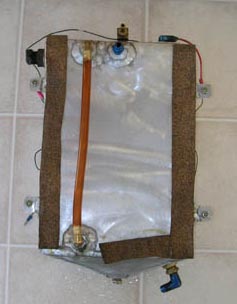

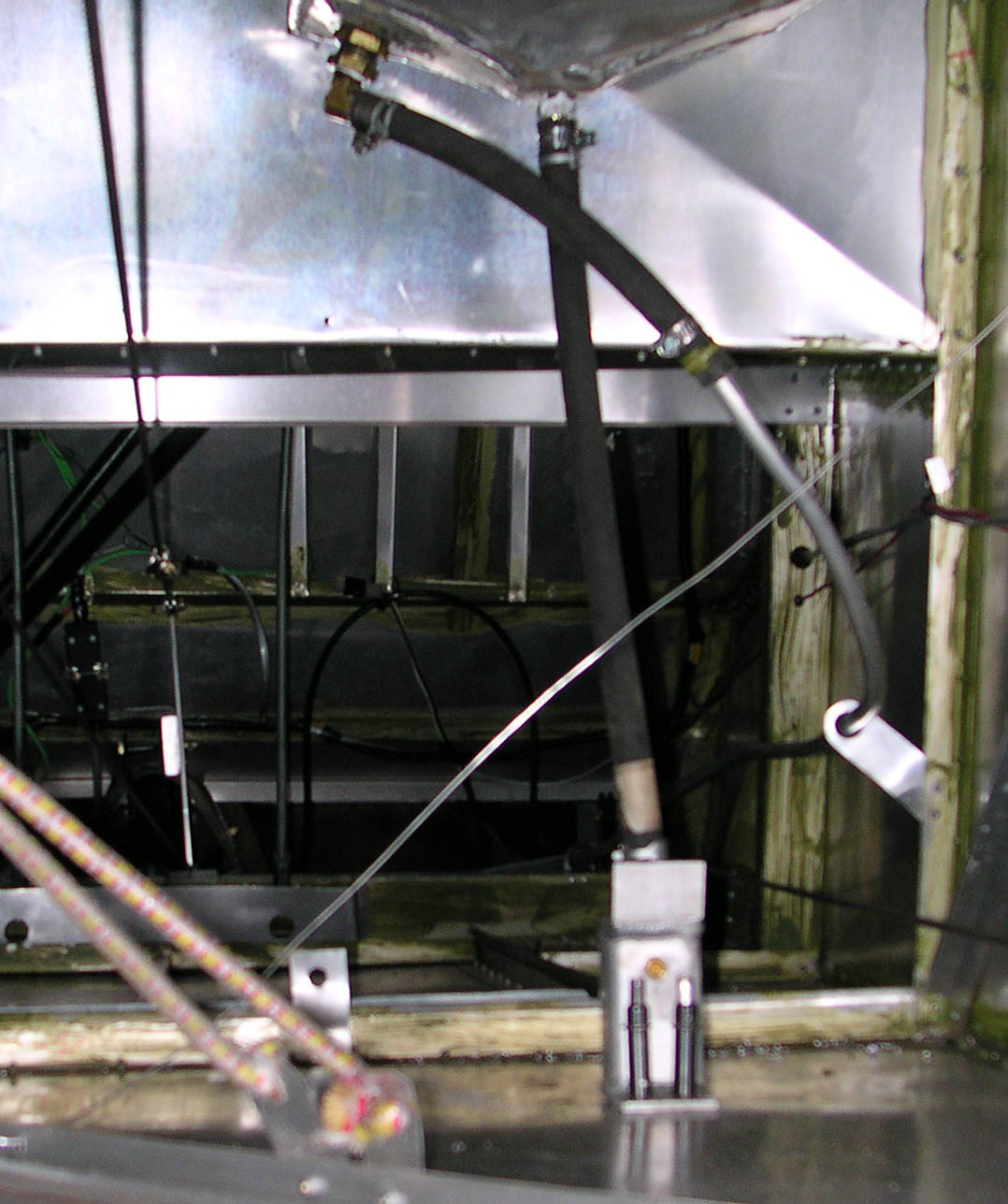

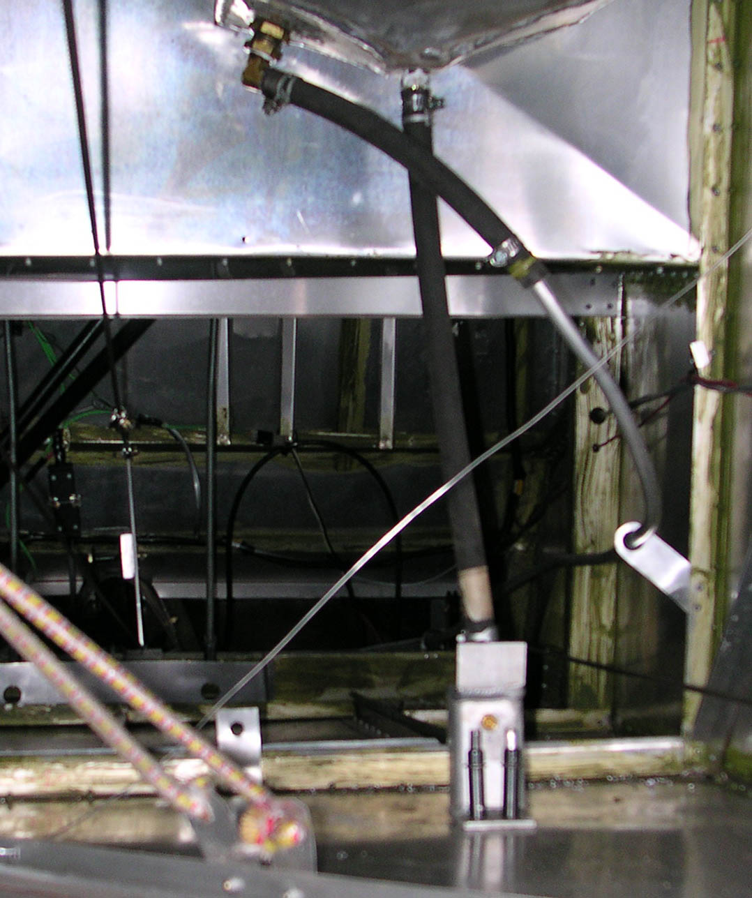

PostPosted: Sun Sep 14, 2008 11:24 am    Post subject: 701 Collector Tank Reply with quote
Stan
I recently posted a discussion of my fuel system (14/06/0Cool. You should be
able to find it in the archives. Attached are photos of the collector tank
and its location on the rear fuselage side of the baggage compartment. 8
liters gives me 30 minutes emergency fuel to land. I'm on amphibs and
usually within gliding distance of an emergency landing area.
Hope that helps
Carl
