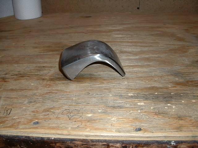

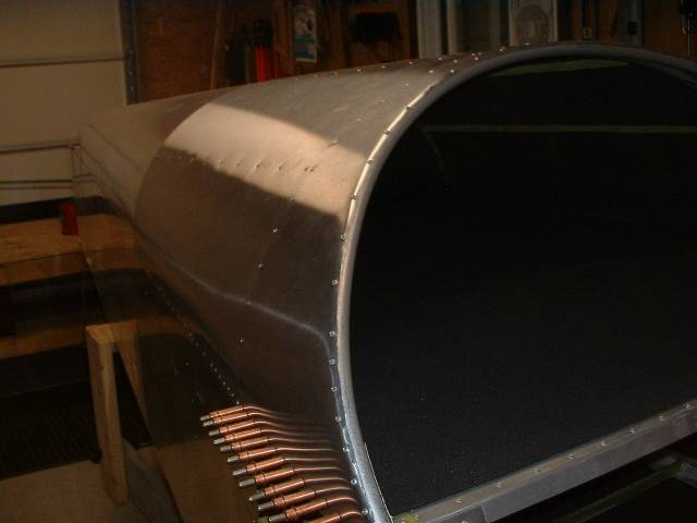

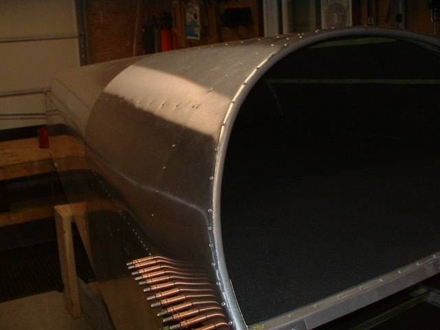

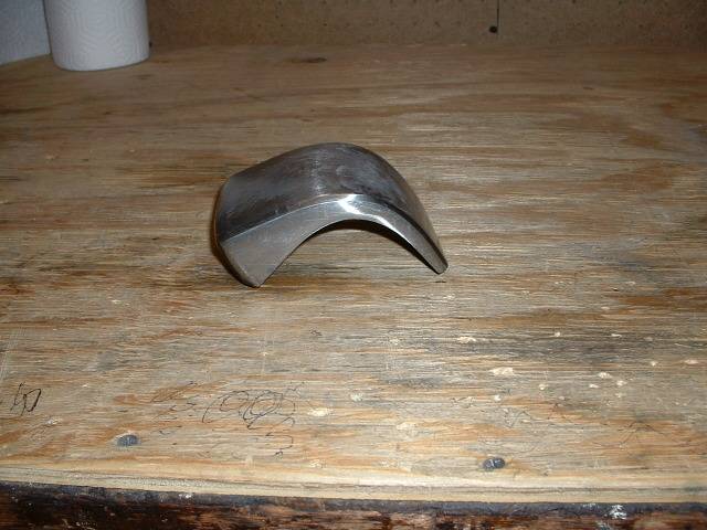

Since there's absolutely nothing in the achives, I've decided to post the following:
To smooth out the top skin/front hoop, hit the edge with a body dolly, not the hammer.
Pictures attached.
