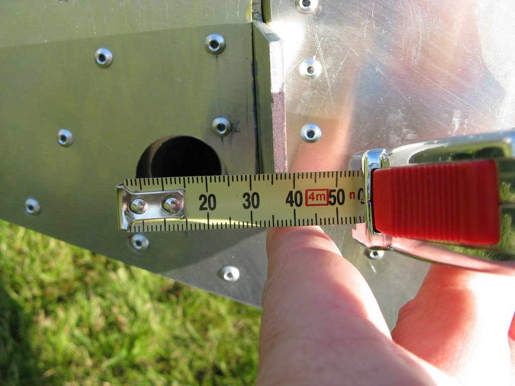

Tim Juhl wrote:
I get the impression that the rear spar attachment bracket on the 650 is made out of thicker material. Can anyone confirm that?
Here's a picture, with a ruler held up against it.
- Pat

PostPosted: Mon Sep 15, 2008 9:09 pm    Post subject: Rear Spar attachment Reply with quote
Thats about 0.1377949" Smile
