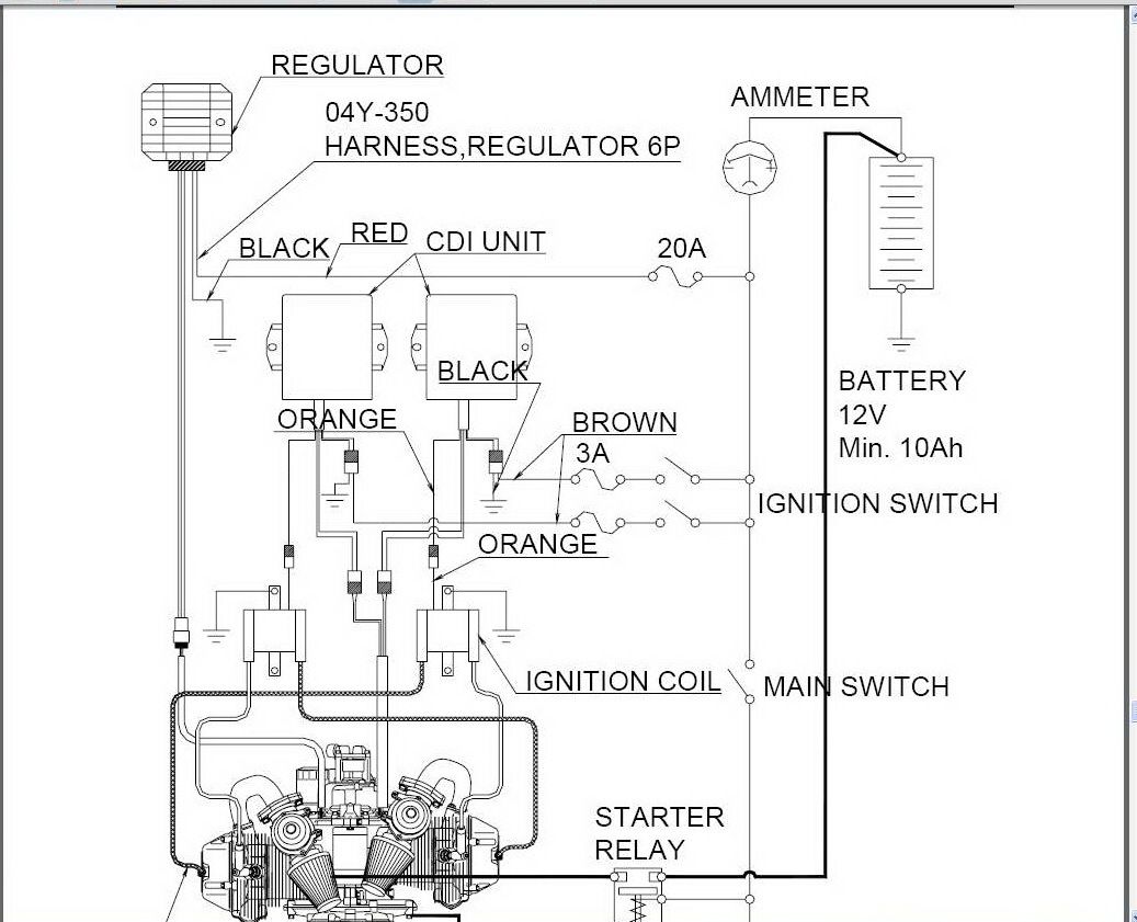

Yes, it is possible to fry an expensive ignition module if you do not have a fuse in line. But again, I have seen fuses just go bad and open up for no reason, or even the fuses sockets go bad over time and lose the connection. I would never use a SINGLE fuse in an aircraft ignition, I would rather burn up a module than risk having my engine unexpectedly and unnecessarily quit. In the area that I fly in, an off airport landing for me would result in a lot of damage to my plane, and maybe myself Shocked I would risk a module any day over that.
I downloaded the HKS wiring diagram, they show a separate 3 amp fuse for each ignition system, which is something I would do. A single fuse or socket going bad in this setup would not cause an engine failure. One thing that I do not like in this diagram is that they show the fuse after the ignition switches.... If I was trying to prevent a short from burning up my wires, I would put the fuses before the switches, not after... Many times shorts happen in or around the switches themselves. Attached is a picture of the HKS diagram, while it looks good, though I am not sure they got it right when the show the fuses after the switches.

PostPosted: Tue Sep 09, 2008 8:46 am    Post subject: Fusing the Ignition System Reply with quote
"JetPilot" << ... the HKS wiring diagram, they show a separate 3 amp
bad in this setup would not cause an engine failure. Mike >>
Mike - I hafta agree with you that a single fuse to the entire ignition
system (like how Rotax does it) poses a higher risk than the way HKS
wires it, with a fuse going to EACH of the two ignition modules. Adds
redundancy. (desireable)
I also noticed from the HKS wiring diagram you posted: HKS recommends
fusing the ignition modules at 3 amps; but Rotax calls for a 30 amp fuse
for the ignition system. I wonder why there's such a big difference in
amp values?
