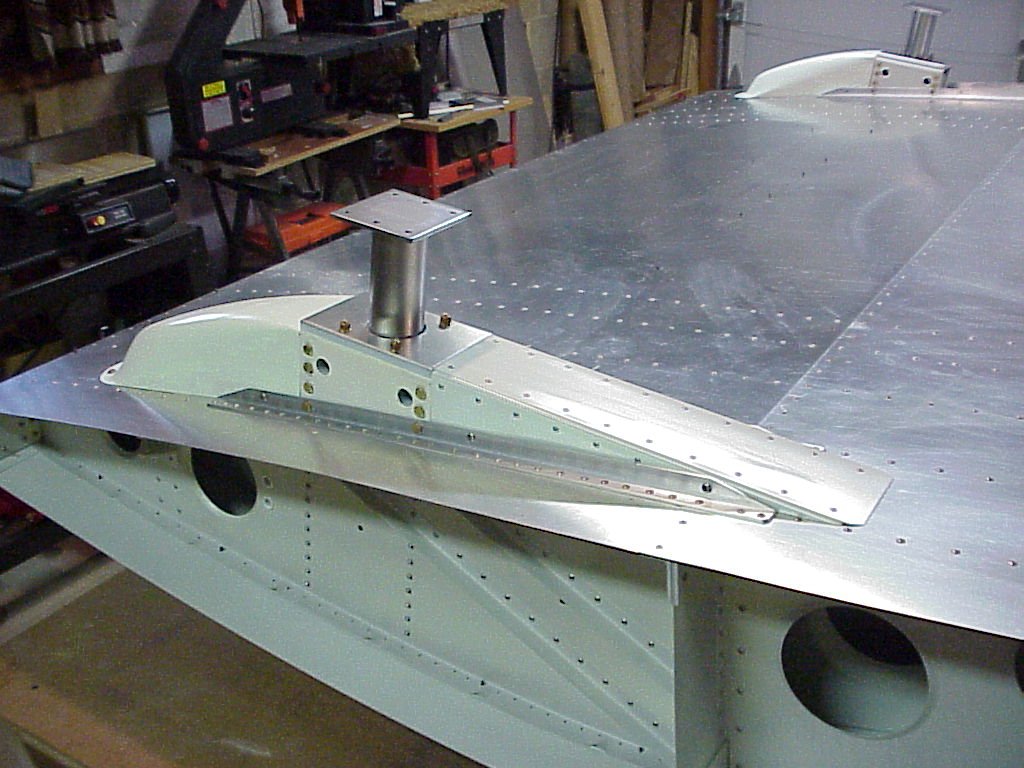

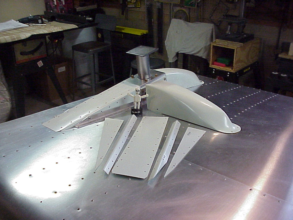

I have had a Q from someone with a 601HD and I guess its the same with the HDS , the box gear fairing, is that a part that you have to make or can you buy it somewhere? Zenith? or Larry from Macsmachine it looks like a fiberglass cowl that covers the MLG root area.

Front is simple L-angle and some .025. Rear portion is a fiberglass part from the taildragger option for the HD/HDS series. Have him call ZAC and see if they have any in stock - Roger will know. I don't know part # or whether they might carry the stock.
