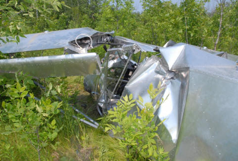

Slamming the engineering is rather arrogant unless you are a structural engineer and even then there are better ways to discuss the strength of a system. Since CH has experience in structural engineering, I'd be more likely to ask the question to him rather than making negative comments as to competency on the list.
I've attached a photo of the field tested seat belt attachment. The collision with the terrain resulted in crumpled distortion of the fuselage NOT the bolt pulling through the attachment. I'm more likely to assume that the structural engineer has calculated considerations of the strength of the fuselage and its characteristics under heavy loads. This crumpling seems to have some good features in that the pilot receives less bodily damage due to an immovable seat belt system.
Cal

Crumpled seat belt attach point.
 Filesize:  41.13 KB
 Viewed:  650 Time(s)
Crumple at seat belt attach point.
 Filesize:  41.13 KB
 Viewed:  677 Time(s)

I thought that showing the photo of the deformation of the fuselage at the shoulder harness attachment would show that maybe a calculation of shear force on an anchored piece of aluminum may not be an accurate representation of the complete picture. Being that I'm not a structural engineer (or even a mechanical engineer), I got the impression that your calculation only included the aluminum attachment piece, the bolt, and 200 lbs at 10Gs shear. If you, in fact, included force absorption due to the deformation of the fuselage structure, then I'd say we may have to consider replacing our stock seat belt tabs. However, I can't seem to get past the evidence that in an actual crash, the tab was stronger than the fuselage. At what point, with the inclusion of structural deformation, does the scenario of tab, bolt, 200lbs body take over?
Cal
