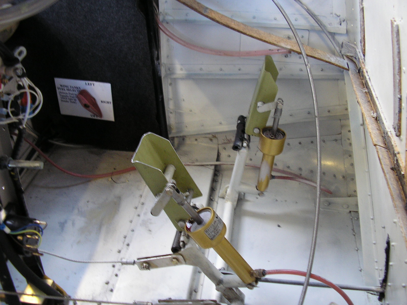

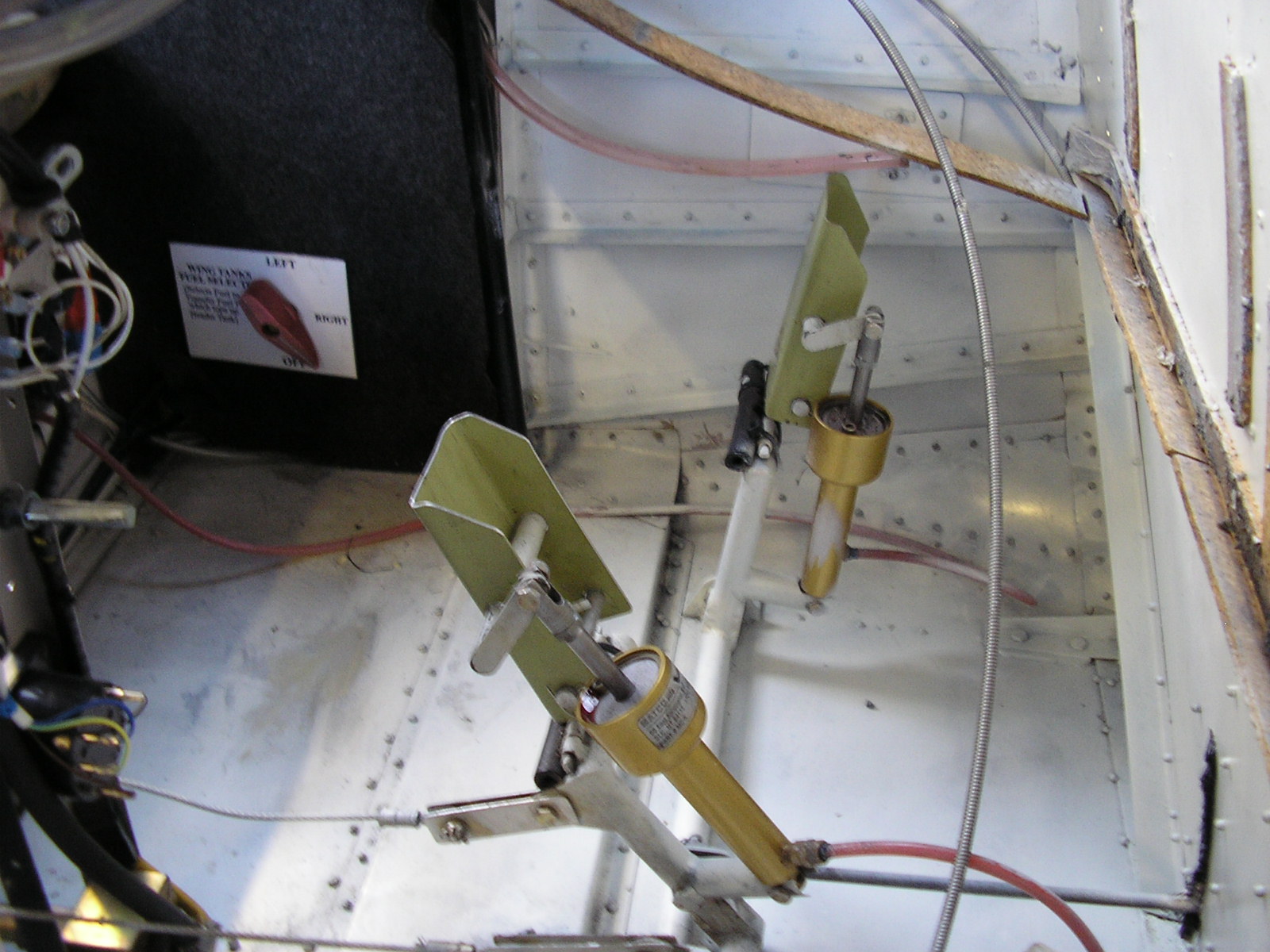

PostPosted: Thu Sep 04, 2008 1:08 pm    Post subject: on gear, Do we have pedal issues? Reply with quote
We tiewrapted a piece of hose to pivot bar and cut some thread off cylinder rods to move operating bar forward & since then have added aluminium plates so brakes will actual hold aircraft for run-up of continental 0-200 picture attached you could weld a plate on if you have access.
Do not find a problem with this as you have to apply positive pressure to top of plate for brakes to have any effect. I am size 7 but Ray is much larger 12 I think.
