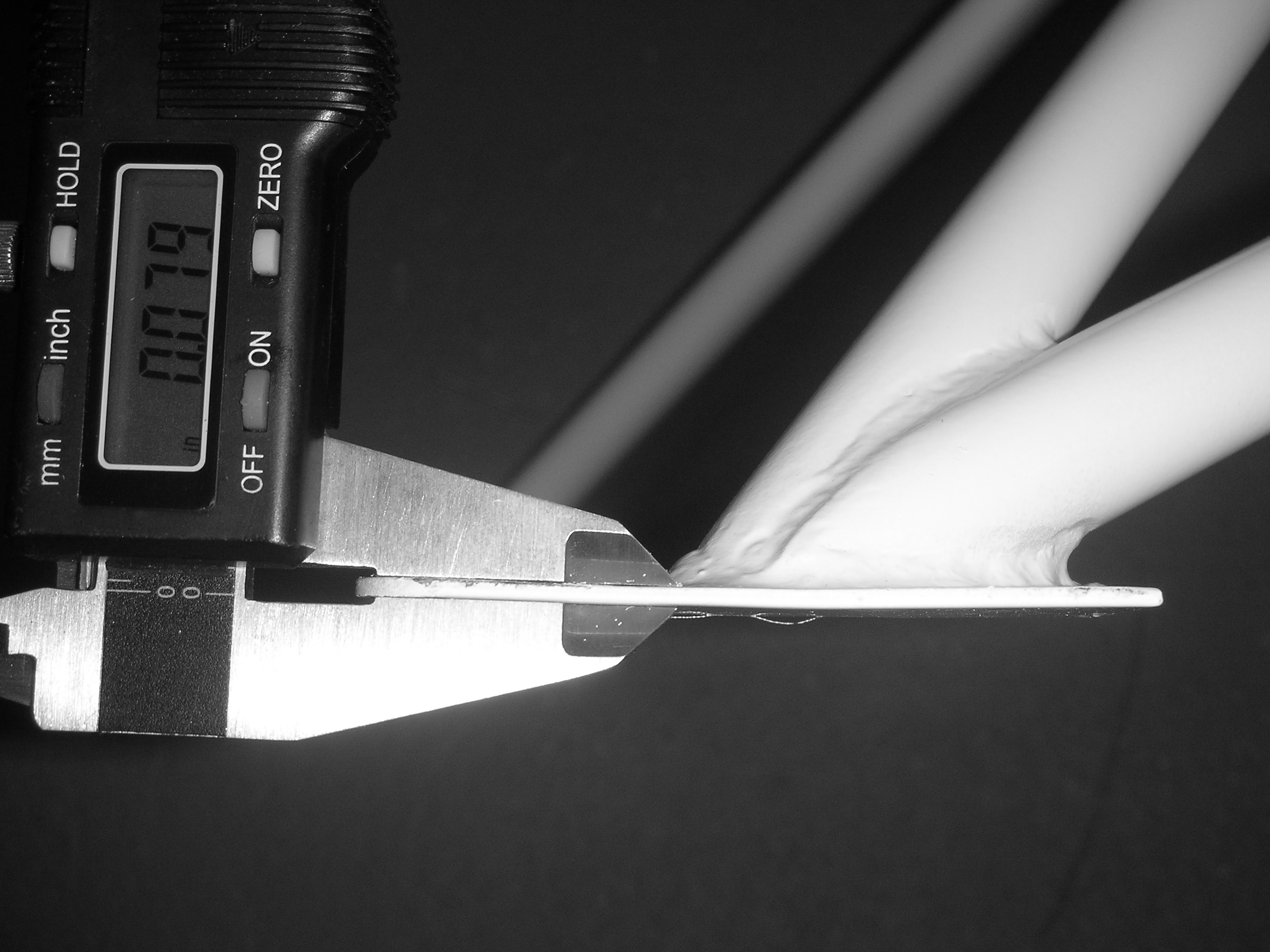

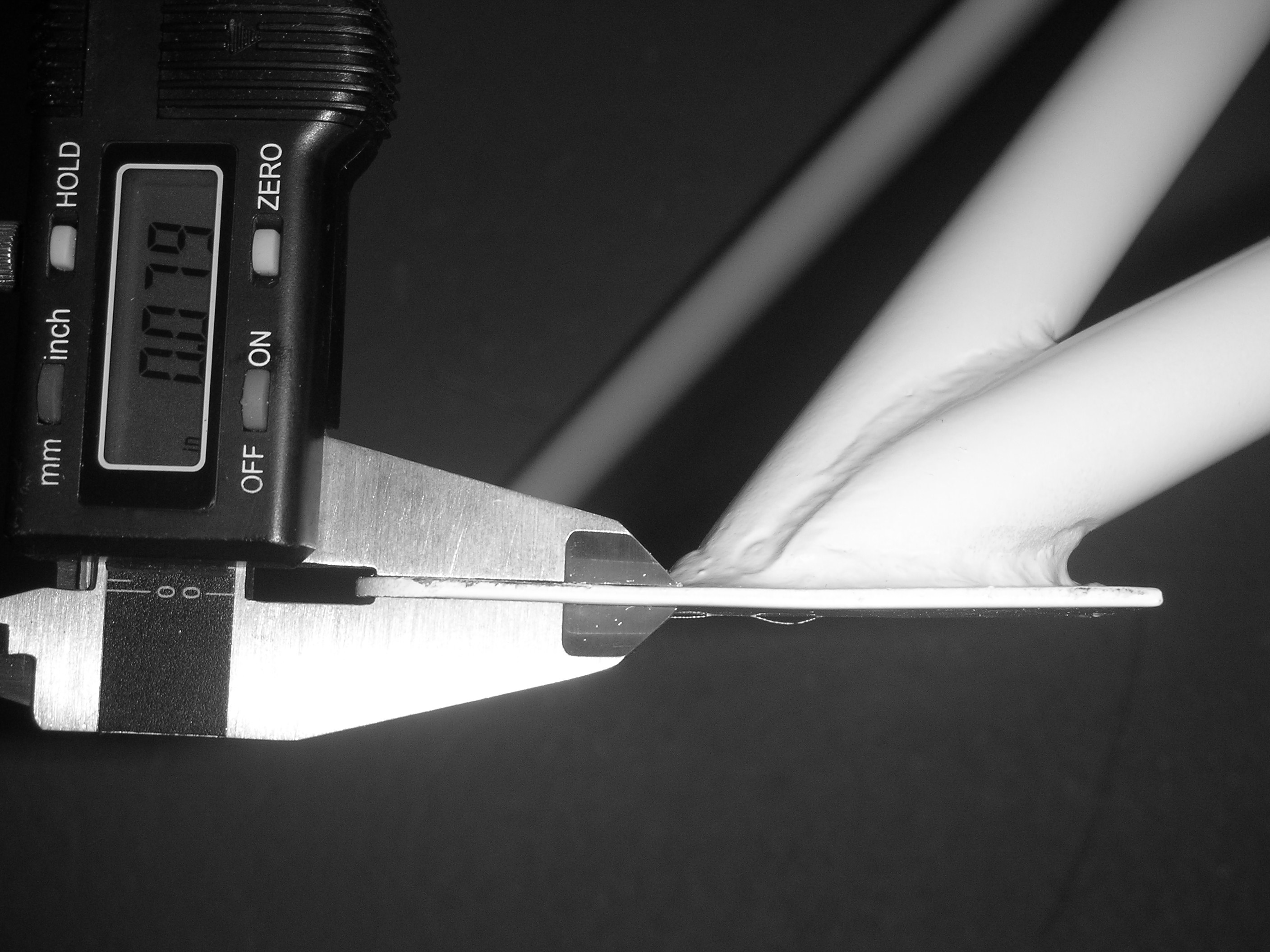

Looking at my Engine Mount for a 601xl [Supplied by Jab USA] and noticed the Firewall Attachment Plates are only 0.080” thick on the Upper L/H and both bottom plates. The upper R/H is 0.125” thick. On the drawing 6-JE-1 it specifies that all should be 0.125” thick. Has anyone else come across this anomaly Cheers

Here is a pic of the suspect Jabiru 3300 Engine mount attach plate
