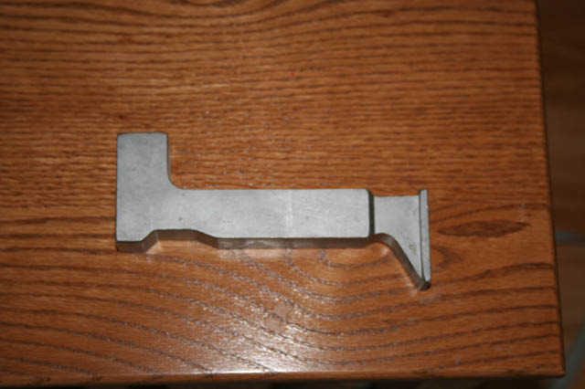

I’m in the process of finishing riveting the top wings skins, but I’ve run into a snag that I need assistance to overcome.
The area that I’m having difficulties are the rivets that go through the top wing skin and the rear spar, at the inboard end of the wing where the W-1007C doubler is located. This row of rivets seems impossible to reach. I can take a photo if that would assist anyone.
The problem is that because of the W-1007C doubler, you can’t get into the rivet with a back rivet set or any of the bucking bars that I have. I do have a couple bucking bars that are angled to get them into tight places, but they are still too thick in this instance..
Since there have been many going before me and I can’t seem to find any references to others having difficulties, I must be overlooking something obvious.
I tried using a chisel, but the results weren’t good. I could get the chisel into the back, but it push the rivet out and I wasn’t able to get the head of the rivet flat. I guess the other choice is to drill out the rivets on the W1007C doubler, rivet the skin, the re-rivet the doubler. But that sure would be a pain, with the ribs so close together.
I’m open to any suggestions at this point.

After a little bit of head scratching, it came back to me. I used the attached bucking bar on those rivets.
Eric Gohr

I remember that lots of cussing helped! I used a small 1” by 1.5” steel bucking bar that I have (which hurts like hell to use btw). If you haven’t already bought a tungsten bar I’d recommend shelling out for one. They are often small enough to get into tight places such as this.
