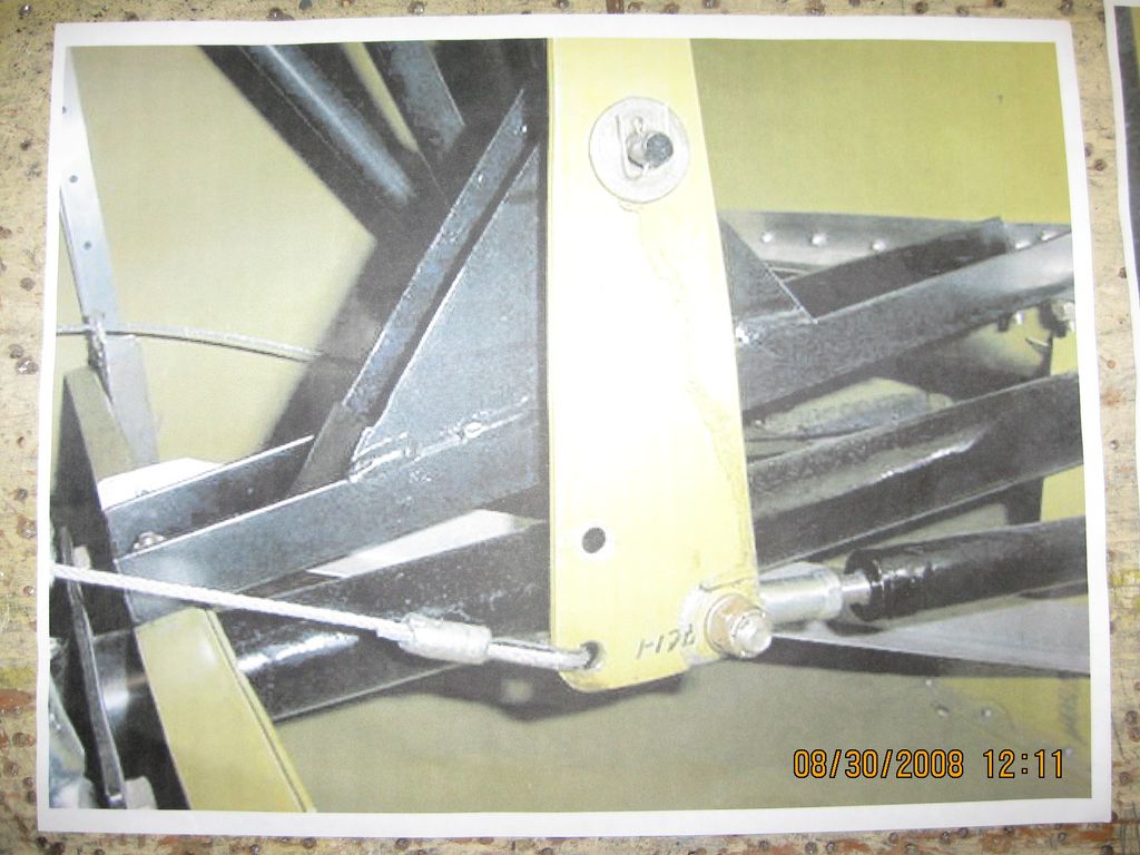

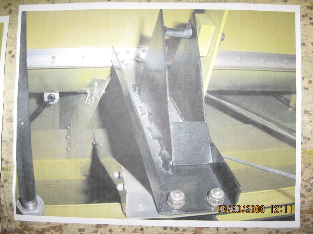

I was asked a little while back to post a few pic's of the modification, so here they are.
In the second photo, ( rod1 ) you can clearly see that the triangular plates were removed from the tube, and relocated to a reinforcement channel, over the original tube, thereby eliminating any interference between the two control surfaces, when either is moved.
Hope this helps
Bob the 701 & 750 Scratch
Three Rivers, Quebec.
