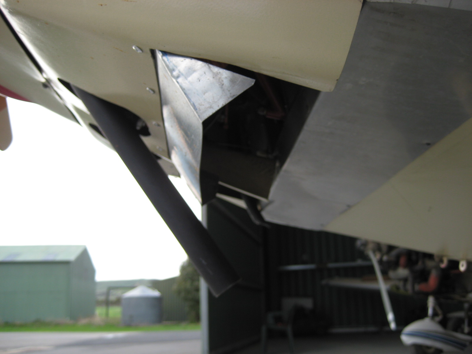

Michel
Posts: 966
Location: Norway
PostPosted: Wed Aug 27, 2008 4:56 am    Post subject: exhaust pipe clearance Reply with quote
From: bob noffs [icubob(at)newnorth.net]
also, any opinions on the effectiveness of a ''lip'' at the rear of the cowl
to pull air from the low pressure chamber of the cowl?
The best there is, Sir!
Here is a photo of my "lip" and it works like marvel to keep my Jabiru the coolest engine on this side of the galaxy! Smile
http://home.online.no/~michel/tmp/Heater.jpg

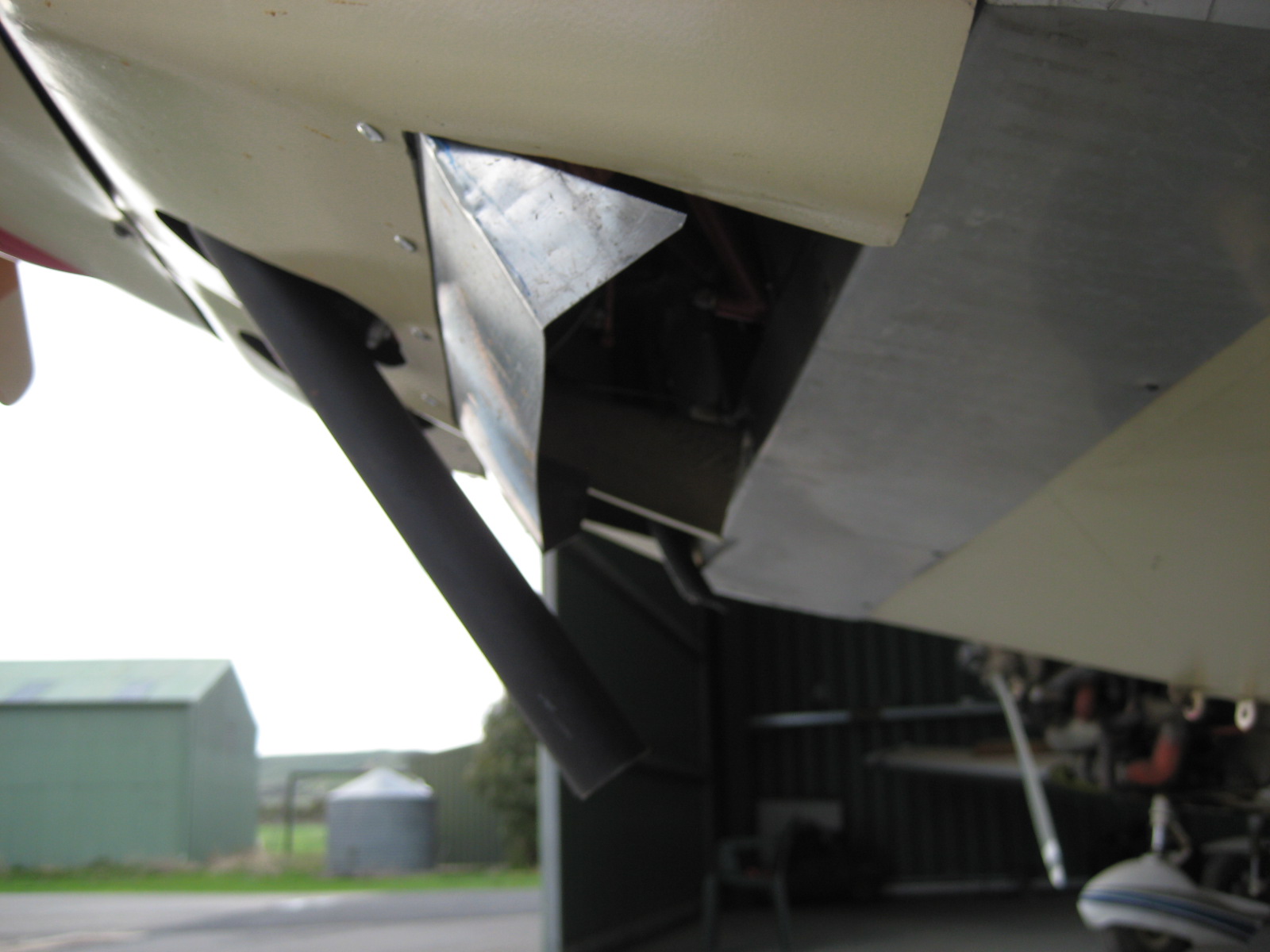

PostPosted: Wed Aug 27, 2008 6:04 am    Post subject: exhaust pipe clearance Reply with quote
I agree with Lynn on the cowl lip - I have even increased the outlet area under my Jab installation (Round Cowl) and fitted additional Aluminum lips to increase the pressure reduction (See Foto)

Michel
Posts: 966
Location: Norway
PostPosted: Wed Aug 27, 2008 9:56 am    Post subject: exhaust pipe clearance Reply with quote
From: gary.algate(at)sandvik.com
Size wise, yours looks pretty much like mine, Gary.
.. I mean ... well, you know what I mean! Smile
PostPosted: Thu Aug 28, 2008 4:24 am    Post subject: exhaust pipe clearance Reply with quote
Michael
As you know - Size really does matter
Gary
