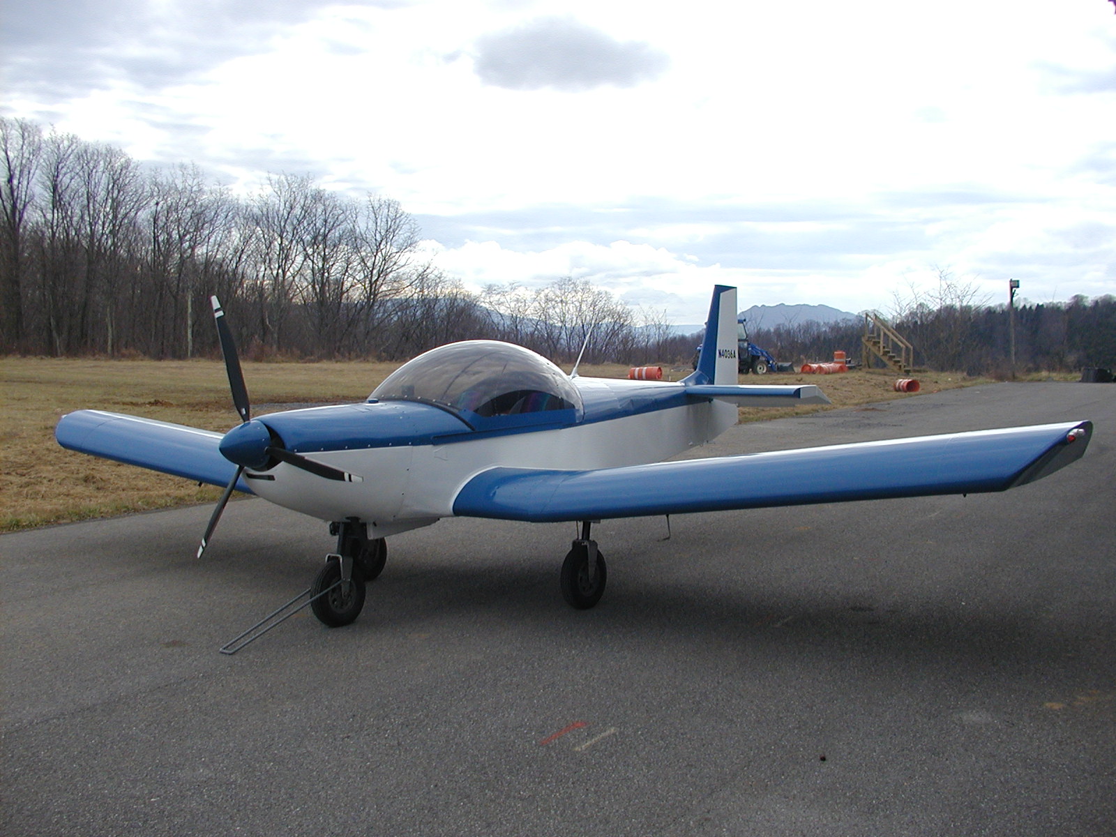

I used rust-oleum primer and paint rattle cans for the whole plane. It is still on after 3.5 years. I did do what Dan did as far as scuffing the surface and washing it down with lacquer thinner before priming. Everyone that has seen the plane cannot believe I did the plane with rattle cans. I am not an expert painter by any means but it came out looking pretty nice. (see pic) Inexpensive too.
John
