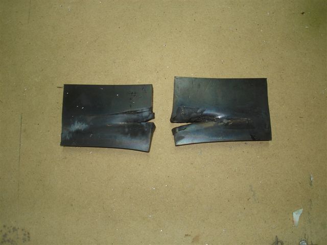

I started my annual today and found a couple of things that might be of interest to you. Actually, I found one of them a week ago, but started working on it today.
Landing Gear.
1. 7L2-2A RUBBER SPACER. - Attaching a picture. You might want to include this in your inspection. This is our third rubber spacer. I think I'm going to find a 6-ply radial tire and cut me a length of material to support the gear.

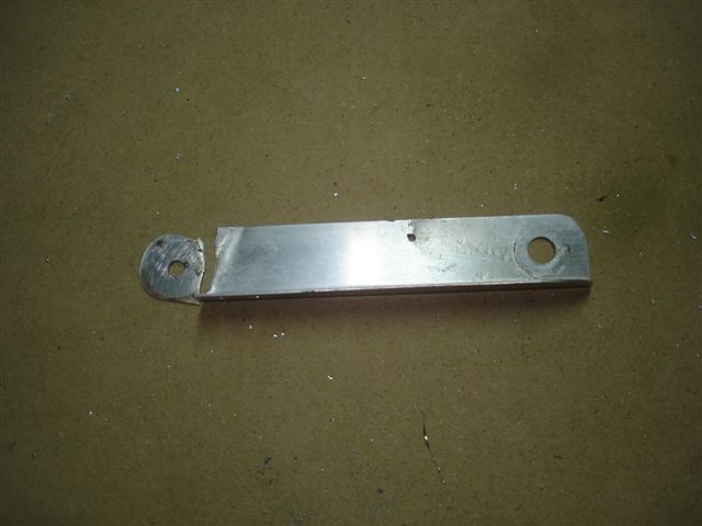

2. 79-SB Rotax engine Radiator mount.
Obviously I did not have the needed radius for the bend in this mount. I am fabricating a new mount with the required 1/8 " radius.

Tommy,
I just replaced mine with pieces I cut out of a truck tire, this has been my 3rd time with pieces of rubber. I hoe this will be the final solution.

Tommy Walker
Joined: 12 Jan 2006 Posts: 442 Location: Anniston, AL 36207
Posted: Tue Aug 26, 2008 2:14 pm Post subject: Re: Annual Condition Inspection |
Hi Bob,
I am going to find a good tuff truck tire and cut me out a couple of pieces of material.
What did you cut the rubber with?
Was it a steel belted radial?
Tommy

Joemotis(at)aol.com Guest
Posted: Tue Aug 26, 2008 3:08 pm Post subject: Annual Condition Inspection |
A sabre saw with a medium blade works quite well, although the pieces that I was cutting (roughly 4"X 4") were used as buffers on a Catapult to launch melons!!! A piece of plywood backing secured through the sidewall with drywall screws will allow a lot more creativity in your shape/design, though.
(Cutting through both at the same time and being patient)
Joe Motis

NYTerminat(at)aol.com Guest
Posted: Tue Aug 26, 2008 6:34 pm Post subject: Annual Condition Inspection |
Tommy,
Yes it was a steel belted tire, used a sawzall to get the chunk of tire apart ad then used my bandsaw to cut to size and shape. Thanks for your reporting on the subject.

beachyjeff(at)juno.com Guest
Posted: Wed Aug 27, 2008 3:53 am Post subject: Annual Condition Inspection |
On the advice of a fellow builder, I went to the nearest Caterpillar heavy equipment dealer and bought a short section of heavy hydrolic hose, which I cut in half lengthwise. I then cut pieces to fit the landing gear bracket. 138 hours later they haven't slipped out or worn through. The curve of the hose helps keep them in place.
Jeff Beachy

cffd(at)pgrb.com Guest
Posted: Wed Aug 27, 2008 9:22 am Post subject: Annual Condition Inspection |
Tommy,
I sliced open large diameter auto heater hose and made landing gear spacers,
for top and bottom of gear.
They have been in place a couple of years and no signs of deterioration.
Chuck D.
