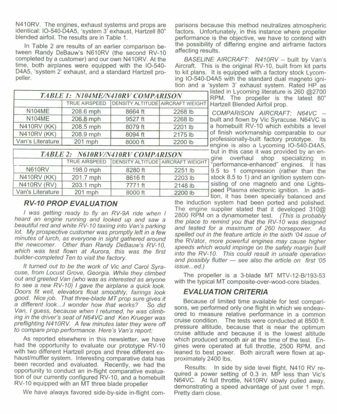

A few years ago there was the Vic Vans and Randy vans comparo..around the same altitude.
I attached the sheet
Pascal
