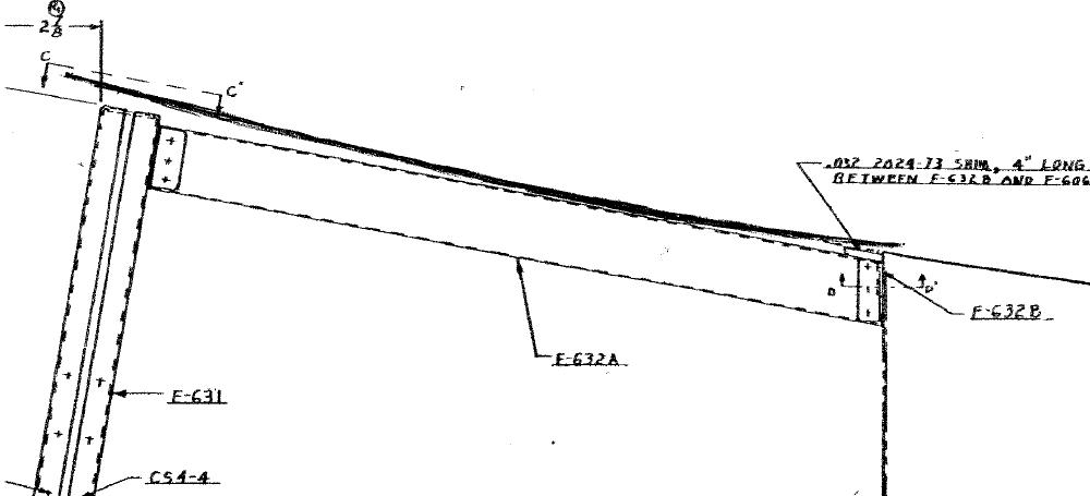

I have trimmed my tip-up canopy to the point where it should fit.
The problem is that it still sits about 3/8" above the roll-bar (F631)but
the bend (sag)in the rear top of the canopy already touches F-632A.
I will attach a sketch.
All the measurements and spaces are correct.
1. Can the canopy material be heated to flatten out a bit?
2. Should I drop F-632A (glecoed at this stage)?
Any suggestions out there?
