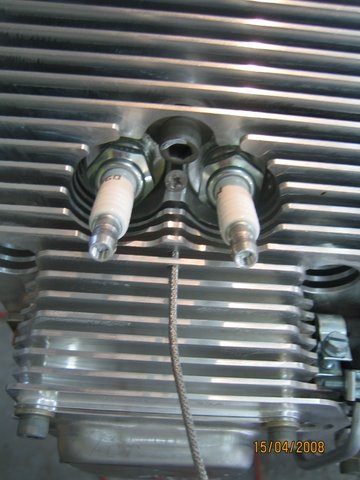

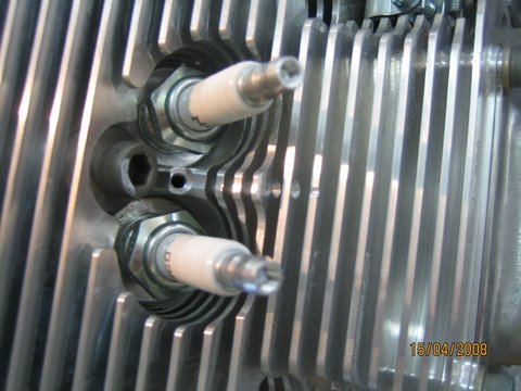

Hi Ron Shannon,
What I did Ron was use the hole in-between the two spark plugs to place a 10/32 screw.
I then drilled a hole 1/8 to slide the probe into, then fasterened it with the screw.
I called Jabiru here in OZ and they said the hole can be used for this purpose or was some time ago.
The reason I went this way was that the ring dia. for the sparkplug is too large and did not fit good in my opinion only.
I did need to remove the rings carefully from the leads which went well and they do record well also.
Pictures attached.

Another good idea Pete, I'm assuming the end of the T/C is what you find when you cut it out the crimp? Do you do anything to it?

No CJ. I just take the ring off the wire and there it is the pair joined as they should be. I then poke the pair of wires it inio the hole that I drilled to the depth where the screw will pick it up and hold it in position, done job, too easy.
