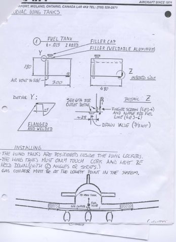

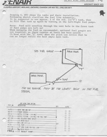

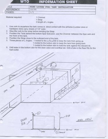

Here is the documentation that I got with my wing locker tank kits for my
HDS.
Jerry
 Filesize:  30.2 KB
 Viewed:  301 Time(s)
 Filesize:  29.32 KB
 Viewed:  302 Time(s)
 Filesize:  27.48 KB
 Viewed:  312 Time(s)

Dick, I just went and looked at my fuel system. The 4 hole funny looking gasolator that you talked about is the one supplied with the locker tank option. You have a drain hole, an outlet hole, and 2 inlets, one for each tank. I have this one mounted behind the pilot seat. This is the lowest point in the fuel lines from the locker tanks. There is a second gasolator supplied with the original kit and it mounts to the bottom of the firewall and has three holes; one inlet, one outlet, and the drain.
Hope this helps
Sorry about my confusion.
Jerry
