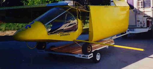

One problem in tailoring on the landing gear is the shock associated with bumps in the road being transmitted directly to the aircraft. The trailer I built extended only a foot or so past the tail, and only went to the main landing gear on the other end. I pull the plane backwards and have a pedestal to mount the tail boom on. It was built so I could pull the plane onto the trailer. The axel I found was for 1000 lb.. so I removed one of the leaf springs, giving the plane a smother ride. The trailer was built with 2 mounting locations for the axel and a removable long extension to the front. That way I can use it as a utility trailer or to haul the plane. The 2xd6’s on the trailer deck fit in the spaces just under the main gear and are used for ramps.
Boyd
