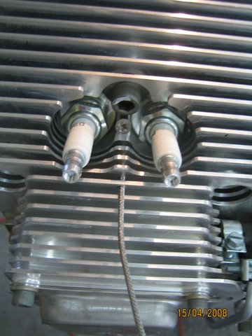

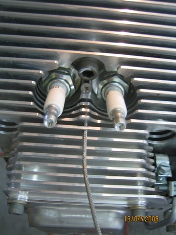

Hi Ron Shannon,
What I did Ron was use the hole in-between the two spark plugs to place a 10/32 screw.
I then drilled a hole 1/8 to slide the probe into, then fasterened it with the screw.
I called Jabiru here in OZ and they said the hole can be used for this purpose or was some time ago.
The reason I went this way was that the ring dia. for the sparkplug is too large and did not fit good in my opinion only.
I did need to remove the rings carefully from the leads which went well and they do record well also.
Pictures attached.
Pete Disher
kit 30
VH-PDI
OZ
You have been sent 2 pictures.

Another good idea Pete, I'm assuming the end of the T/C is what you find when you cut it out the crimp? Do you do anything to it?

No CJ. I just take the ring off the wire and there it is the pair joined as they should be. I then poke the pair of wires it inio the hole that I drilled to the depth where the screw will pick it up and hold it in position, done job, too easy.
