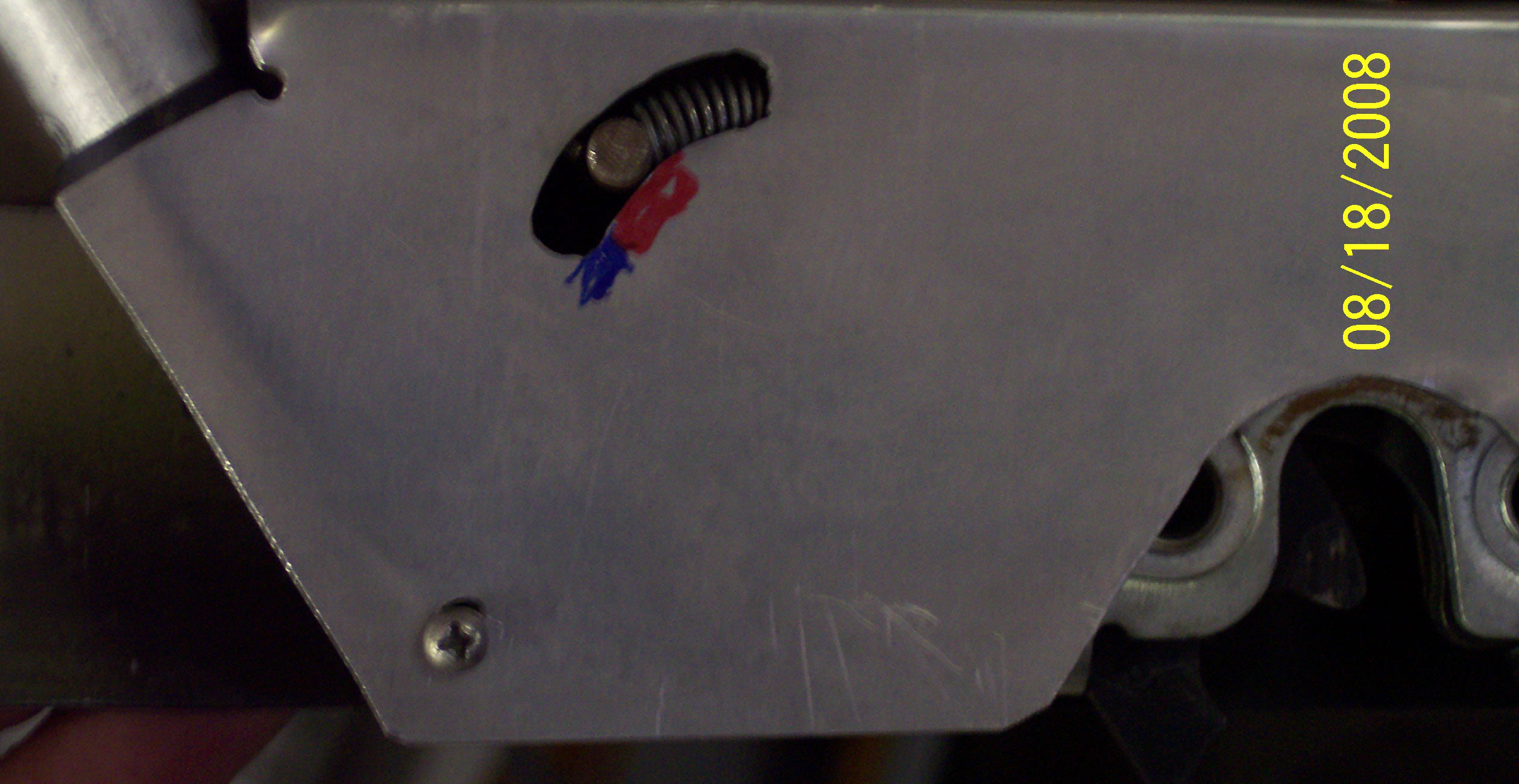

When the XL first was shown at Oshkosh I had not begun the fuselage on my 601HD. I decided that I did not like the side opening canopy because of reported openings and losses in flight. I remember asking when I was sitting in the display plane how I could open the canopy if the cable broke. I was told that I could insert a key of similar object into the small arc like openings by the latches and open the latch. When I build the built the canopy system for my plane my thought was that in an emergency if the cable doesn't work the last thing I want to have to do is to look for a key or something to stick in that hole. My solution was to make the pins longer so they protrude out. This serves two purposes first if the cable breaks or just doesn't work you just reach over and press the pin forward to release the latch and second it is very easy to tell if is properly latched. The attached picture shows the left side when the latch initially closes it will still be in the red when the final catch engages it is in the blue (I didn't have a green sharpie). Before takeoff I check each side this usually means the passenger has to lean forward but I always give it a firm press and make sure it is all the way to the end of the slot.

I made the access holes big enough to stick my finger into and release the lever – about 1 inch tall by 1.5 inches wide. Not as pretty but my fingers are always at hand.

agreed, that pretty much what I do prior to take off as well. Once latched well, unless the person has lots of elbows, it stays shut.
