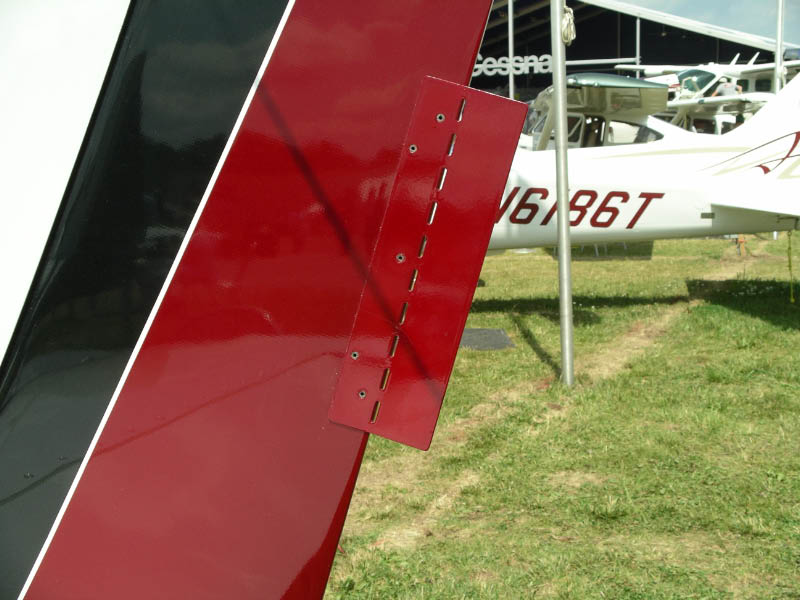

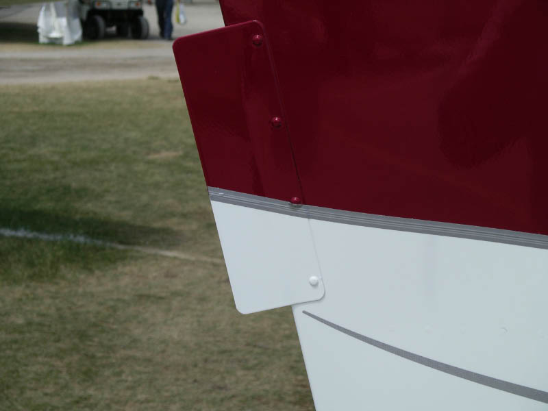

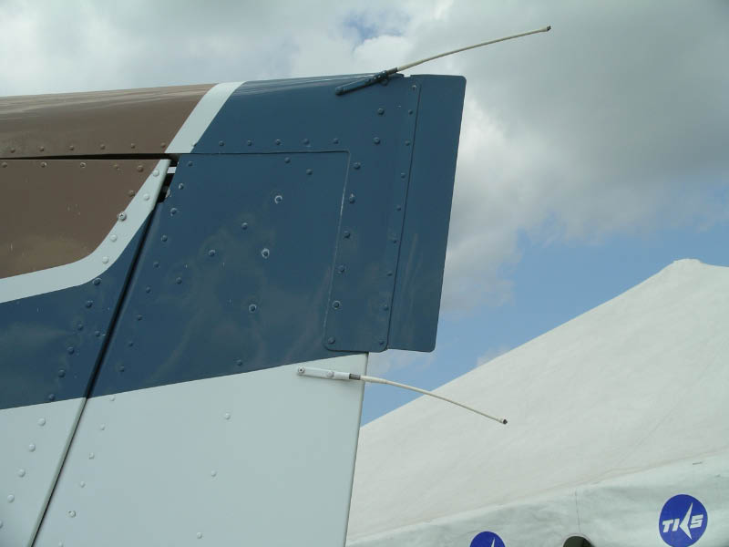

I went to AirVenture with the intention of building a servo controlled rudder trim system into my rudder as I complete it. AirVenture gave me a good opportunity to look at the different implementations on flying RV-10s. There were quite a few. I stopped by Van's tent on several occasions and asked two different employees (those I consider two of the most knowledgeable) what Van's view is of servo controlled rudder trim. Both replied (independently of course) that it is not needed. That left me wondering about the rudder trim on commercially built, high performance aircraft. What better place to find out than to stroll over to the commercial exhibits. Here is what I found.
[img]cid:part1.06080908.01090301(at)eskimo.com[/img] The Bonanza has a 2.25" by 11" trim tab held onto the rudder by a comparable sized strip of aluminum on each side riveted to the rudder and to the trim tab.
[img]cid:part2.01030908.05090104(at)eskimo.com[/img] The Cirrus has a 2.5" by 8" tab riveted to one side of the rudder.
[img]cid:part3.02030405.01080004(at)eskimo.com[/img] The Columbia/Cessna 350/400 has the trim tab riveted to one side of the rudder. It is also slotted as shown in the picture.
After talking with several Mooney salespeople, I was told that the airplane has a servo that is linked to the rudder control rod in a manner that effectively changes its length providing a trim effect. I was told by Cessna salespeople that the Skylane uses a servo and spring arrangement to adjust the tension on the rudder control cables. Thus there are a variety of methods used by the commercial manufacturers, almost as many as used by RV-10 builders.
Upon reflection, I have decided to rivet a tab, size yet to be determined, to one side of the rudder. It is a simple, inexpensive, ground adjustable solution in use by a number of high performance commercial airplane manufacturers.

I flew with a fixed tab taped in place for over 200 hours. It certainly was effective, however I ended up going with a cockpit adjustable tab as I found the trim required was inconsistent. You can probably find some previous threads in the archives, but one prominent theory is the nose wheel doesn’t always center after takeoff leaving a slight yaw input. I can’t say for certain, but no matter how I set the fixed trim tab it would work great on some flights but on others I’d be leaning on the rudder pedal slightly for over 2 hours and I got tired of it. I don’t mess with the adjustable tab now very often, but it’s handy to have when I do need to make a slight change.
Marcus

For what it's worth, (probably nothing), I agree with both ends
of the discussion. I flew for what, maybe 285 hours, with a stick-on
trim wedge. I wasn't totally displeased. It worked OK, and did get
rid of 90% of the out-of-trim on the rudder. My position these
days is that adjustable trim is great, and if you plan an electric
version, do yourself a favor by at least pulling wires for it while
you assemble the tail for final assembly. But I never called it a
NECESSARY option to have adjustable trim. I think that some people
will be plenty satisfied without it.
The rub comes, as Marcus points out, that the trim isn't always going
to be consistent, and depending on speed, altitude, loadings, or
whatever, you may want more or less trim. Certainly on a 9 hour
flying day, I got annoyed by keeping my foot on the pedal for hours
on end....so that the plane would not fly in a slight bank. Yes,
if your rudder trim is out, you will have a low wing with the Autopilot
on.....and as you get cozy and used to your plane, you will notice
that effect and over time it gets more annoying to hold your foot
there on the pedal.
I'm also all for the actual aerodynamics of actually trimming your
rudder with an adjustable tab, just like you do with the elevator.
I think it gives the most real trim effect that puts things into
that comfortable equilibrium just like when you trim out the elevator.
The aileron trim in the RV-10 is spring/servo driven and although
I feel it is plenty good for the 10, it does feel like more of
a "hack" than truly trimming....and it does add some spring
tension to the controls. Is this bad? Not really....and I don't
think that it would be so bad to do a mechanical trim on the
rudder, either. Both can get the job done just fine. If it
weren't just so simple to throw the servo in the rudder, certainly
I'd be attracted to the other methods too, but I can't imagine
being as satisfied in the end as right now I'm completely satisfied...
especially when coupled to Bob's "Safety-Trim" so I have the fast/slow
speed settings. It's a completely non-interfering way to accomplish
the job.
As for Van's opinion.... Sure, I'm positive that they'd say "nah,
it's not needed to have adjustable trim." We've all learned what
the Van's style is...simple, cheap, and VFR. The catch is, many of
us want slick, comfortably, advanced IFR aircraft. So our opinion
isn't really the same all the time. With something like rudder
trim, it doesn't matter so much if you pick a side, or have a
strong opinion....it's not one of the biggest issues you'll face.
But, it IS one of the things that is easier dealt with BEFORE
you are flying than after. Unfortunately, it probably isn't
until you have 60-80 hours on the plane, including some good long
X/C time, until you'll actually SEE what your opinion actually is.
There's nothing like droning along in your RV-10 for some good X/C
time, reflecting on your choices, to understand if those past choices
and opinions were on the mark or not.
[img]cid:image001.jpg(at)01C9009F.59C03AA0[/img]The Bonanza has a 2.25" by 11" trim tab held onto the rudder by a comparable sized strip of aluminum on each side riveted to the rudder and to the trim tab.
[img]cid:image002.jpg(at)01C9009F.59C03AA0[/img]The Cirrus has a 2.5" by 8" tab riveted to one side of the rudder.
[img]cid:image003.jpg(at)01C9009F.59C03AA0[/img]The Columbia/Cessna 350/400 has a 3" by 10" trim tab riveted to one side of the rudder. It is also slotted as shown in the picture.
Dave
