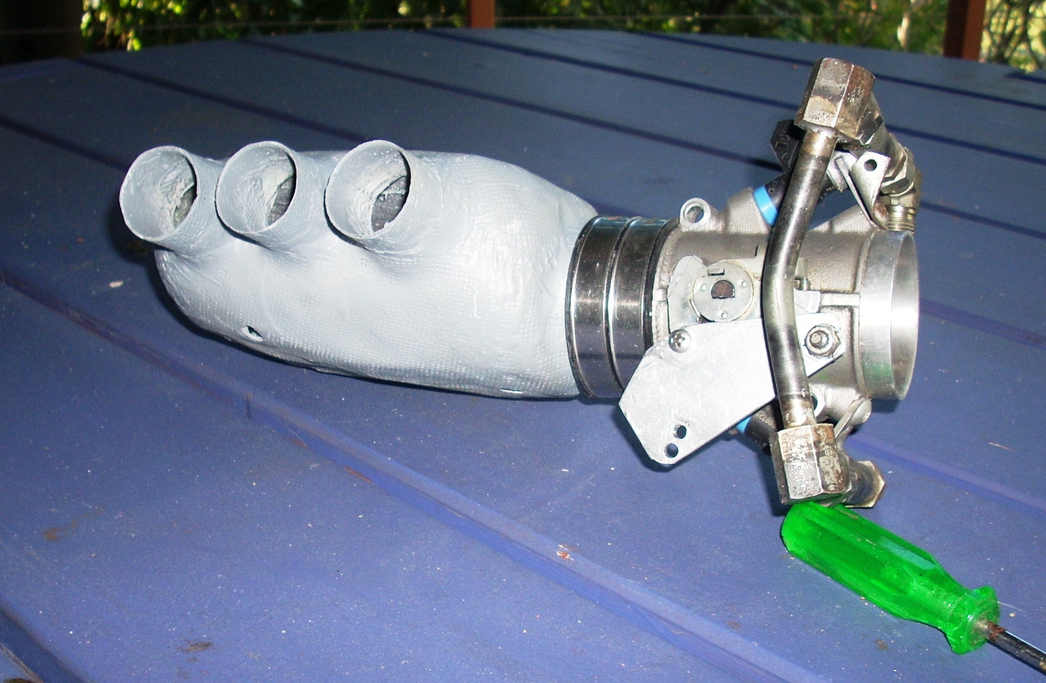

I blame the lack of a plenum. The carb is fitted direct to a collector which
is very restricted inside. Even the entry is restricted.
I have made a 6 port plenum in fiberglass (pic attached) and hope that this
will improve the fuel/air distribution. Ideally it would be an updraft
design but I don't have the space.
