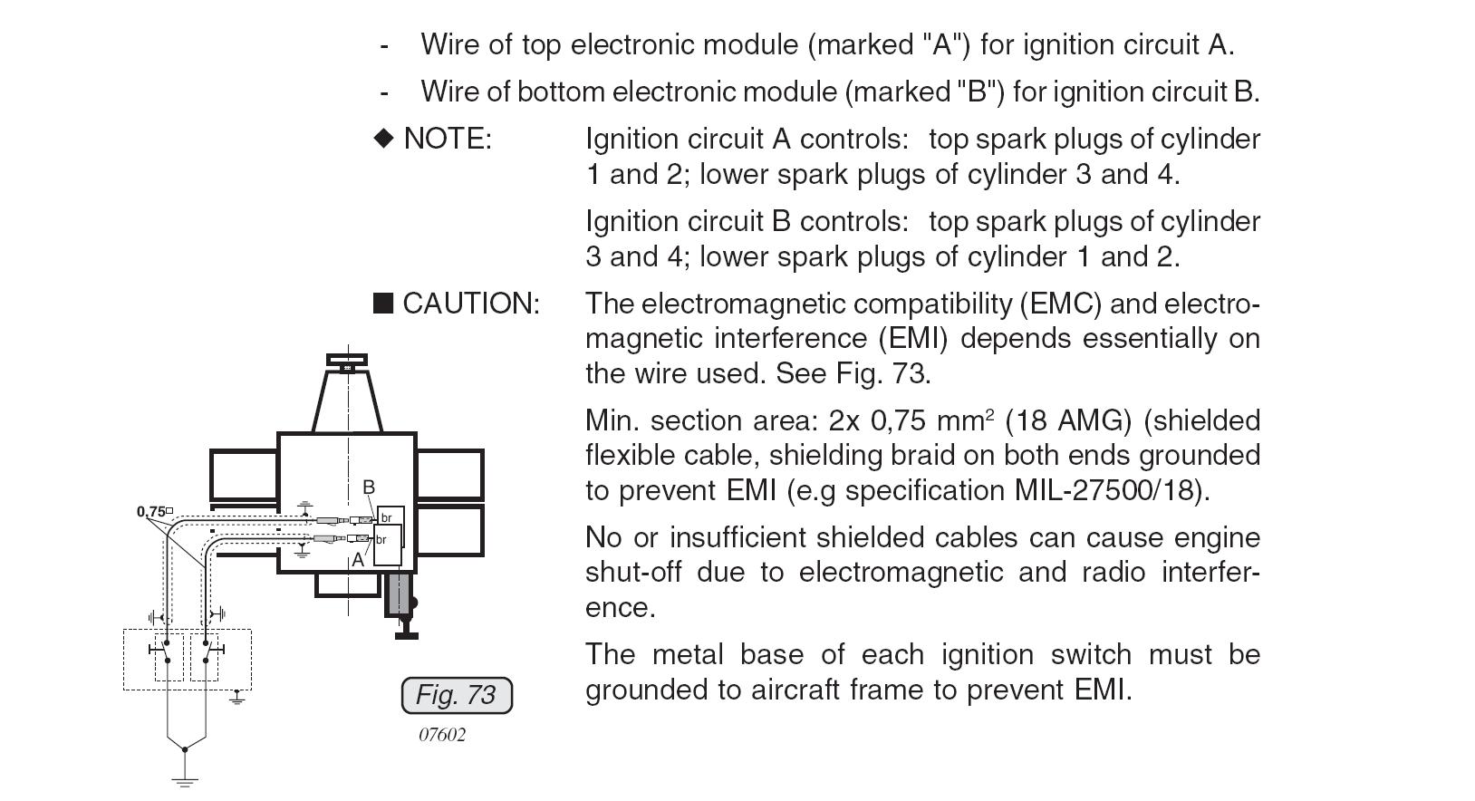

ami(at)MCFADYEAN.FREESERV Guest
Posted: Thu Sep 18, 2008 11:59 pm Post subject: Rotax 914 |
Yet the Rotax manual (later versions) show grounding of the shield at both ends, with a statement to the effect that their EMI compliance is not maintained otherwise.
Duncan Mcf.

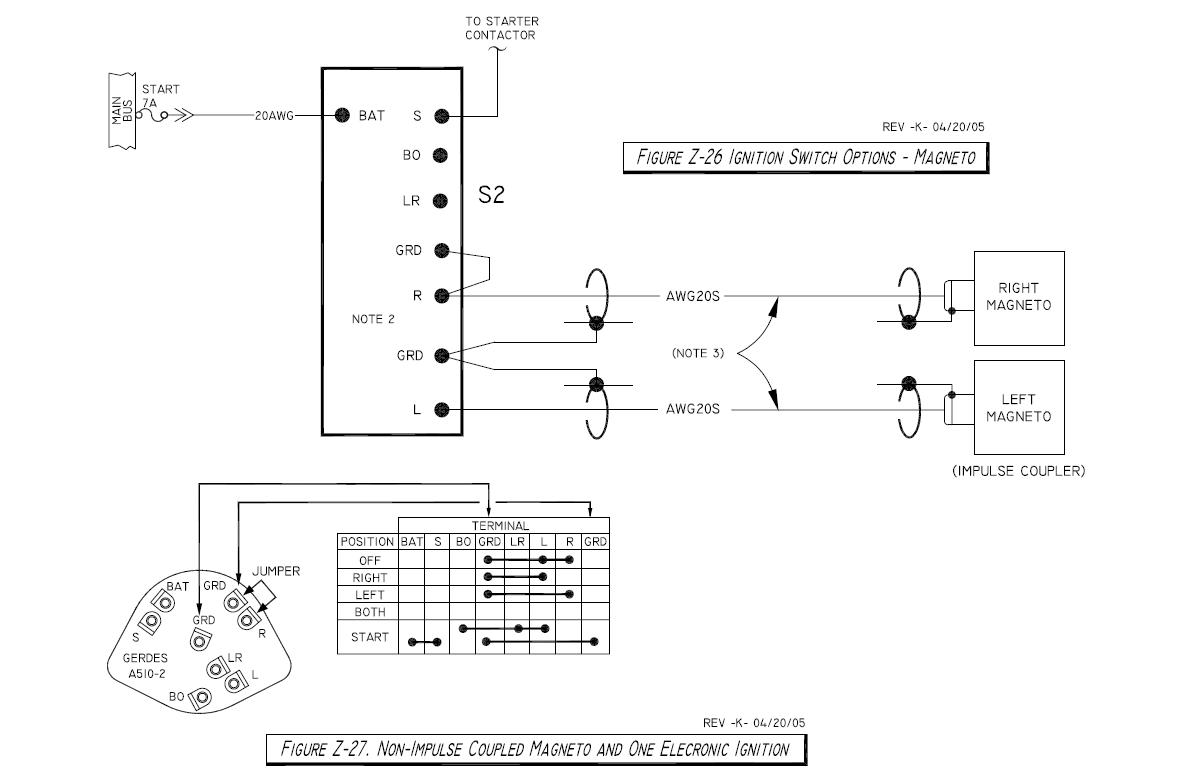

craig(at)craigandjean.com Guest
Posted: Fri Sep 19, 2008 12:21 am Post subject: Rotax 914 |
Does it actually show the shield grounded at the switch or is the shield just connected to a terminal on the switch? The common off-left-right-both-start switch from Aircraft Spruce has terminals on it labeled “GRD” which the shields connect to. But they don’t actually connect to the metal frame of the switch case. They are just the terminals that the switch connects the P leads to when killing that half of the ignition. I’ve attached a snippet from diagram Z-27 in the AeroElectric update on page 30 at the link below. The table shows what actually happens inside the switch.
https://matronics.com/aeroelectric/articles/Rev11/AppZ_R11M.pdf
-- Craig

Float Flyr
Joined: 19 Jul 2006 Posts: 2704 Location: Campbellton, Newfoundland
Posted: Fri Sep 19, 2008 7:22 am Post subject: Rotax 914 |
That is probably true but coax is an unbalanced feed cable grounding at both ends will enable the whole wire to become a capacitive radiator. Capacitors as you know pass AC and block DC the problem is the current feeding the P-Leads is AC. Grounding at the engine end only allows any induced AC into the shield to be grounded rather than swing back and forth in the shield. The only exception to the rule is for antennae. The feed end (radio) of the coax is grounded to the case of the radio and the far end of the coax should have an good ground to form a ground plane for the antenna radiator. In that case the ground part of the antenna end should be very clean. A lot of problems with com radios rise from corroded ground terminals at the antenna end. That is one of the first things I will check when there is a radio problem in an airplane. A bad ground in that location can cause other physical problems within the radio itself. The same thing is true for other avionics. Good clean grounds and shielded cables grounded at the source end only.
Rotax may have specified double grounding because of bad grounds across the engine mounts. That could have caused the P-Lead not to work properly. It is my personal experience as a Canadian AME intern (Aircraft Maintenance Engineer) with specialty training in avionics and an Amateur Radio operator with an advanced licence for over twenty years, that 90 % of electrical and avionics problems are due to bad grounding. The general rule of thumb is to ground closest to the source. This grounding at one end only should continue throughout the full avionics suite. Perhaps if there is someone from the Rotax design team on line they could let us know why they spec double grounding of coaxial cable.
Noel

Float Flyr
Posted: Fri Sep 19, 2008 8:07 am Post subject: Rotax 914 |
You’re spot on. The shield is only grounded at the switch end when the mag is turned off. Fig Z-11
Posted: Fri Sep 19, 2008 1:14 pm Post subject: Rotax 914 |
Except that the Rotax manual shows a different set-up, with each end of the screen grounded, the switch body grounded and the centre-conductor of the shielded wire switched to a separate ground when the kill-switch is closed. The descriptions in the text of the manual confirm the indications of the diagram.
Hey, don't shoot the messenger; Ask Rotax how they got it "wrong"!

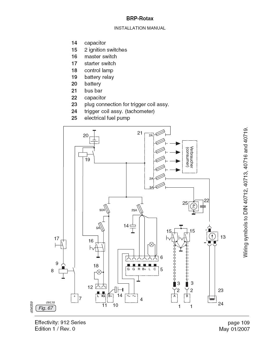

Posted: Fri Sep 19, 2008 1:43 pm Post subject: Rotax 914 |
Do you mean figures 67 and 73 from the installation manual (or the equivalent)? I’ve attached a copy of each. They certainly do appear to be grounding both ends of the shield in figure 73.
-- Craig
-- Craig
Duncan Mcf.
Duncan McF.
-- Craig
-- Craig

FWIW, I wired one 914 and one 912S engines as per the Rotax installation
manual with good results.
At the time I too was a bit puzzled by the Rotax suggestion to ground
the shield at both ends, but after much reflexion decided to wire the
ignition by the book.
Worked flawlessly.
Some info here
http://contrails.free.fr/engine_rotax_mag_connect_en.php
Best regards,
Gilles
