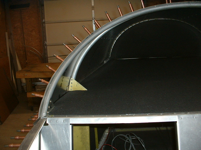

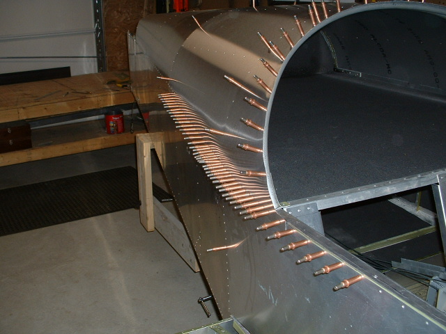

All-
OK, here's how I did it. This is assuming you already have the hoop holes and the formers drilled:
1. Cleco everything you've got holes for. Leave the last foot or so foreward of the mid top undrilled.
2. Install the cockpit side.
3.Work the "Bubble" out of the mid top aft to front. Drill and Cleco the center of existing holes afterwards. Pitch 20 or 30 by the time you're done doubling. Zero gap at the hoop a necessity.
Bill Naumuk
Townville, Pa.
HDS 601MG/Corvair 95%

Excellent Bill!
You finally beat it into submission. Congratulations.
Looks really good!
