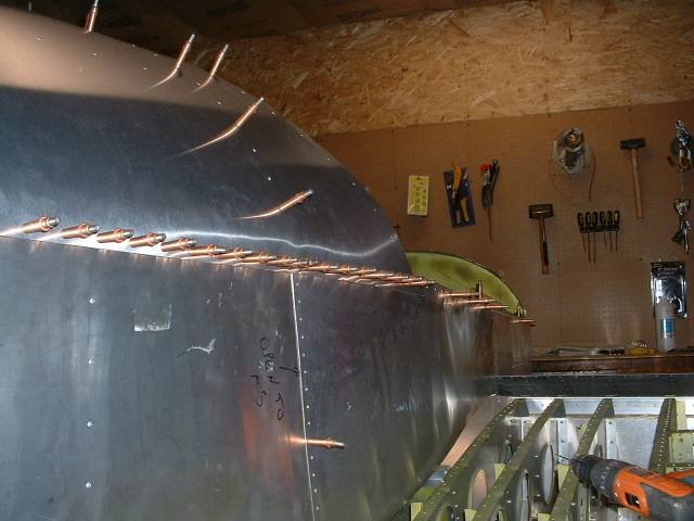

This is what I wound up with. It might look a little prettier if I lapped the side skin over the mid top, but this follows plans.
All I did was put the side skin on over top of the mid and work aft to front pushing out the "Bubble", then swapped over/under. I still haven't doubled up on the rivets, so it might wind up looking better.
Optical illusion in the area between the front hoop and the longeron- no distortion there, or at least there won't be after riveting. What looks like garfs in the left side of the picture are duct tape adhesive marks.
Bill
