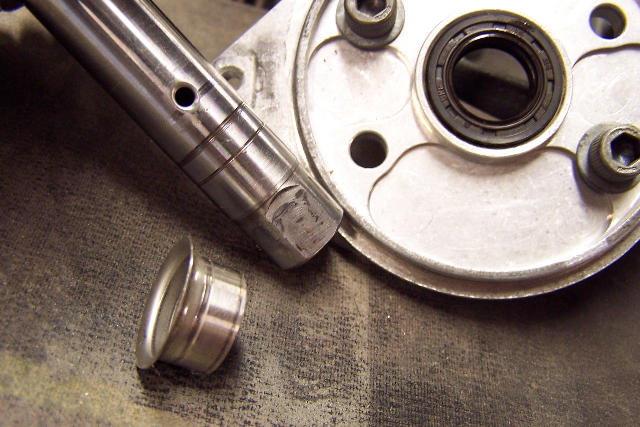

I began gluing the rotors on after I got over being stubborn about
NOT doing it....I had a couple start flopping around, and finally
figured maybe Jabiru knew what they were talking about, even though
it sounds ridiculous.

I have the fully machined cam....no signs of it being a casting in
any way, as compared to all the cams I've seen in my life. It is the
only other cam I've seen that WAS fully machined besides a roller
tappet cam that I once had in a Hemi.
Gary, if you would, please ask Wayne why doesn't Jabiru make the
timing gear on the crankshaft fit with a slip fit over the end of the
crankshaft, instead of it being squeezed between the end of crank and
the flywheel? That way the nose of the crank would absorb the load
behind the crank gear, instead of it being just hanging there in
space so to speak. Also, ask him if the addition of Loctite 620 or
some other suitable product would be recommended to use to fill the
space between the nose of the crankshaft and the inside of the
crankshaft gear, right behind the gear teeth. I'm concerned about
this seeming space back there, and having another gear failure.
Perhaps the gear does bear up against the crankshaft at that point
but I can't tell because my gear doesn't show contact there...at
least as far as I can tell looking at the broken pieces.

I also spoke with Wayne Johns (Jabiru Service Tech) again and he
asked if you were "gluing" the rotor buttons onto the spindles in
the Distributor. Evidently it was found that if the rotor buttons
aren't fitted with an epoxy or cicoflex they would wear slightly
and then rattle on the spindles. This can result in a harmonic
vibration thru the gear train that wears the drive gears. In a few
cases the hard case was worn from two areas of the teeth resulting
in failure.
1 last point - do you have the cast cam shaft or the machined cam
shaft - on earlier engines the cast camshaft was found to be weaker
and it was replaced with a fully machined component. When I was
considering updating my engine S/No 340 he told me that i should
upgrade to the machined cam shaft! - maybe something to consider.
By the time I looked at the cost of upgrading my engine it made
more sense to go for a new (0) time replacement. Not that I had any
problems with mine.

--> Kitfox-List message posted by: Lynn Matteson <lynnmatt(at)jps.net>
I gotta say that Jabiru can point to every drop of flys**t that lands
on the engine and claim that that's what caused the problem! For
example, they say that my problem might have been caused by the
extra clearance on the drive pins on a Sensenich propellor. Yet
Sensenich claims that the prop is not driven by the drive pins/lugs,
but by the torque of the bolts which creates a friction between the
drive flange and the back of the prop. Jabiru has you check the
torque every 100hrs, while Sensenich wants it done every 50 hrs. If
Jabiru was so concerned about this prop issue being a problem, why
don't they warn you to check torque more often? Nuff said about that
for now.
I'm also pondering the feasibility of going with a reconditioned
engine, but I'd rather put this one back together and let it prove
itself.

On Aug 11, 2008, at 8:01 PM, gary.algate(at)sandvik.com wrote:
> Damn - I thought I might have been on to something!
> in failure.
> problems with mine.
> Like most experimental engines (including Rotax) these engines
> continue to evolve - I think this is why the more traditional Aero
> engines still look the same and basically operate the same as they
> did 40 yrs ago.

PostPosted: Wed Aug 13, 2008 5:39 am    Post subject: Timing gear Reply with quote
They say that the only people on the groups/lists are the ones having
problems, the others are out flying. I seem to have a lemon of an
engine. First a distributor shaft seal wore a groove into one of the
shafts, causing an oil leak that saturated one of the caps, then the
rocker arm bushings went to hell, now the timing gear breaks, causing
me major engine work.
In every case, I got the "rare and unusual" answer back from Jabiru.
So now I just rebuild and fly and hope others don't have the same
problems.
My ownership of this engine got off on the wrong foot when one engine
out of a shipment of 7 was impaled on a fork lift. That engine was
sent back to Aussieland for repair, and I was sent a different
engine, so maybe that started the whole "jinx" thing. : )
John's engine suffered bad valve guides, and he had them replaced,
but they used the old valves, then a valve head broke off, so I'm
going to have my guides replaced and go with new valves.

Lynn, I am not sure the general Kitfox audience is interested in this but ... here I go:
From: Lynn Matteson [lynnmatt(at)jps.net]

It is a flexible seal, made of...I dunno, neoprene or something like
that, and it definitely wore a groove in my shaft. Pictured is the
shaft, with the 2 grooves worn in by the seal, which you can see in
the distributor bottom plate...this is the part that the cap attaches
to. To change the seal, you need to remove the two socket-head cap
screws (also known as Allen bolts over here, after a company that
made them), then remove this plate and drive out the old seal and
press/drive in the new seal, and you're done...well, except for
putting it back together.
But...if you have a worn/grooved shaft like I did, I had to use a
product called Speedi-Sleeve (pictured), which is slid over the
shaft, becoming the new surface upon which the new seal rides. The
sleeve is only .011" thick, so it only increases the diameter of the
shaft by .022" or about half of a mm. This increase in diameter not
only provides a new seal surface, but it increases the tension of the
new seal so it seals better. Mine worked right up to when I took them
off when I dismantled my engine, and I'm thinking of putting them
back on. Now as to why these seals leak, and I'm afraid yours are
going to show worn shafts too, Michel, I'm thinking they don't have a
hard enough shaft to begin with. When/if you pull your bottom plate
(s), don't be alarmed about the sloppiness of the distributor shaft
if you pull the distributor shaft support tower (I call it that)...it
won't get out of time, because the gears will still be in mesh, just
loose until the tower/support goes back on. You can't screw anything
up by taking this area apart and changing the seals, or by installing
the speedi-sleeves. You cannot get the engine out of time. But if you
decide to change the distributor shafts themselves, you will have to
remove the gear case cover, and THAT'S where you can get into trouble
with ignition timing. I can get you through this if you get that far
into it, or so can your Jab dealer friend over there.
It's surprising to me how the soft seal can wear a groove into the
shaft, but here's living proof that it did. My left (port) one is
pictured. The right side leaked worse, but the shaft was unharmed by
the seal...go figure that one out!
Lynn Matteson
Kitfox IV Speedster
Jabiru 2200
Status: "Condition grounded, but determined to try." (Pink
Floyd..."Learning to Fly")
