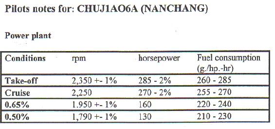

Folks,
I'm finishing a checklist for a CJ-6A that has the 285 in it for a friend. With my conversion to the M14P, the engine/yak manual had recommended settings for full power, max continuous, 80%, 75% 65%, etc settings. These settings came with RPM recommendations, max MPressure, and suggested fuel burn rates. Does anyone have a similar table for the 285? If not, what do you use for power settings in different flight modes?

here's a bit of info
