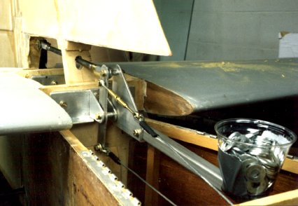

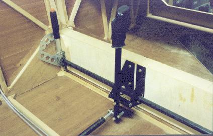

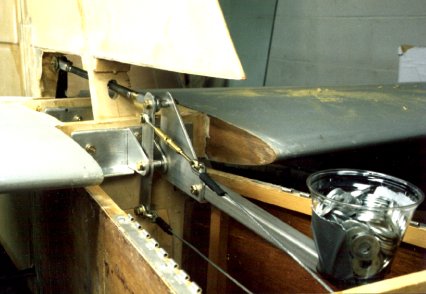

PostPosted: Sat Aug 09, 2008 5:37 pm    Post subject: Aeleron (sp?) Push Rod Question/ CH601XL Reply with quote
Also look at disances traveled between control points. You can use both in combo. Attached are some pictures showing push rod in short length to cable horn for the long travel on a KR2. Like I said both are just as good. In a b-29, yep, the Enola Gay, cables are used through out in long travel areas for controls.
Juan Vega
