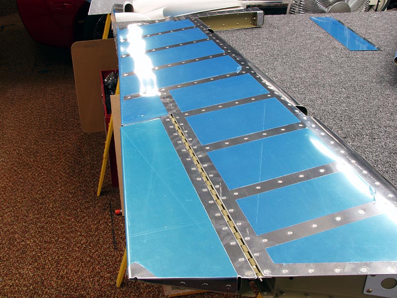

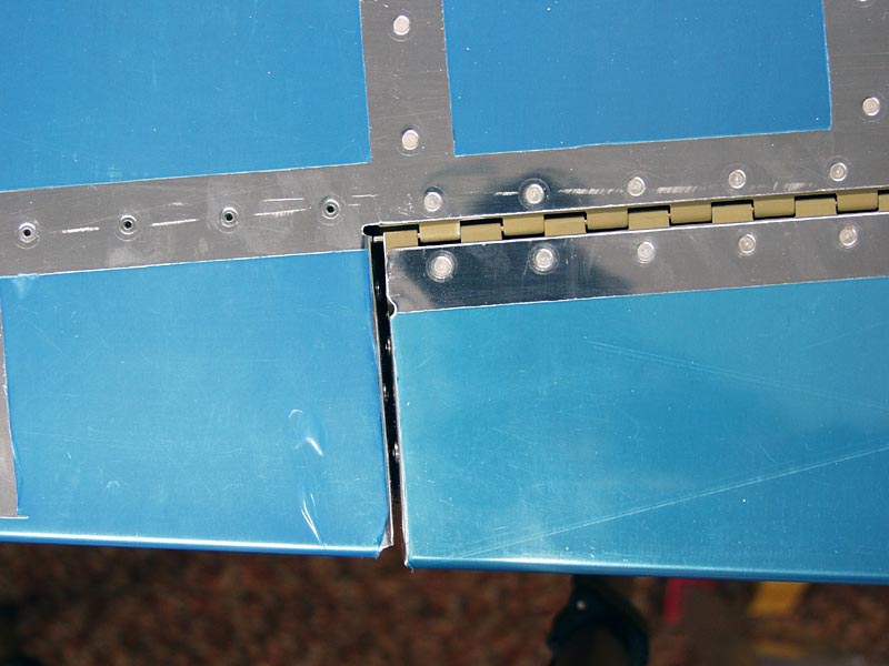

Well, the trim tab came out perfect and I'm really pleased with the
mating to the Elevator. That being said, I'm less than pleased with
the for/aft alignment of the Trim Tab. The Trim Tab hangs past the
Elevator trailing edge by about 1/8" of an inch. It is 1/8" along
the whole distance of the Trim Tab. In looking at the cause, it
appears that the skins are all cut such that you are suppose to use
the roundy part of the hinge and not the square cutout when aligning
the hinge for drilling. This would account for 1/16" on each side
and would add up to the 1/8" overhang I'm seeing. Grrrrrr....
What should I do, fellow builders? I could drill out all the rivets
and use a new hinge, and I'm certainly not opposed to that. But am I
making too big a deal out of the whole thing? Or is everyone gonna
look at it forever and go, "Hey, how come your trim take is too long?" Sad
Bummed Out in Livermore
Matt

Are you sure you've got the right size pin in there? The loops don't look
like they align right. After that, just set it aside until the end of the
project and then see how you feel about it. It's pretty minor and your F-it
factor changes over time;-)

Hey guys, thanks for all the great feedback. I think I'll just set it aside for now and fry some bigger fish, and then come back to it later and see how I feel about it. Jerry's comment about the tab never being aligned very often sitting on the ramp made some good sense. Then again, on picture day.... Smile

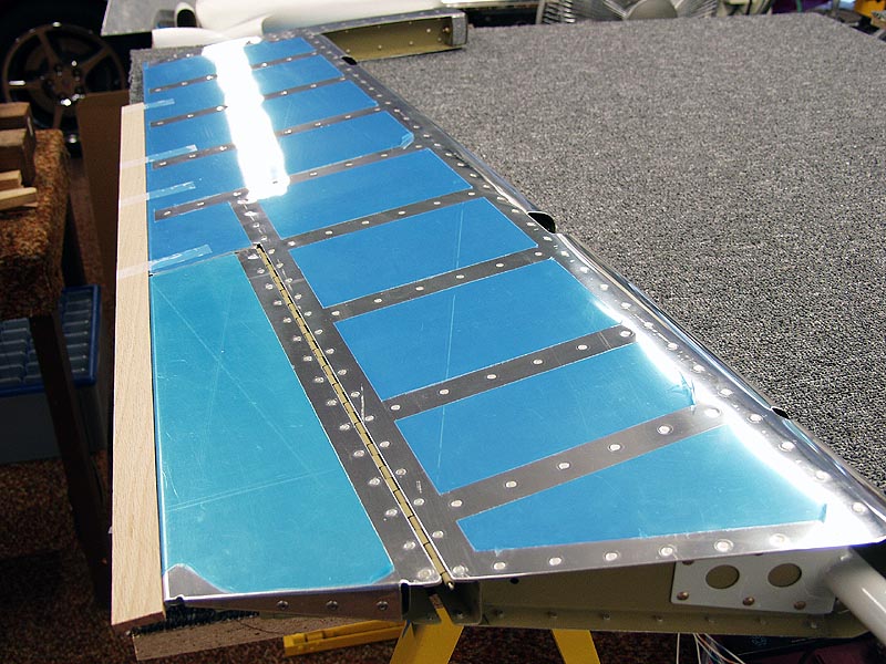

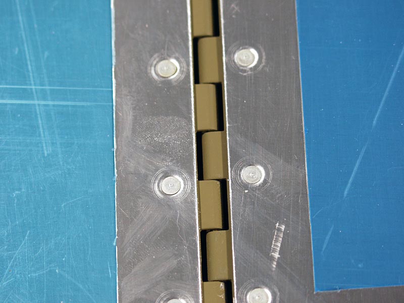

Thanks to everyone for all the great feedback on my trim tab
woes. The more I looked at the 1/8" over hang of the trim tab, the
more I couldn't stand it! So I ordered up a new hinge which came
today. Drilling out the rivets wasn't too bad. I used a nice
straight piece of wood taped to the trailing edge of the Elevator as
a reference, and then redrilled the new hinge. Attached is a
"before" and "after" shot. Ah, much better! Now I can sleep at
night. All and all it was pretty easy.

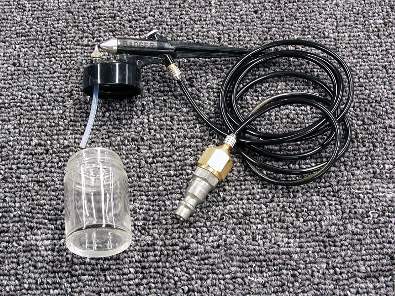

BTW, I picked up a small "air brush" by Badger this afternoon at a
local craft store call Richards. It has a little glass bulb to hold
the paint and with an adapter, hooked right up to my air
compressor. Three drinking straws full of Variprime plus three
straws full of activator was all I needed in the little air brush to
very nicely prime the two pieces of replacement hinge. Clean up was
easy and fast. Great for those "one-off" priming jobs. Just a
little tip from your Uncle Matt... Smile
