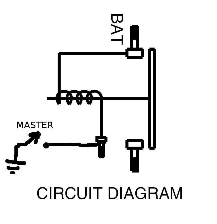

bob(at)bob-white.com Guest
Posted: Thu Aug 07, 2008 5:35 pm Post subject: relay wiring question |
Hi Jerry,
The reason is on the starter relay, the coil is activated by a positive
voltage to the small terminal and the case is grounded. It has nothing
to do with the large terminals. On the contactor, one side of the
coil is connected to one of the large terminals (BAT). The other side
is connected to ground through the master switch. If you connect the
large terminals backwards, then one side of the coil is NOT connected
to the battery and you can't activate the coil.
You have to get 12V across the coil to activate the contacts on both
devices. Look at the attached drawing and it should be easy to see why
you can't switch the large terminals on the contactor.
Bob W.

Nothing special . . . it's the factory's way of accommodating a variety
of design goals for incorporating the device into an electrical system.
I'll refer you to the 3rd and 4th pages of the .pdf catalog for
the 70 series contactors from Stancor:
http://aeroelectric.com/Mfgr_Data/Contactors/Stancor-WhiteRogers/Stancor_70-Series.pdf
Note that the 4-terminal device features no internal
coil connections. This is the style contactor I used to
offer (B&C still does) as "universal" to the task of battery
contactor, cross-feed contactor, hydraulic pump contactor,
alternator b-lead contactor, etc. In all these instances,
the little terminals and fat terminals are interchangeable.
In cases where you want to purchase a bunch of contactors
for use as a battery contactor only, then they'll be pleased
to sell you a version wherein one coil connection is tied to
a fat terminal. Obviously, one of the fat terminals needs to
be designated "BATTERY" and if you look at the contactor
shell, this terminal will be labeled "BAT" or "BATTERY".
This leaves you but one wire to hook up to the battery
master that pulls the free end of the coil to ground to
energize the contactor.
This feature can be used in a variety of applications
where "pull to ground" control is desired. Just connect
the BAT terminal to power source and the other terminal to
supply the load.
If you want to use the contactor in a "pull to bus"
situation, you can also purchase a version where one
end of the coil is internally connected to contactor
case. Now, the fat terminals are still interchangeable
but attention must be paid to the small terminal(s)
where one will be internally connected to case. This
wiring convention is quite common in intermittent
duty, starter contactors.
