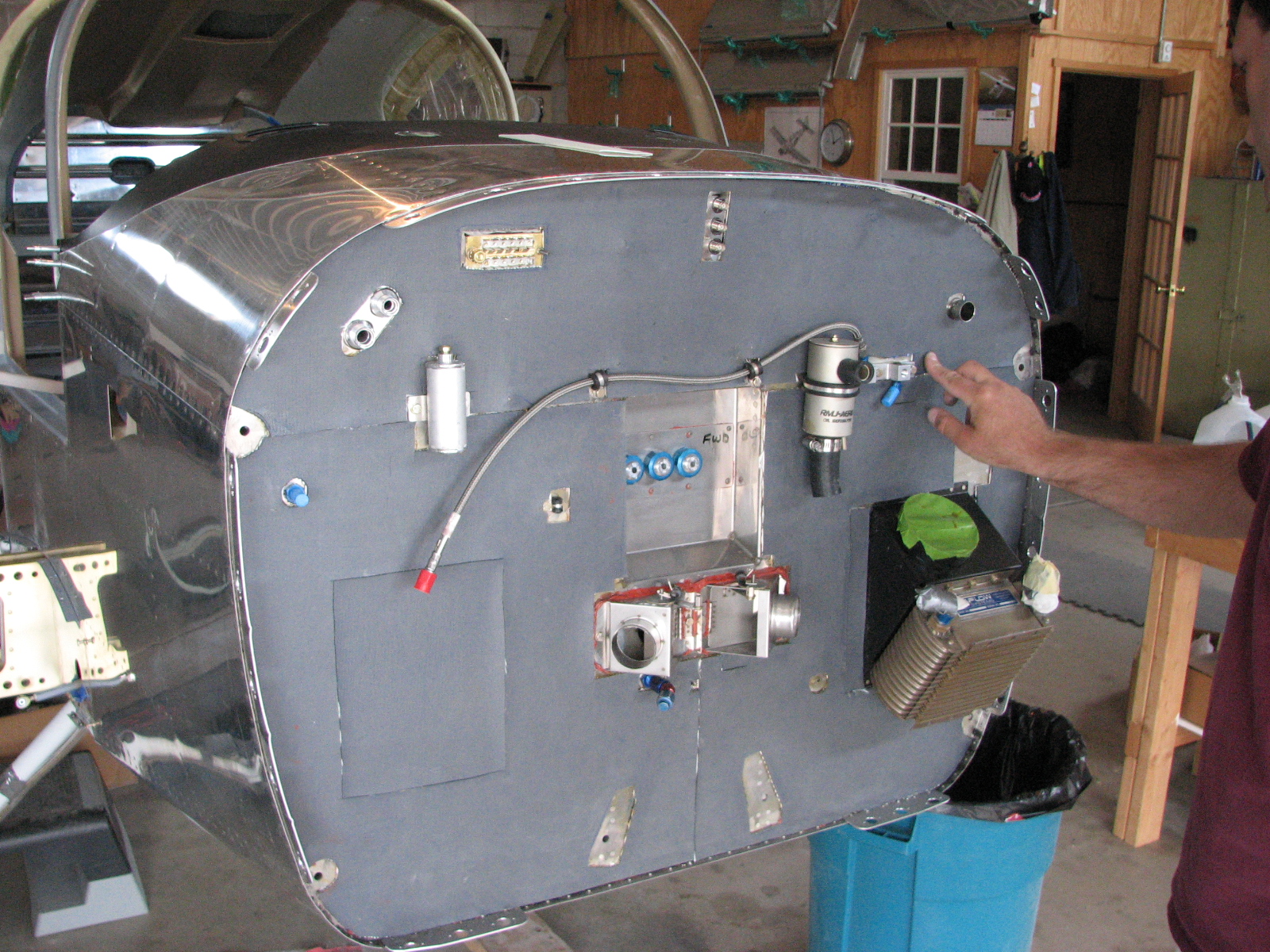

We have installed Kool Mat from Aircraft Spruce. Not flying yet, so
can't report on it. It is pretty heavy stuff, but that is probably a
good thing in our case since we have the air conditioner behind the
baggage compartment.
[IMG]
http://img504.imageshack.us/img504/1665/img1405vk3.th.jpg[/IMG]
David Maib

Sorry that photo link did not work. Hopefully this will.
 Filesize:  1.2 MB
 Viewed:  559 Time(s)
