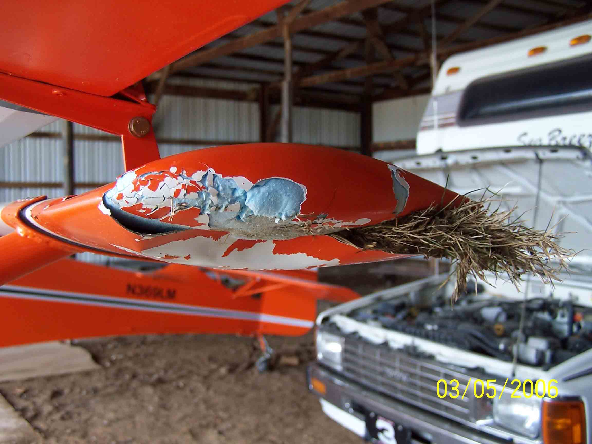

Went up last night for what was supposed to be my last lesson before getting my tailwheel endorsement. Went over to do some hard surface work, and the first two landings were squirrelly. Third landing the aircraft just darted left, with full right brake and rudder nothing would stop it. Right flaperon touched the ground and the tailwheel is cocked to the left. CFI thinks the bolt on the tail wheel broke and that is what caused it to shoot left, but I'm not sure. Landing on pavement the aircraft was really grabby. It will take some convincing before I want to go on pavement again. Need a 12 step program; loppers anonymous.
Ryan, the only time I did a ground loop was when I broke my tailwheel spring. I thought first that the ground loop broke the spring but it was the opposite: the lost of tail control was the reason I went in the ground loop.
I hope you can fix your tailwheel and flaperon and are soon back in the air.

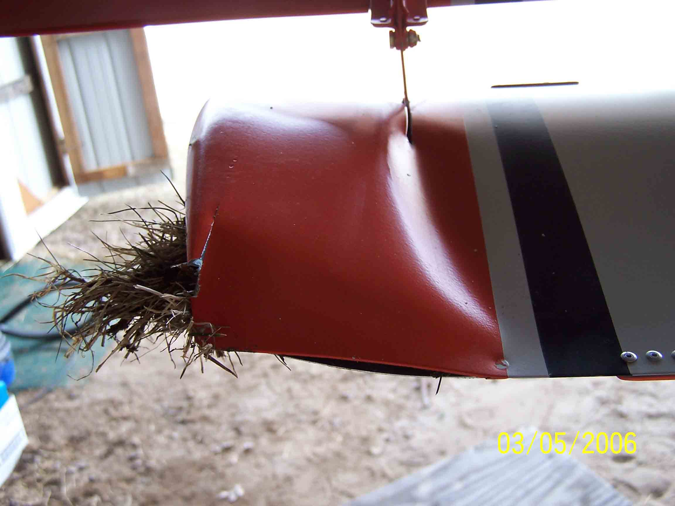

Lynn Matteson
Joined: 10 Jan 2006 Posts: 2778 Location: Grass Lake, Michigan
Posted: Wed Aug 06, 2008 9:42 am Post subject: My First Ground Loop |
Cheer up, Ryan....my attempt to teach myself to taxi ended up like
this, a week before my DAR visit...all was repairable, and it came
out looking pretty good. It wasn't a ground loop, but a side gust and
a dumb rookie who shouldn't have been doing what I was doing...going
too fast and trying to see if the tail was up (it was) and then
pulling back and probably some to the left, too.
Lynn Matteson
Kitfox IV Speedster
Jabiru 2200
Status: "Condition grounded, but determined to try." (Pink
Floyd..."Learning to Fly")
On Aug 6, 2008, at 12:31 PM, rawheels wrote:

msm_9949(at)yahoo.com Guest
Posted: Wed Aug 06, 2008 11:50 am Post subject: My First Ground Loop |
That's attractive, Lynn. I especially admire the sporty effect of those grass-like streamers.
But seriously Ryan, if you fly tailwheel long enough you will groundloop. I got mine out of the way early too and it had nothing to do with the airplane. I do concur with those who have recommended checking excessive tire pressure and/or toe-in on the tube gear. Either condition can contribute to "squirreliness" on pavement.
Good luck and keep those feet a-moving.
