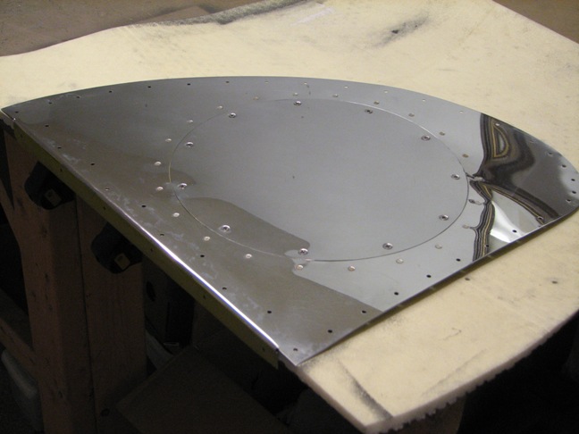

carlossa52(at)gmail.com
PostPosted: Thu Aug 07, 2008 7:25 am    Post subject: rivet squeezer Reply with quote
There are few spots where you need solid rivets, according to the plans.
But I have a couple of other applications where I definitely like the looks of solid rivets (yes, I know, more time and effort - but what do I care, it's been some 8 or 9 years already, a couple more is only 10%...).
Examples are access panels (1) to the instrument panel, from the top of the fuselage and (2) to the wing tip, to install / repair lights.
See attached photo.
Cheers
Carlos
CH601-HD (remember the HD?!), plans

psm(at)att.net
PostPosted: Thu Aug 07, 2008 8:20 am    Post subject: rivet squeezer Reply with quote
Hi Carlos,
I agree with you. Solid rivets are nice for installing nut plates in
most applications. I use the soft aluminum rivets for this ("A"
rather than "AD"). They are very easy to set with a 1 ton arbor
press or just a small hammer and steel bar for bucking.
Paul
XL nearly done.
