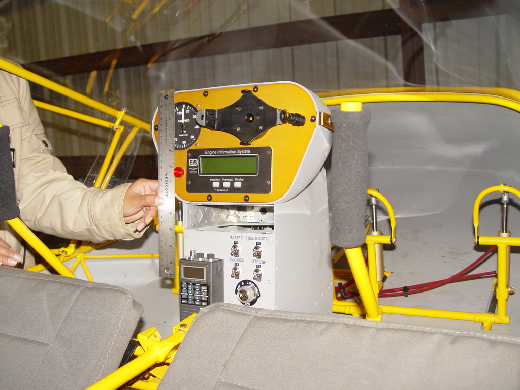

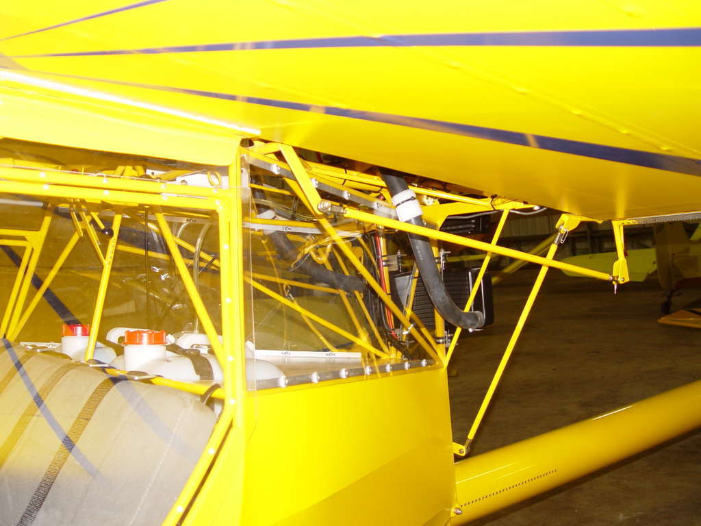

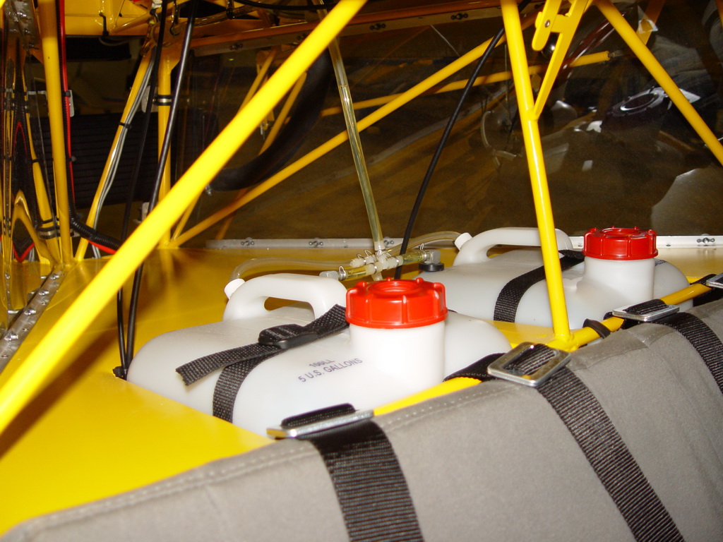

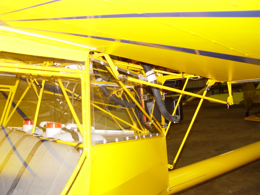

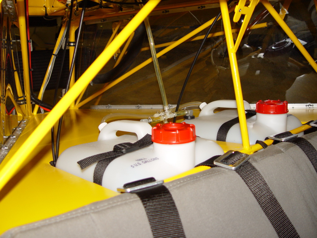

Doug,
The MK III Xtra has more than enough room for 2 people and your overnight items. The area behind the pilots heads has enough room to put a significant amount of "Stuff" , and there is a lot of room in the Nose in front of the rudder pedals. You would want to use a soft bag rather than putting a hard bag into these areas. I fly with my wife and there would be plenty of room for overnight items, or even for extended trips items if we needed. See attached pictures.
How much do you and your wife weigh together ? I have found that CG is more of a limiting factor than dead weight. You would not want to put anything heavy in the nose, but it would be perfect for coats, a couple sleeping bags, or other light but bulky items. Weight in the area behind the pilots actually helps the CG with 2 people, so heavy items should go there. These are old pictures, I am rerouted the fuel line in the picture that runs up from the tanks to access to the rear area I am talking about. For the type of flying you are talking about, the Kolb MK III is a great plane with unmatched visibility.
