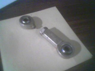

I Just had the aileron Linkeage that connects to the bottom of the Pilot side stick brake on me yesterday  in pretty windy conditions The kitfox flies pretty good without Aileron input though and I was able to fly it to the airport I was headed to and land with a slight cross wind but I was pretty busy with the rudder at times
I just thought I would post this so all of you could inspect your Linkeage before you lose your aileron controll in flight like what happened to me yesterday

Ellery, was it the rod end or the clevis bolt that failed? I just checked and see that the clevis bold will have to be removed to be inspected.

Whoa, Ellery. Major pucker factor! Can you post a pic of the broken linkage?

It was the Threaded part of the rod end that broke in the threads
Ellery

I will get a pic of the broken Link the next time I go to the airport and post it
Ellery

PostPosted: Mon Jul 28, 2008 2:35 pm    Post subject: Kitfox-List:Losing Aileron Controll in Flight Reply with quote
Here is a Pic of the aileron control linkage that failed I hope this will save someone else from having the same experience I had
Ellery in Maine

PostPosted: Mon Jul 28, 2008 7:02 pm    Post subject: Re: Kitfox-List:Losing Aileron Controll in Flight Reply with quote
Ellery in Maine
Ellery, I would say either that rod end was defective or due to that particular installation it cannot rotate as the stick is moved to the extreme left and right.
There is essentially no shear force on any of the Kitfox control rods or on their rod ends. At least on my Classic 4 that is the case. They all just push and pull.
At preflight inspection I move the control stick to each extreme and twist the control rods at that position to see that they will rotate back and forth just a little to be sure no binding is taking place.
Tom Jones

PostPosted: Mon Jul 28, 2008 7:30 pm    Post subject: Re: Kitfox-List:Losing Aileron Controll in Flight Reply with quote
That very rod end assy failed on my Kitfox III just as the wheels were coming off the ground. I feel the reason mine failed is that I tightened the clevis bolt too much not allowing the rod end to move freely thus binding it and bending the threaded part till it broke. Now on preflight I always check to make sure it moves freely.
The rod end is readily available at bearing parts houses the P/N is right on the rod end its self.

PostPosted: Mon Jul 28, 2008 7:39 pm    Post subject: Kitfox-List:Losing Aileron Controll in Flight Reply with quote
Good work Ellery. Saved your life. I do hope you'll post pictures and some analysis. I think this area is similar in all birds so I'd love to know what to look for.
Guy Buchanan
San Diego, CA
K-IV 1200 / 582-C / Warp / 100% done, thanks mostly to Bob Ducar. [quote][b]

ElleryWeld(at)aol.com
PostPosted: Mon Jul 28, 2008 7:43 pm    Post subject: Kitfox-List:Losing Aileron Controll in Flight Reply with quote
I never noticed any binding in these controlls myself but the bolt has been cracked for a while according to the looks of the broken area but was not visible with out a microscope being in the threaded area
But I was wondering why does that have a jam nut on it if I screw the new one together without that jam nut it can not come apart after I get both bolts through the rod ends and it will be able to swivel on the threads if needed But I am going to look at this area better another day when the new parts get here
I don't have the building plans on this so I am not sure what it has for details on this connection so any advice would be great from someone else with plans
Ellery in Maine

PostPosted: Mon Jul 28, 2008 8:21 pm    Post subject: Kitfox-List:Losing Aileron Controll in Flight Reply with quote
Ellery
The jam nut prevents the rod end rocking on the threads, if the jam nut is not in place the threads will fatigue with the consistent rocking motion. Just adjust and lock so that the components are not binding.
Gary

PostPosted: Fri Aug 01, 2008 9:34 am    Post subject: Kitfox-List:Losing Aileron Controll in Flight Reply with quote
When you post a pic, be sure to tell us exactly which part of the rod
end, and at what point in the linkage....is this the short male-to-
female rod end combo right at the end of the aileron control torque
tube?
Lynn Matteson
Kitfox IV Speedster
Jabiru 2200
Status: flying w/557+ hrs
Ellery
In a message dated 7/27/2008 10:55:45 A.M. Eastern Daylight Time,
nahsikhs(at)elltel.net writes:
inspected.
Good Job on landing with no aileron control.
Tom Jones
Classic IV
Ellensburg, WA
http://forums.matronics.com/viewtopic.php?p=195196#195196
